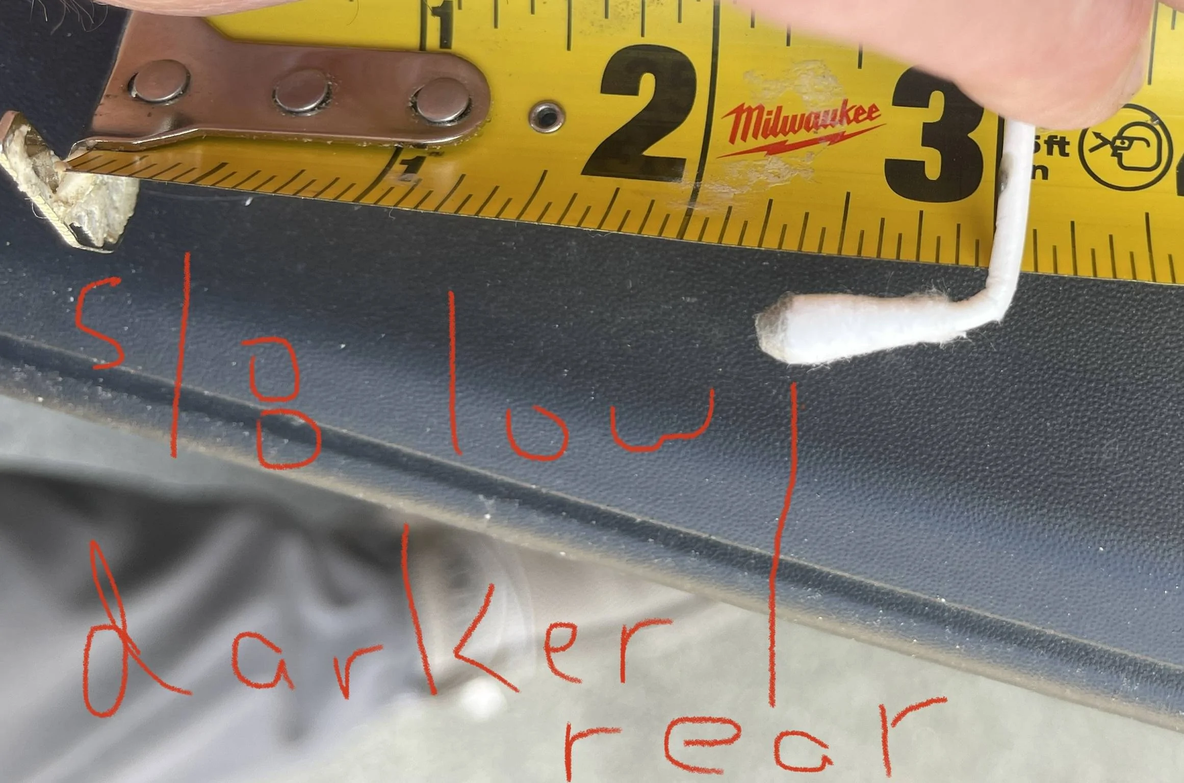

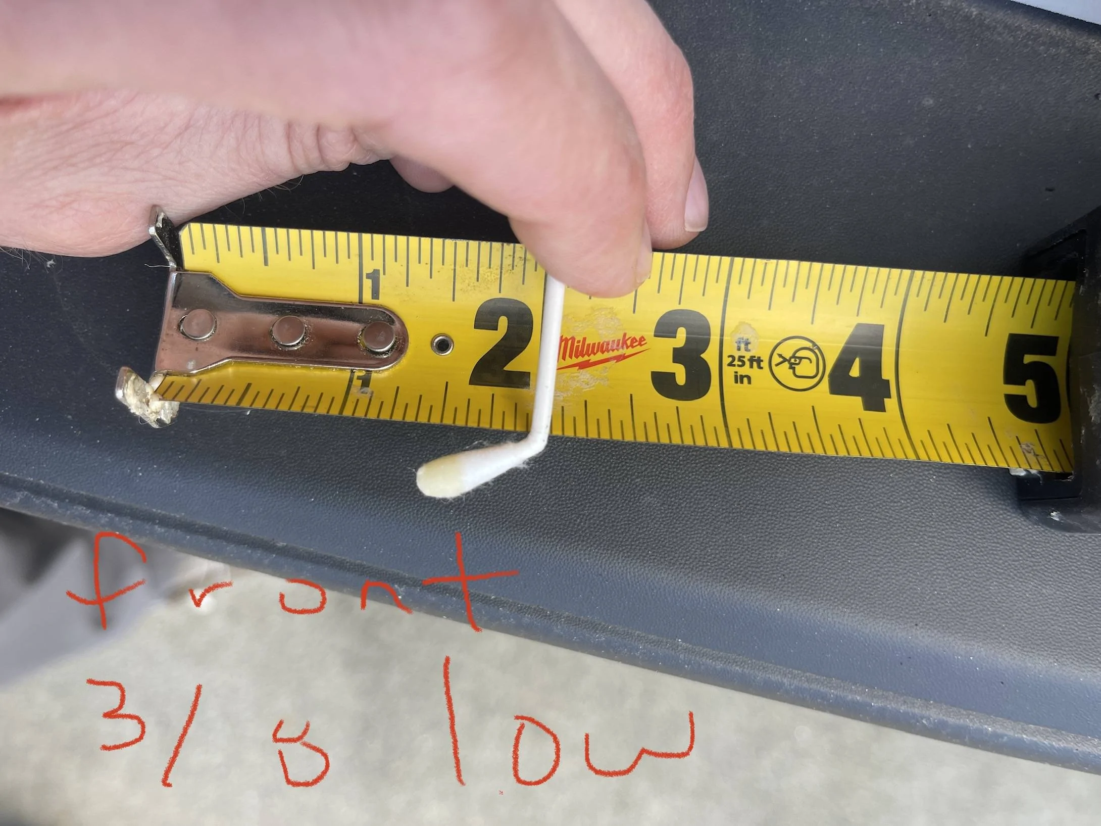

Almost 3000 miles and wanted to check my fluid levels. Rear was a little lower than the front as you can see in the pictures. Should I too them up or is this plenty?

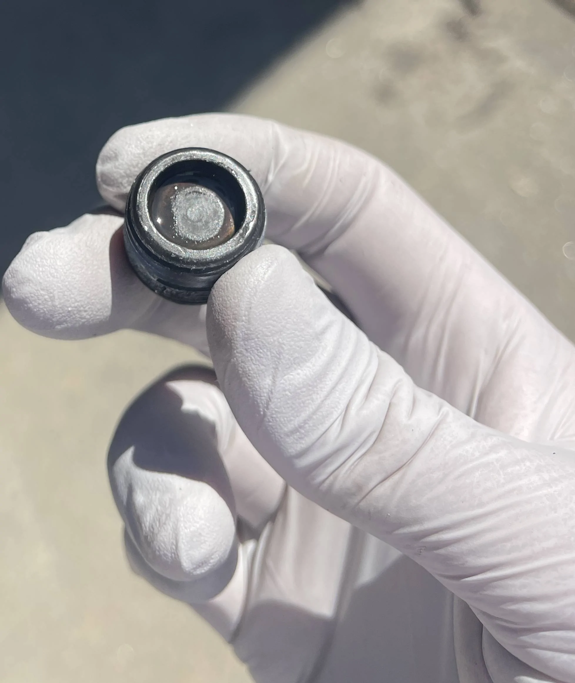

also, shouldn’t the rear plug have a magnet?

If you can stick your little finger in the fill hole and bend it down at the first joint and touch fluid, it's fine. Don't "top it off" - those Q-tips look about like the same distance as the first joint in my finger which is roughly 1"
They are fine.

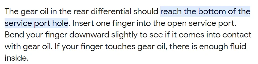

For a change and refill, "up to" bottom of fill plug hole. For a check to see if it's low, where he's at is fine.
For decades, the finger test has been sort of like a dipstick - there's a full and a low.
He's between.
The ring gear tosses the fluid up and it travels through cast-in passages to where it needs to be.
Here's a description I found elsewhere - (I was too lazy to go get one of my service books LOL)

Yep, stuck the q-tips in exactly like they are bent, as a feeler guage of sorts.... And the worst was the rear. About 5/8 below the hole. Fluid did not seem as "oily" as motor oil IMO.
Also, should I go and get a plug with a magnet in it?

Magnets need to be low. A fill plug won't help so you'd need to pull the drain plug if it has one and install magnetic drain plug.
Not a big need as metals settle to the bottom anyway but if u want one wait until u do a drain and refill and do it then.
Millions of differentials out there with no magnets and doing fine.
One school of thought is that if it needs a magnet to collect stuff, it's already too late.
