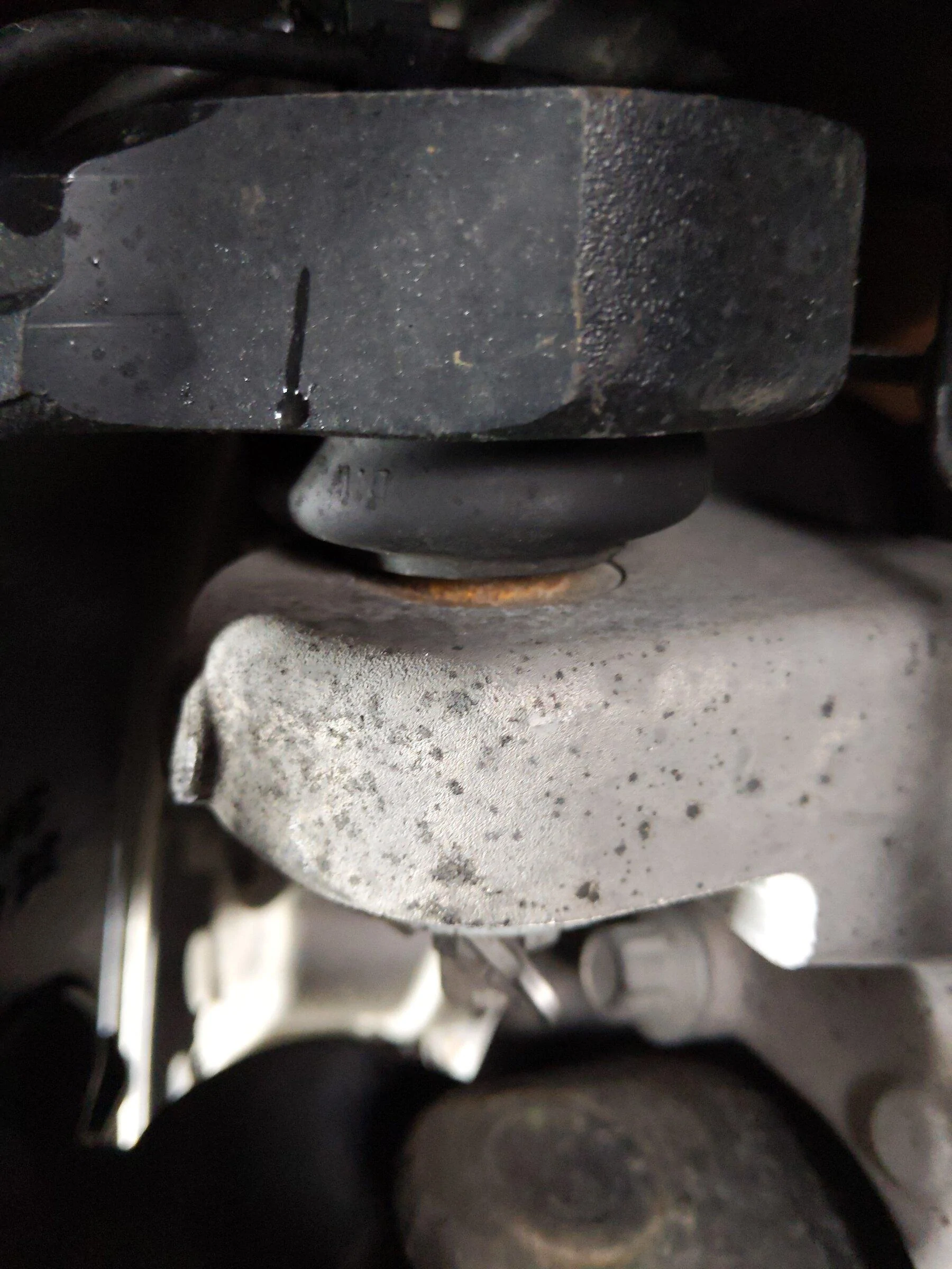

Trying to track down an annoying graunching noise when I go over tiny bumps (like expansion joints) but not over larger bumps.

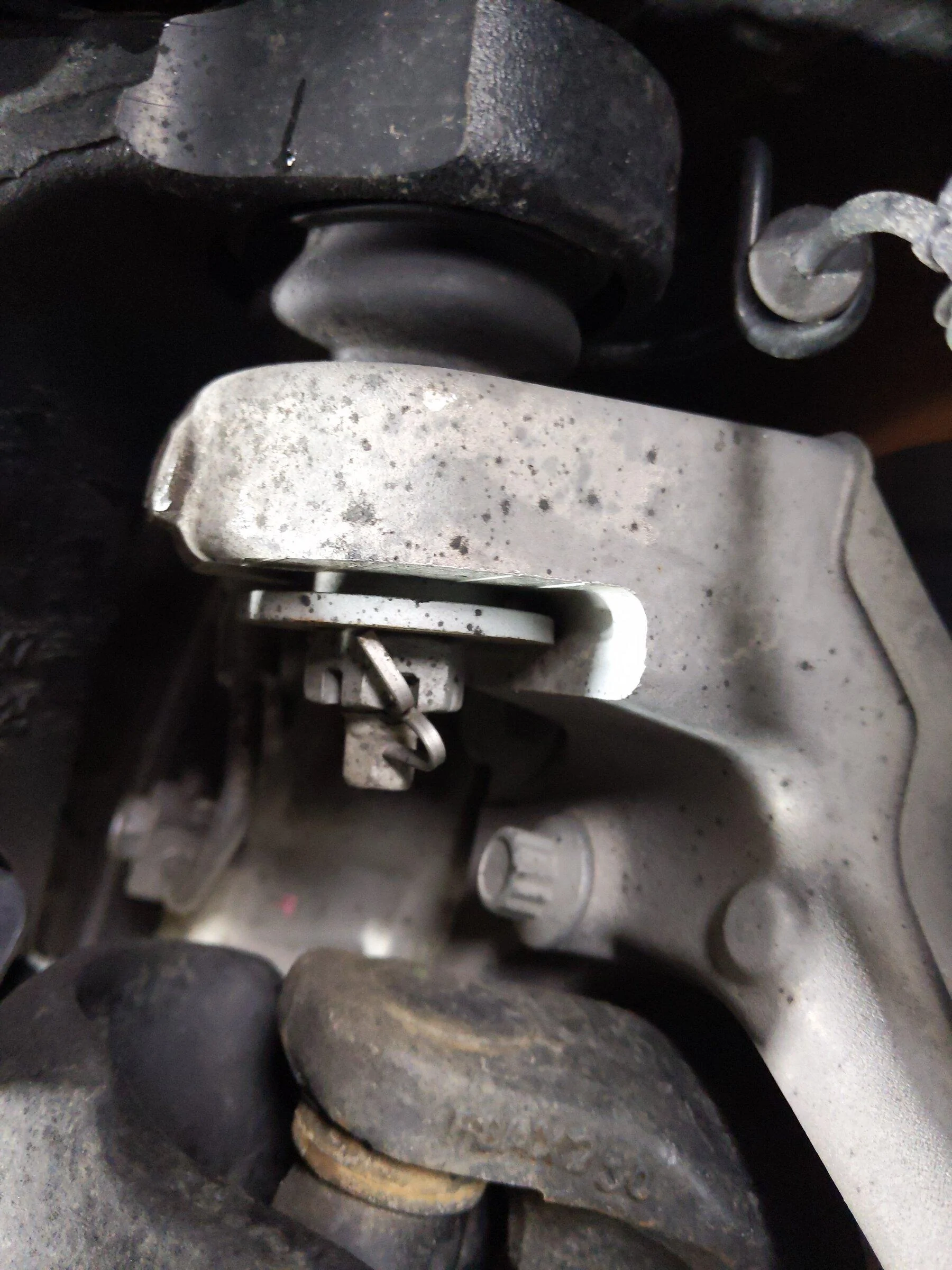

Under the truck and going over bushings etc. and the upper ball joints just don't look quite right to me. Almost like they're not seated. Both are identical. Lowers look "normal". On the uppers it almost looks like the joint isn't pressed into the knuckle fully - should that "flange" be seated down on the knuckle? And then where the stud of the ball joint passes through the top part of the knuckle, there seems to be a.small gap that looks like the BJ could be drawn in further. Forgive me, I'm used to older stuff. Maybe this is how "new" ball joints look?
Hopefully those pictures work. Thanks!

Does it lift up and down within the socket?
You can pull that cotter pin out and try torqueing it. I think it's 70lbs but you can find the specs online.

I think he's more referring to the gap between the washer and the knuckle vs it being bad internally.

Mine are the same, so it's probably normal. The gap at the bottom (where the nut is) looks like there is some sort of spacer, it is wider than the top shaft. That might be what is holding the washer away from the knuckle.
Ok thanks. I assumed since both mine were the same and I have no drivability issues other than the noise, it was fine but I just wanted to check. Thank you!

Not really. I've done dozens of sets of BJs and just never had them look like this. The noise I have is definitely not a balljoint noise, this is just something I happened to notice while I was under there scrounging around.

At 2:08 in that video his upper ball joint seems to look exactly like what the OP's does after guy said he torqued things down.

Might have to tighten the castle nut. They become lose over time. It solved my issues with a squeaking.
