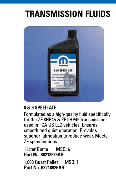

is this the right oil?

This PN is for my 2021 JT Mojave:
68218925AB FLUID, Automatic TransmissionChrysler List Price: $36.00
Ask your local dealer for a discount and see how close they can get to the total cost of Ebay.
I have a warranty that goes until 100k and I dont want to clue the dealer in that i am doing anything they could use against me IF i find something when I send in an oil sample.
I can probably call a random dealer and just ask a parts guy what part number the fluid is.
