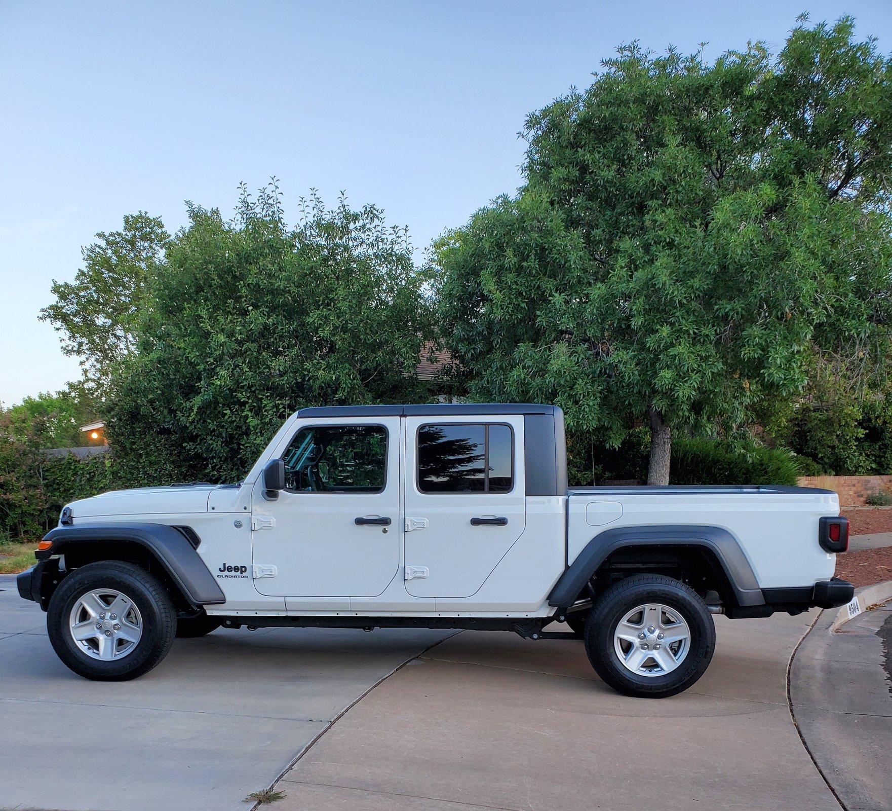

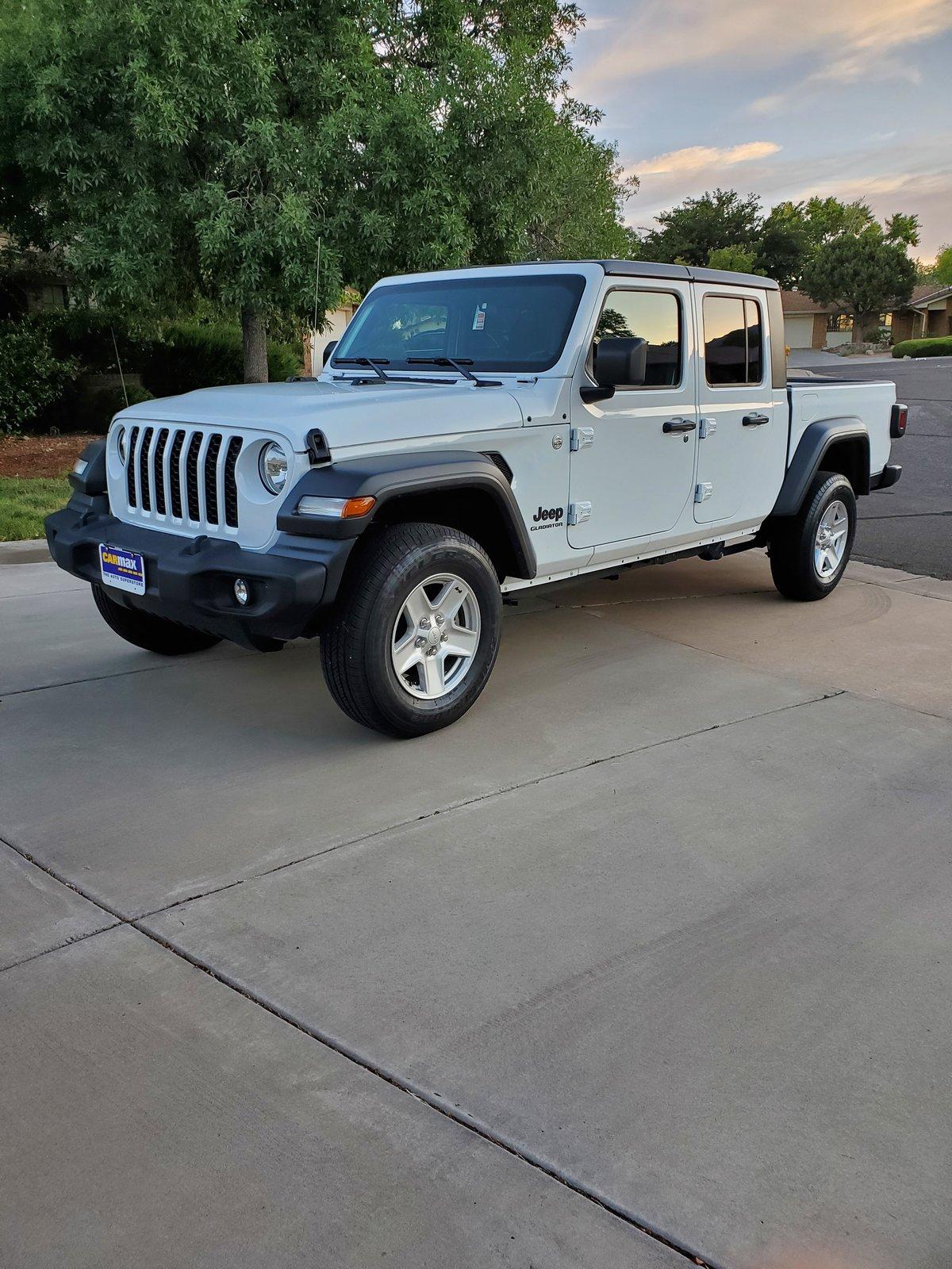

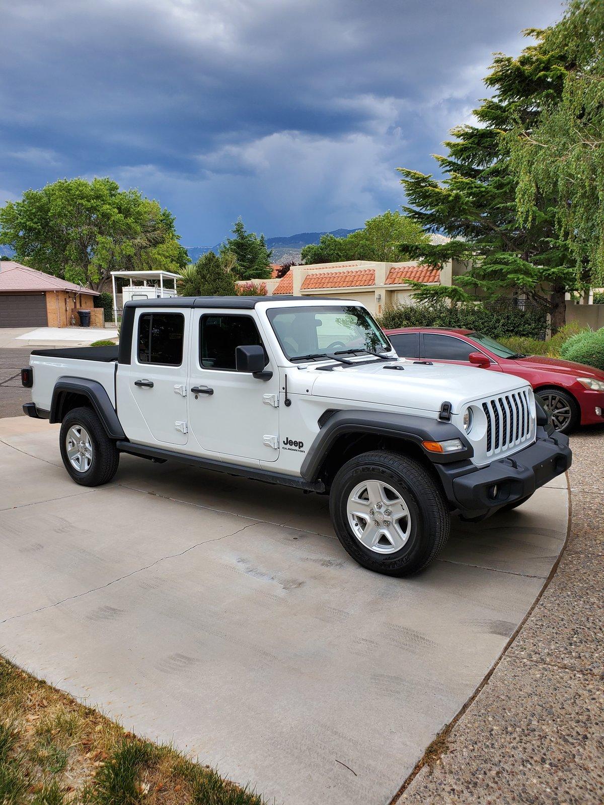

This is my first Jeep and my first vehicle of any sort that I bought with the intent to modify. We'll see how it goes. The utility the Gladiator offered was just what I'd been looking for, and so I have started down the path of building the Oreo Fishwagon.
Purposes:
1. Daily driver
2. Weekend warrior chariot
3. Get to remote fishing locations
4. Explore NM while I'm still here
5. Dog hauler
6. Truck stuff - haul yard waste, move furniture, etc.
7. Learn as much about working on vehicles as possible
I purchased the truck used with 400 miles on it. I'll probably make a post or two about my experiences actually completing a purchase which was significantly more difficult than I expected it to be. It's a White Sport S (non-max tow, unfortunately), so I'll be building it in a white-black color scheme as much as possible.

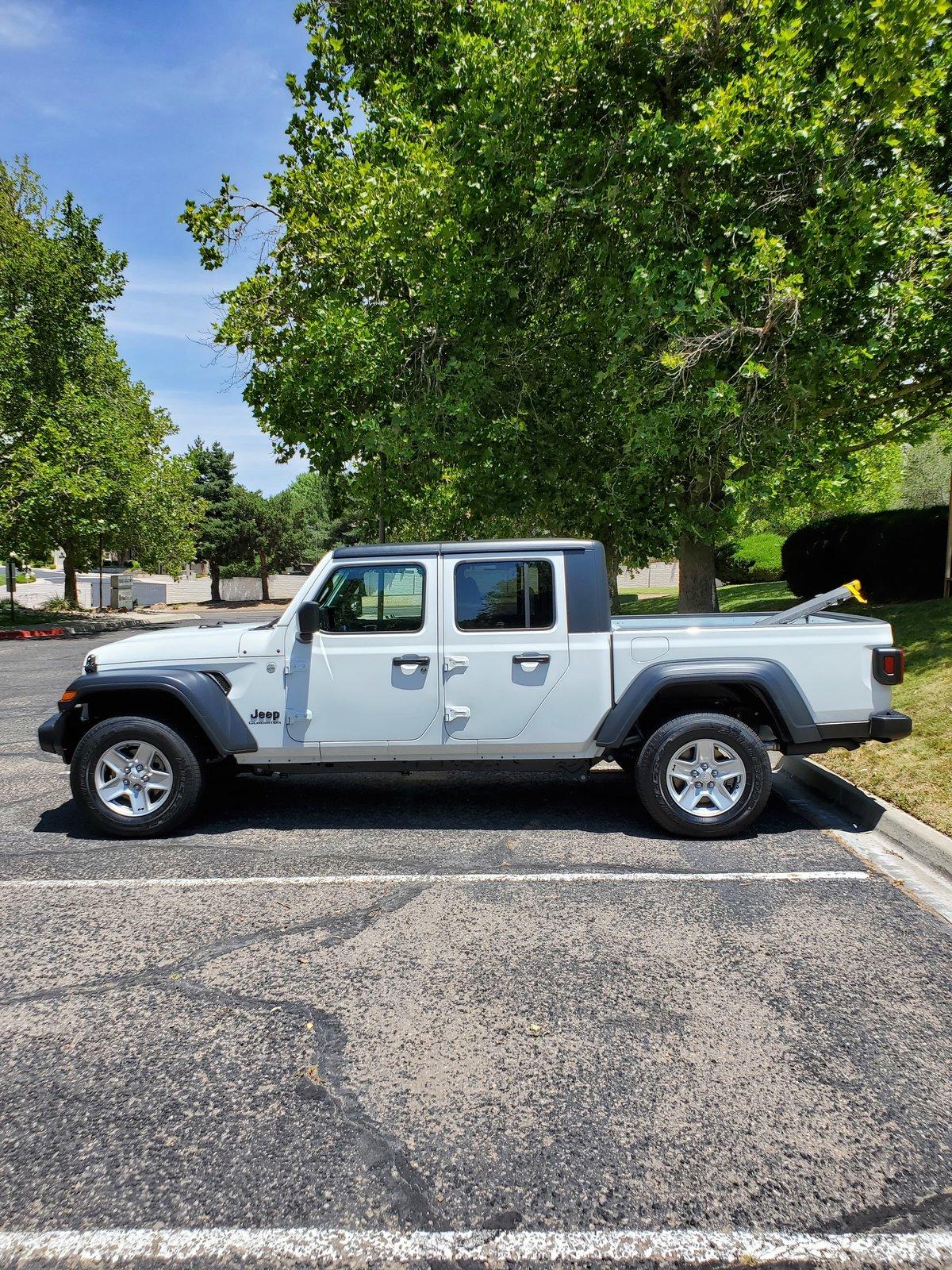

Rock Rails
Purchased as a Rubi take-off from a local member. The rails came with the many small pinch bolts, but I needed to get 8 body bolts and washers (M8, I think) from Lowes. At this point in the build, I had not yet ordered torque wrenches from Tekton, so on my list of things to do is figure out what the torque specs for the rails are and tighten up to specs if needed. Easy addition.

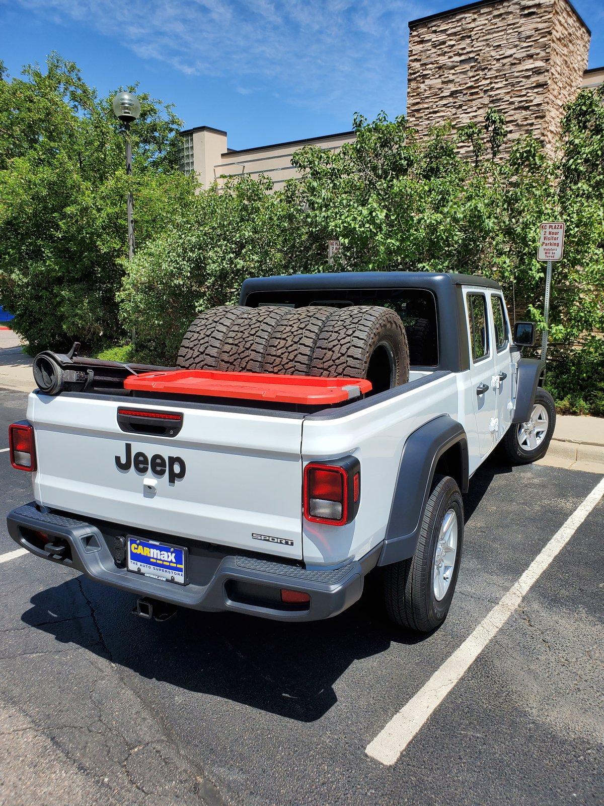

Roll-up Tonneau

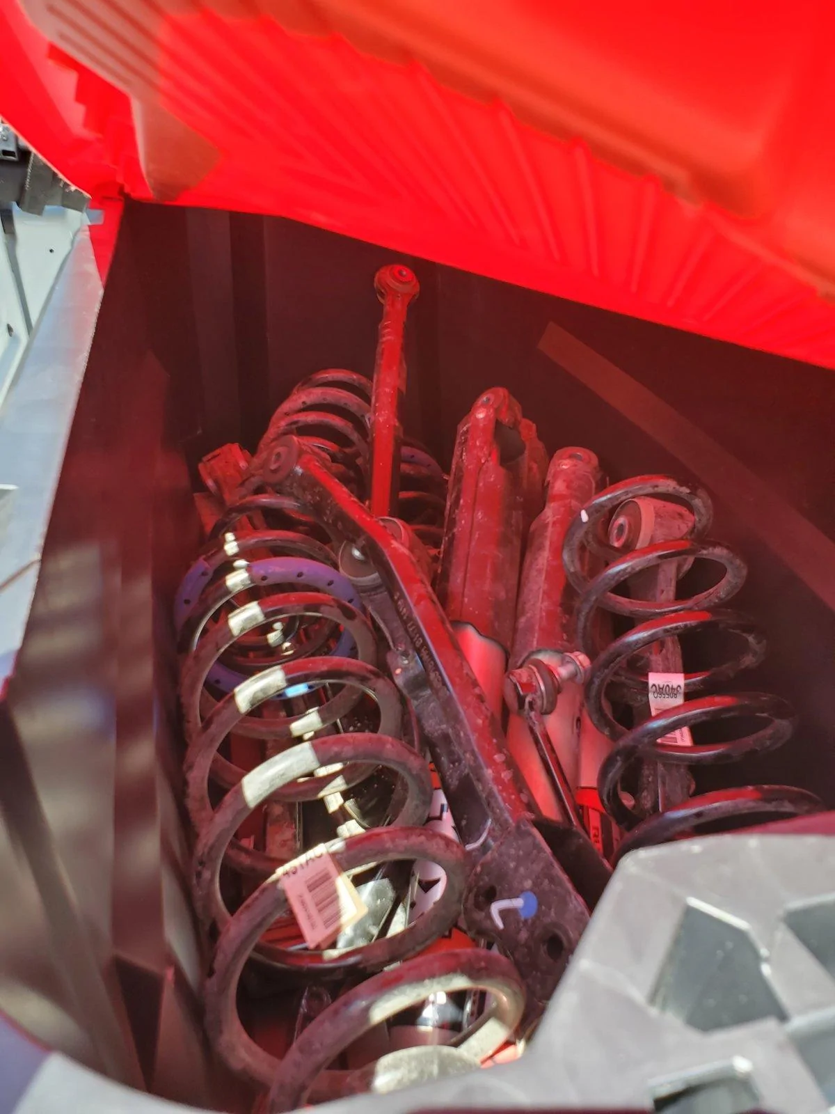

Took a trip to Denver to buy Rubi suspension takeoffs and a tonneau cover. Needed to buy some torx bits. Bought a large "mechanics" set of Kobalt tools for $200. Ratchets, sockets, and bits. Hoping this will cover most situations. Almost stripped one of the torx bolts using too small a torx bit. Once I got the right tool for the job, it was another easy install.

Denver Pick-up
Jeep Gladiator Isle_of_Man Build 20200711_135619
Jeep Gladiator Isle_of_Man Build 20200711_135718
Before
Jeep Gladiator Isle_of_Man Build 20200710_124708
After
Jeep Gladiator Isle_of_Man Build 20200716_182015

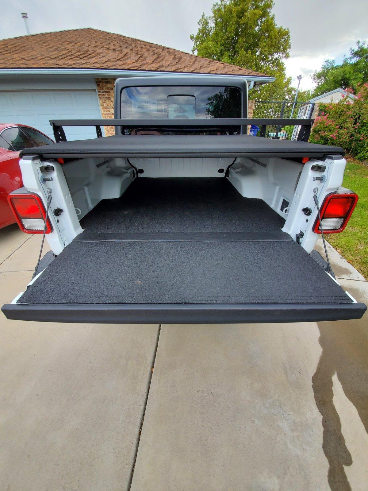

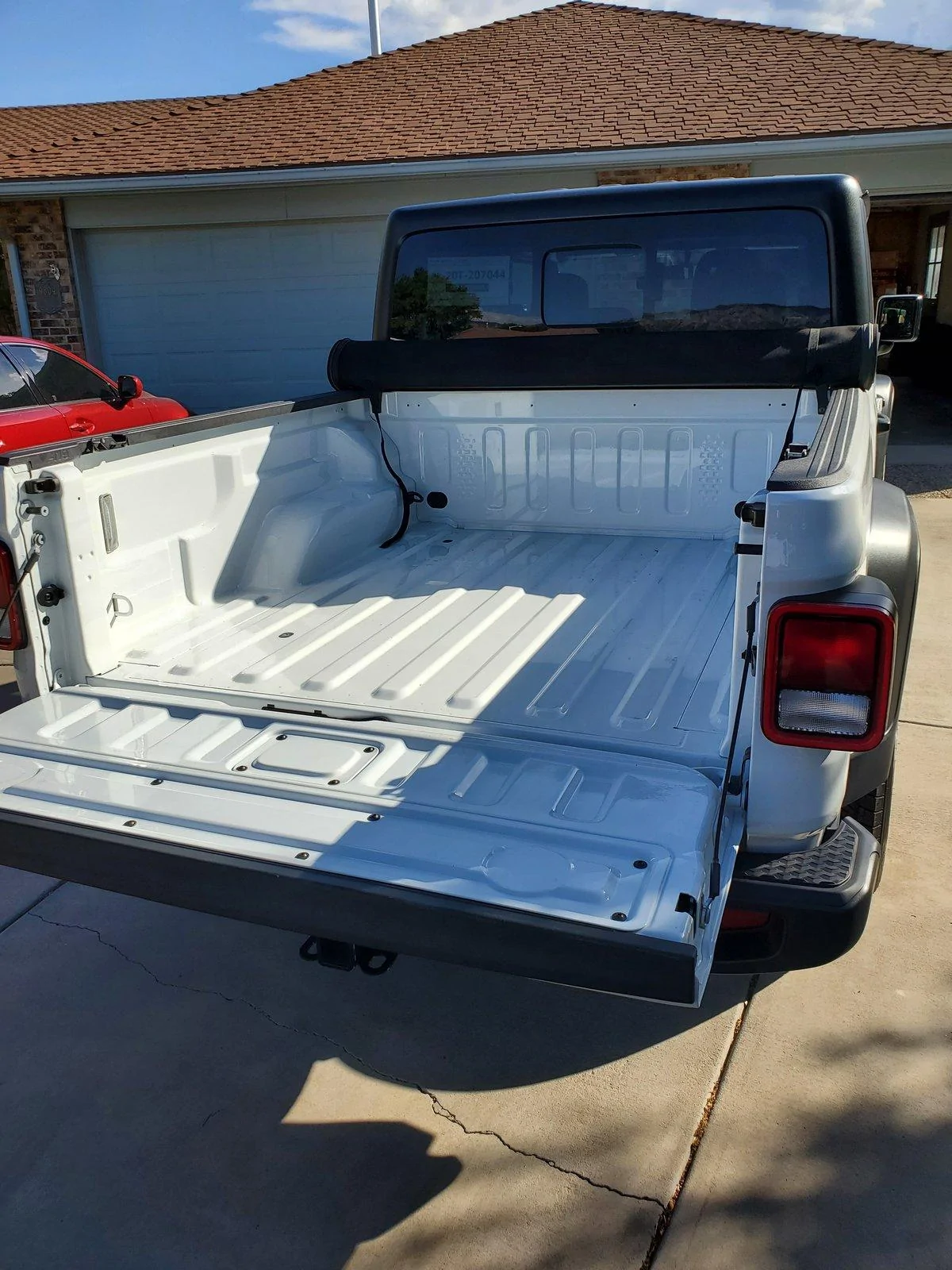

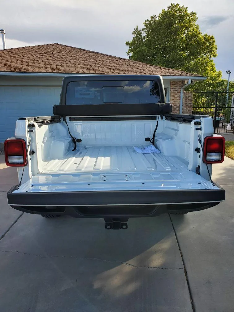

OEM Bed Rails
I decided to try the KB Voodoo rails as a foundation for a rooftop tent, bikes, skis, etc. I also wanted some additional tie down points for the bed, so ordering the OEM rails made sense. Easy install.
Before
Jeep Gladiator Isle_of_Man Build 20200717_173303
After
Jeep Gladiator Isle_of_Man Build Resized_20200717_180842(1)

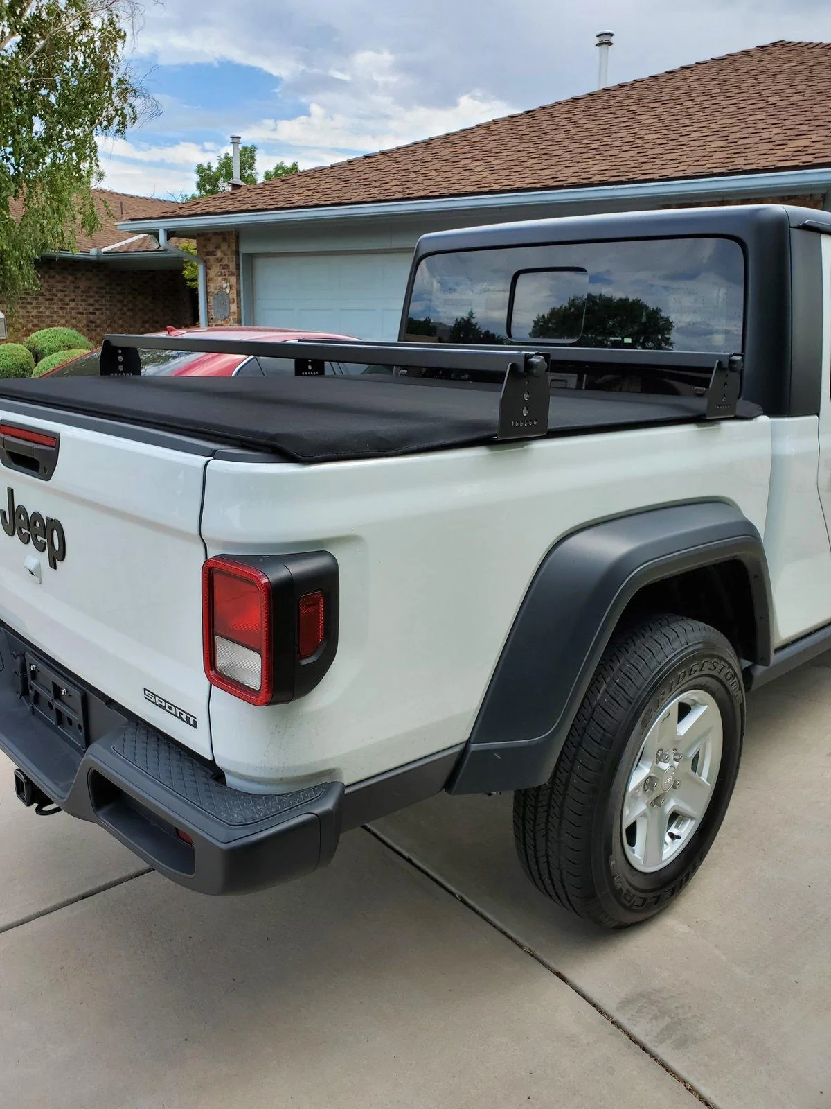

KB Voodoo Uprights and Crossbars
These work with the OEM roll-up tonneau cover. So far no leaking, but the tonneau isn't sitting down as far as it did. Weather stripping might be needed at some point. I may adjust the uprights further towards the tailgate to make it easy to sneak the tonneau under the first crossbar. In camping situations I don't think I'll need to completely roll up the tonneau. Field testing is necessary (if they would actually open some camp grounds in NM). I got the knobs for quick removal of crossbars so I can haul bigger stuff without too much tear down energy. The crossbars are really easy to remove and re-attach. Adding a RTT will likely complicate things quite a bit. I need to figure out a storage solution when the RTT is off the truck. Comes with T-brackets to attach into the bed rails. Each bed rail is rated for 250 lbs, and I went with the steel KB Voodoo option rather than the aluminum to be able to take advantage of a 500 lb capacity. I wanted to get a third crossbar that would attach to the front bed rail for another 250 lbs of capacity, but they don't make one that fits on that rail. Long term project is to figure out how to mod one of the crossbars to take advantage of the third rail and reclaim the full capacity of the OEM rails.
Jeep Gladiator Isle_of_Man Build 20200807_162754

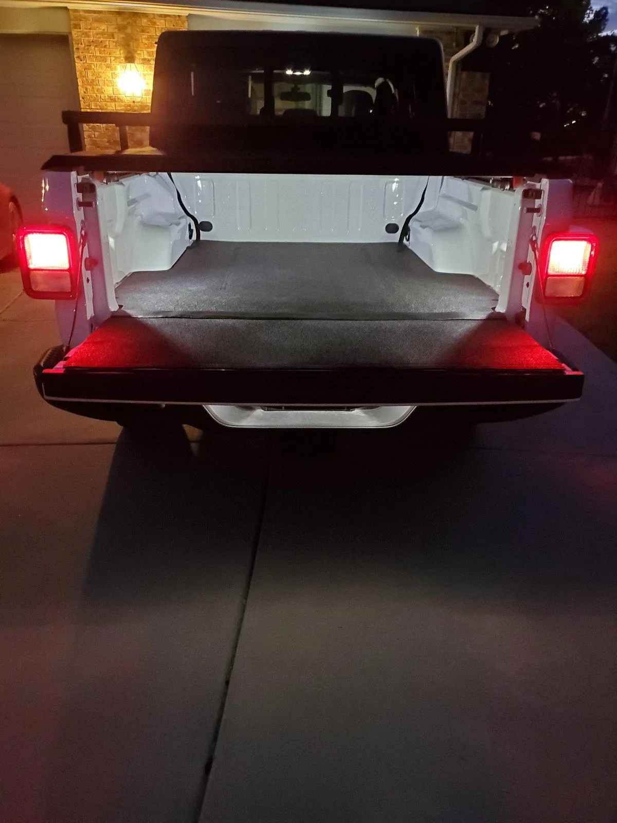

Bedrug Impact Mat
Initially the plan was to use a third party to line the bed. But I liked the white and black possibility on the inside of the bed, so for the time being am happy with the Impact Mat. I went with the impact mat over the regular bedrug because it looked more black in the pictures and I couldn't tell many other differences. This took a long time to arrive, but was also an easy install (I needed to use some preciously hoarded rubbing alcohol for this project). The impact mat arrived rolled up and needed to be left in the sun to flatten out. I immediately discovered that the thing gets effin hot in the sun, so maybe that's a difference between the impact mat and the bedrug. Regardless, I'll almost always have the tonneau cover on so it's not a big problem. The bed portion of the mat laid completely flat but I couldn't ever get the tailgate portion to be flat. As installed it has a little bit of wave. Not a huge deal, but noticing it made me question whether my love for this Jeep was causing unhealthy levels of OCD.
