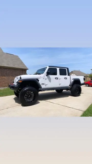

really? I sometimes think the 3.5inch I have for my 38x13.5x17 looks too tall.
Here some, looks pretty darn good to me. Rough country recommends 37 12.5 18 tires for the 6 inch lift though

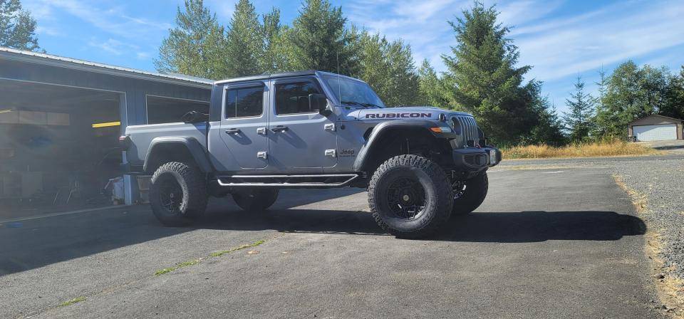

Hello Gladiator community. I am hoping some (or many) of you can offer some insight into the ride quality of my Gladiator.
I recently purchased a used 2021 Gladiator Rubicon. The previous owner installed 24x14 wheels wrapped in 37x14.5R24 rubber and a rough country 6" lift. I am not sure what else has been done, but I do not see any other modifications visually.
My dilemma is that this Gladiator is ALL over the road while driving above 45 mph and it feels very unsafe at 60mph. I have to constantly steer and correct while driving in a straight line and just don't feel like this is normal. I have watched dozens of videos and spoke to several people and am told the following:
A) Don't worry about it, all Jeeps drive like this.
B) Having wheels/tires that size will always cause those driving issues.
C) A 6" rough country lift will cause those issues.
D) The stock aluminum steering box is the culprit.
I took it in to the dealer to have the stock aluminum steering box replace with the all steel unit, however they refused to do the work citing that they cannot properly align it after the box replacement due to the size/offset of the wheels/tires. That said, I purchased the steer smart sector shaft brace in the hopes it would suffice. Although the issue has improved, it still feels awkward and dangerous at highway speeds.
My question is, has anyone else encountered this and can provide a list of things to check and/or fix? Do Jeep's naturally wander? Do I need to downsize the wheels and offset? Is there possibly and underlying issue not related to tires and lift? Any help is greatly appreciated.
I come from a long line of sports cars, but I do not have any experience with lifted trucks of any sort, so I welcome the communities feedback!
Thank you.
Jeep Gladiator Issue with ride quality on 24x14 wheels paired with 6" lift base_20220821_162710

As stated, I purchased this Gladiator as is, only thing I have done is add a hitch step and the Steer Smarts sector shaft brace. I am not and never was a fan of the Gladiator as it sits OEM on the lots. The OEM wheels/tires are too anemic for its boxy look, so I never considered it as a potential purchase. However, when I saw this one on the lot, it changed my mind as it looked good from all angles. (Beauty is in the eye of the beholder and I get it, everyone has different tastes). A quick search of Google and Youtube will show plenty of Gladiators on 24x14 wheels, so I had no reason to believe it would be an issue. After driving it around for a few months, I have come to learn that this Gladiator has sacrificed useability for looks, which brought me here to see how much I would need to correct to have a useable Gladiator for my needs. It seems like a fix is possible by reducing the amount of negative offset, the width and height of the wheels, and a few changes to the suspension.
Time and money will tell me if this is possible. If not, I will sell the Gladiator and move on because I have no interest in driving a vehicle too close in looks as all the other ones on the road. Go big or go home right?
