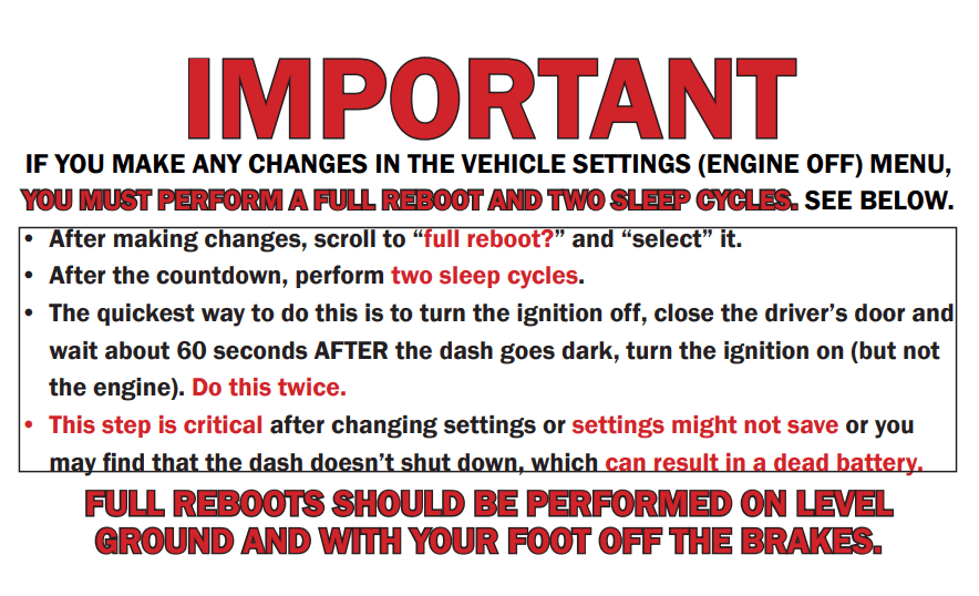

Did you guys do the two sleep/wake cycles? Anytime any settings didn't work out for me it was because I forgot to do that part.

I'm not sure what he did. He did the install and initial set up when we regeared and did tires a few months back. How would i go about doing that process?
If you made any changes in the setup menu, be sure to scroll to “full reboot?” and “select” it. This step is critical after changing settings, or you may find that the dash doesn’t shut down, which can result in a dead battery.
Some settings require two sleep/wake cycles. The quickest way to do this is to turn the ignition off, leave the car, close the driver’s door and walk away with the key. Wait about 60 seconds AFTER the dash goes dark, then re-enter. Do this twice.
