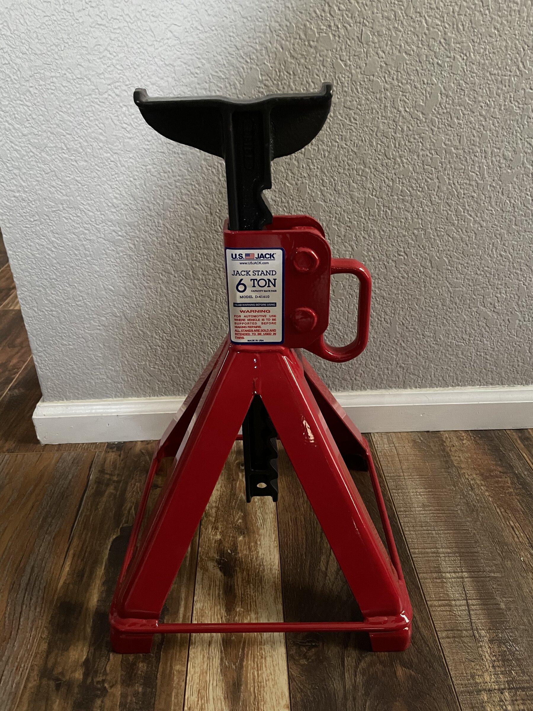

I searched here and on the internet but can’t get a solid answer. I want to install the AEV spacer lift. Where do I Jack from in the front and rear? Admittedly I have not looked under the Jeep yet, was just wondering if there was an approved location.

i jack from anywhere on the frame
Thanks. I watched a video and it seems everyone is using the differential housing. It has to be raised evenly so I can install stands.

In the rear, the differential is dead center, jack it up there, put jack stands in, lower.
The front you'll have to play around to find center. OR, if a neighbor has a floor jack you can borrow, then use two floor jacks.

Jack under the pumpkin(s), throw the floor jacks under the frame and get er dun!

I use a Hydraulic floor jack and have always jacked from the differentials. I then secure the Jeep on jack stands on the frame. I will typically also leave the jack under the differential (Barely touching), as another safety option/backup.

Thanks, yeah even the owners manual says to lift by axle tubes. Raising it up though to 18-20” I’d feel nervous jacking one side at a time. I have stands I plan on putting under the frame once it’s up high enough.
I even got really good ones and supported America 🇺🇸
