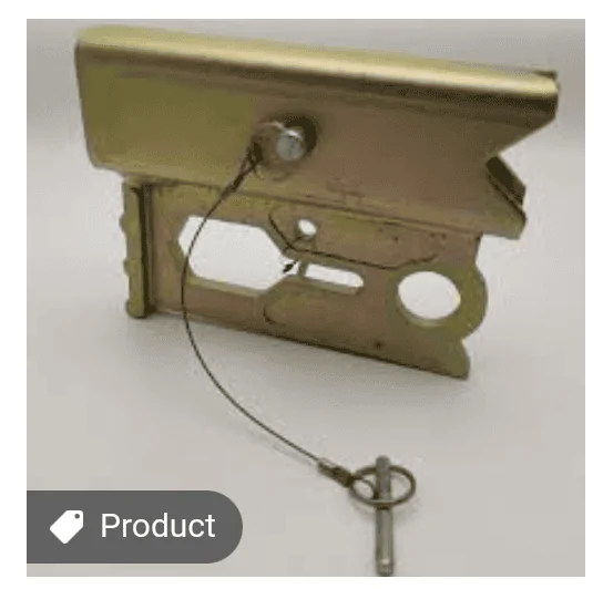

or do something like this with some tubes welded in for the insert.
http://pronghorngear.com/product/hi-lift-shackle/

Great read on the Rubi forum. Like that pronghorn recovery shackle. I think I could get one set up straight off the bumper shackle point.

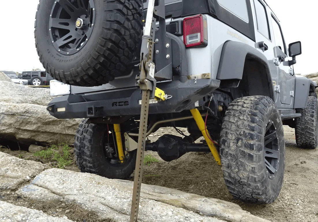

If you have stock bumpers I don't think any spot is solid enough to use a Hi-lift jack on other than the receiver hitch. But that's not good to lift by. If you have after market bumpers with shackles you can lift with them, that's what I have done on my LJ and XJ or the rock rails I have on them. I agree with Texanjeeper that stock Rubicon rock rails might not be up to it.

High Lift jacks are not meant for jacking up the rig. They are intended to be used as a recovery device. Sure you can adapt them for jacking with adapters, but do you really want to do that? They are probably the most unsafe thing that has ever been sold?
Get a bottle jack for lifting the truck for tire changes and for getting off that rock the you are stuck on.
