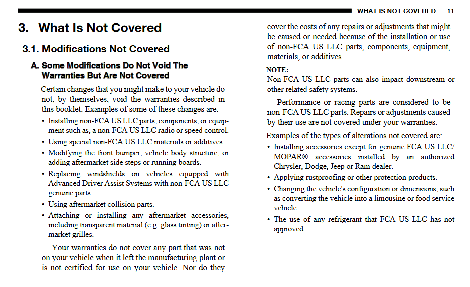

The next most pertinent part is the following.
Interesting to note is I can't find anything, including for "downstream effects", that says adding larger tires affects the warranty. So, if there's no lift, larger tires should, in my non-professional opinion, not void warranty on parts listed above or even unlisted parts covered by the Basic Factory Warranty such as ball joints. Of course, there's always a risk that a dealership will fight covering something under warranty.
