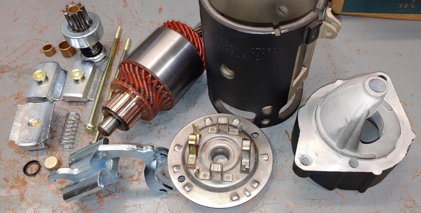

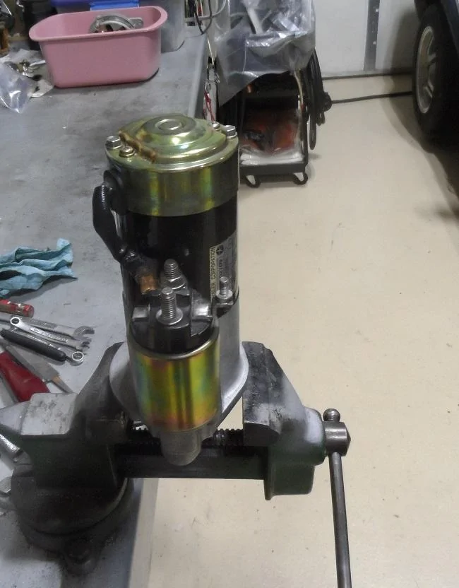

Isn't it crazy how starters have progressed over the years - I mean, the direct-drive Ford 4 1/2" for an I-6 (in process of restoring) and then this other I restored for my own SX4's 4.0 from a 94 ZJ and then to today's starters....
Both of these are for similar size engines!
Yeah, the 3.6 starter will last just as long if not longer even with more cycles.
The ZJ starter had way over 100,000 miles before the BRUSHES wore down. I restored it but the only part that needed to be replaced - the brushes. All else was fine. Even the commutator didn't take much to turn and even it up.
