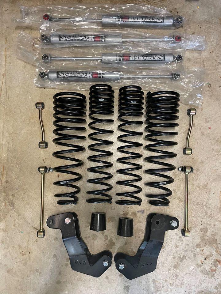

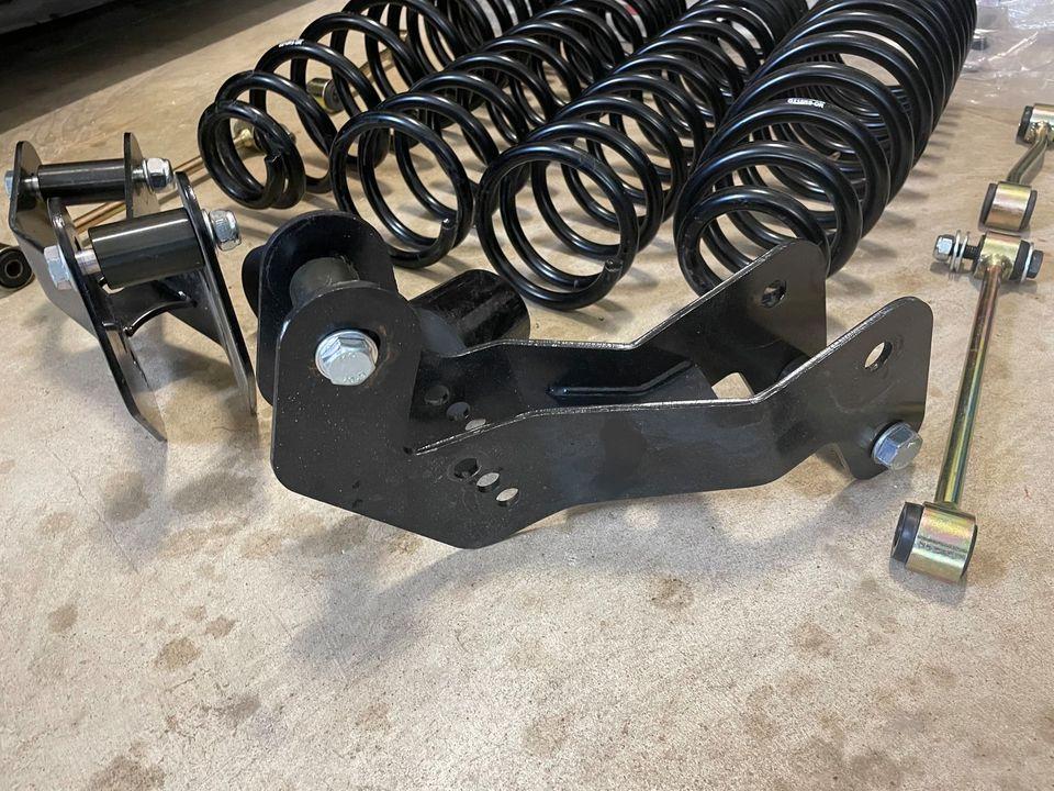

Jeep Gladiator JT Skyjacker 2.5” Front/ 1.5” Rear Long Travel Coil Spring Lift Kit with M95 Monotube Shocks. Skyjacker Part # SJ-G251PMLT. Lift was installed on my Gladiator for approximately 500 miles. Decided to switch to a more complete kit and different lift height. Picture of the black truck is with this kit installed. Gave 41” front fender to ground and 42” rear fender to ground with 35’s and plenty of room left for 37’s. Rancho geometry correction brackets for sale with the kit to correct caster and reduce bump steer - these are a MUST imo. All components fully bolt on and all parts included.
LIFT with GEOMETRY BRACKETS: $500

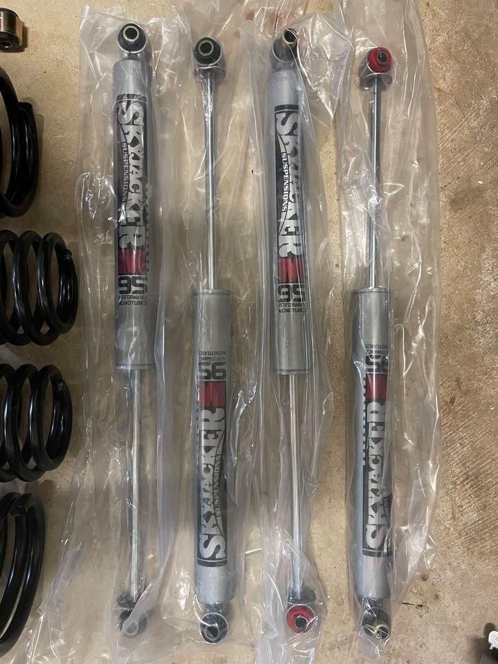

Here are the links to the shocks that come with the kit
Front: https://skyjacker.com/shop/jeep/wrangler-jl/m9386-m95-performance-monotube-shock-absorber/
Rear: https://skyjacker.com/shop/jeep/gladiator-jt/m9396-m95-performance-monotube-shock-absorber/

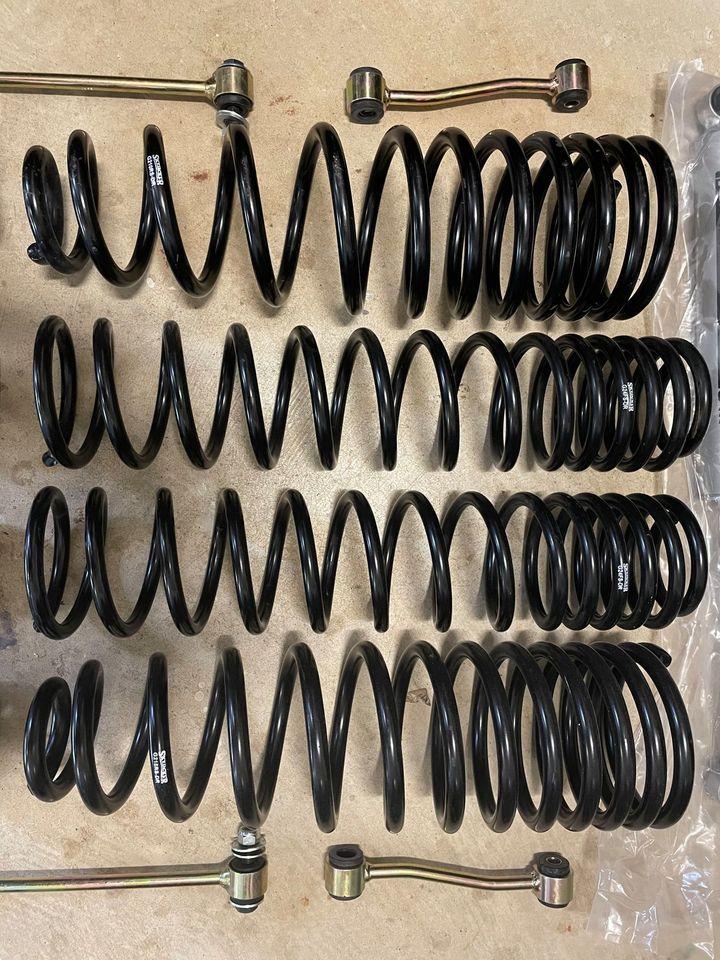

Also, the spring rates are 142/93 front, and I think 150/360ish (not 100% sure exact specs on rea but its close to this) - very similar to the teraflex rates.

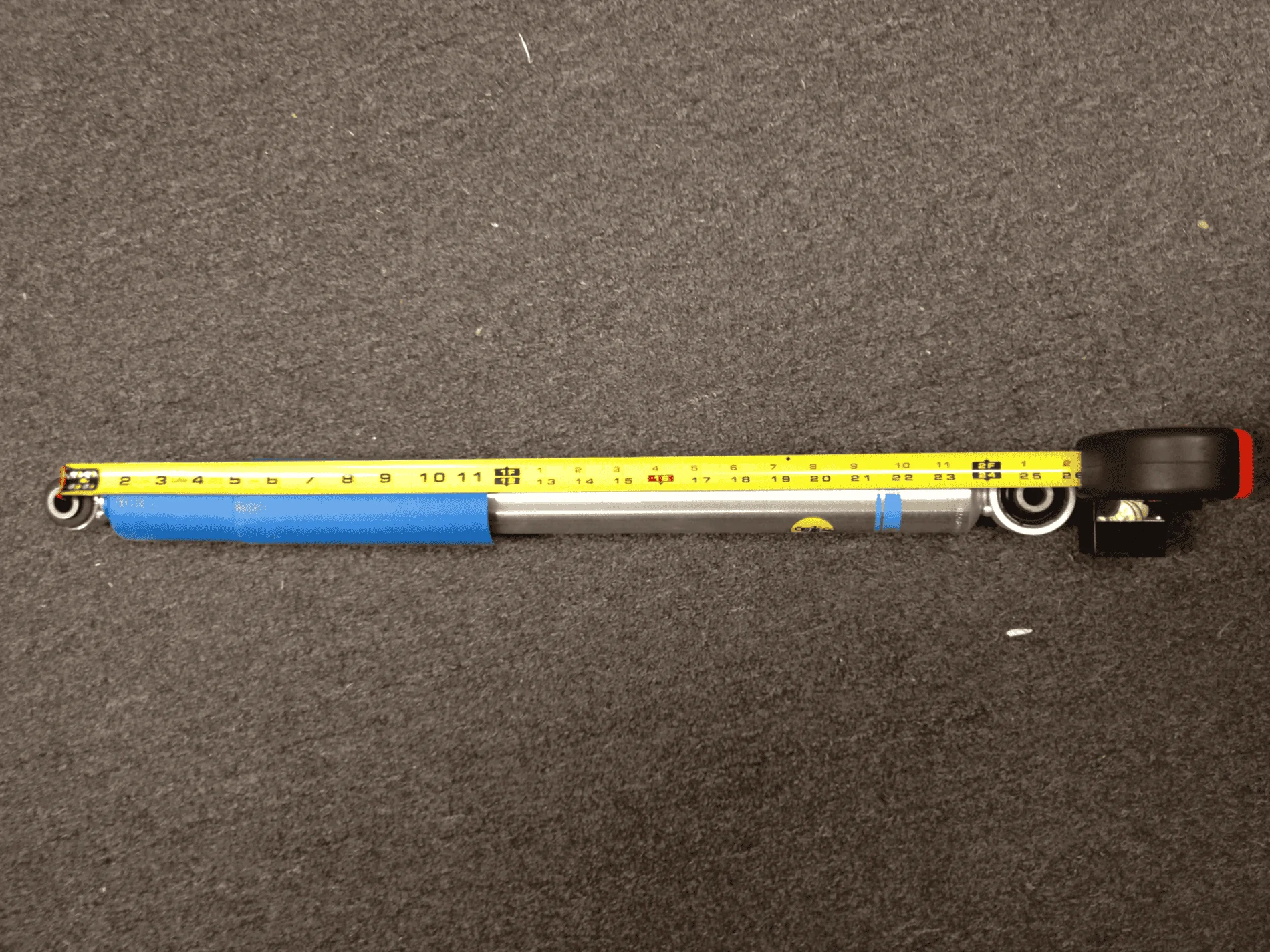

yeah im not sure skyjacker doesn't list the shock lengths
Also this is the way of measuring i was talking about for the front and rear shocks,except i just want the extended length since i dont want you forcing the shocks down to measure since i bet those things are hard to push down

Center to center is around 27.25” on both. Skyjacker website states:
Notes
Collapsed Length16.16
Extended Length27.19
