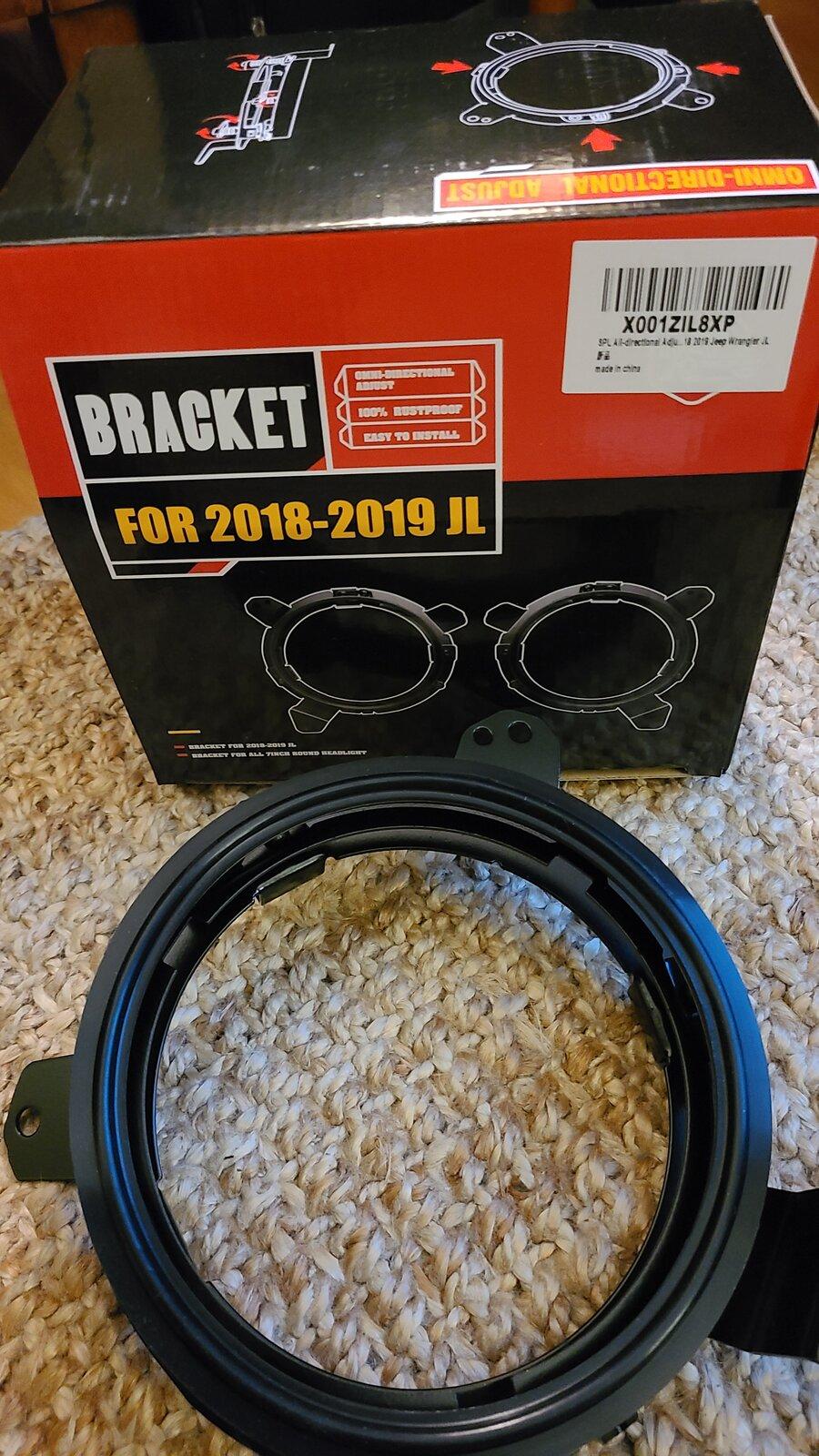

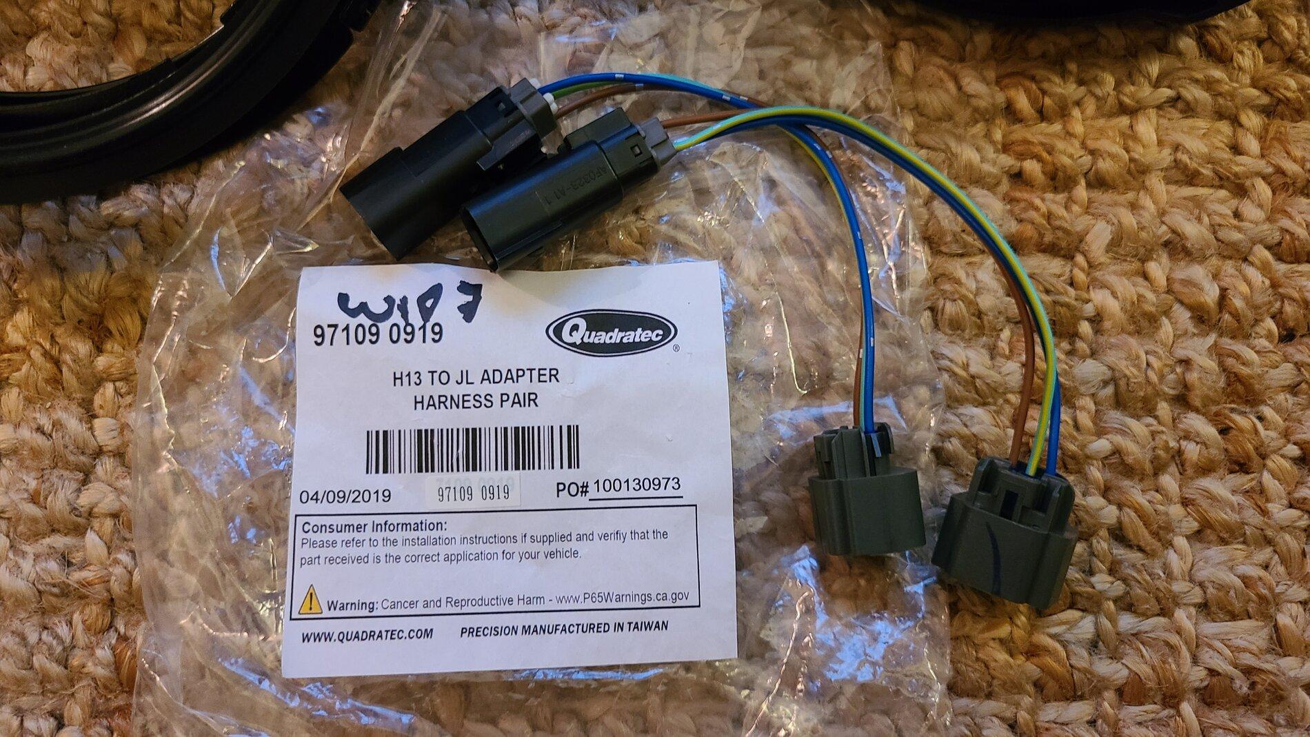

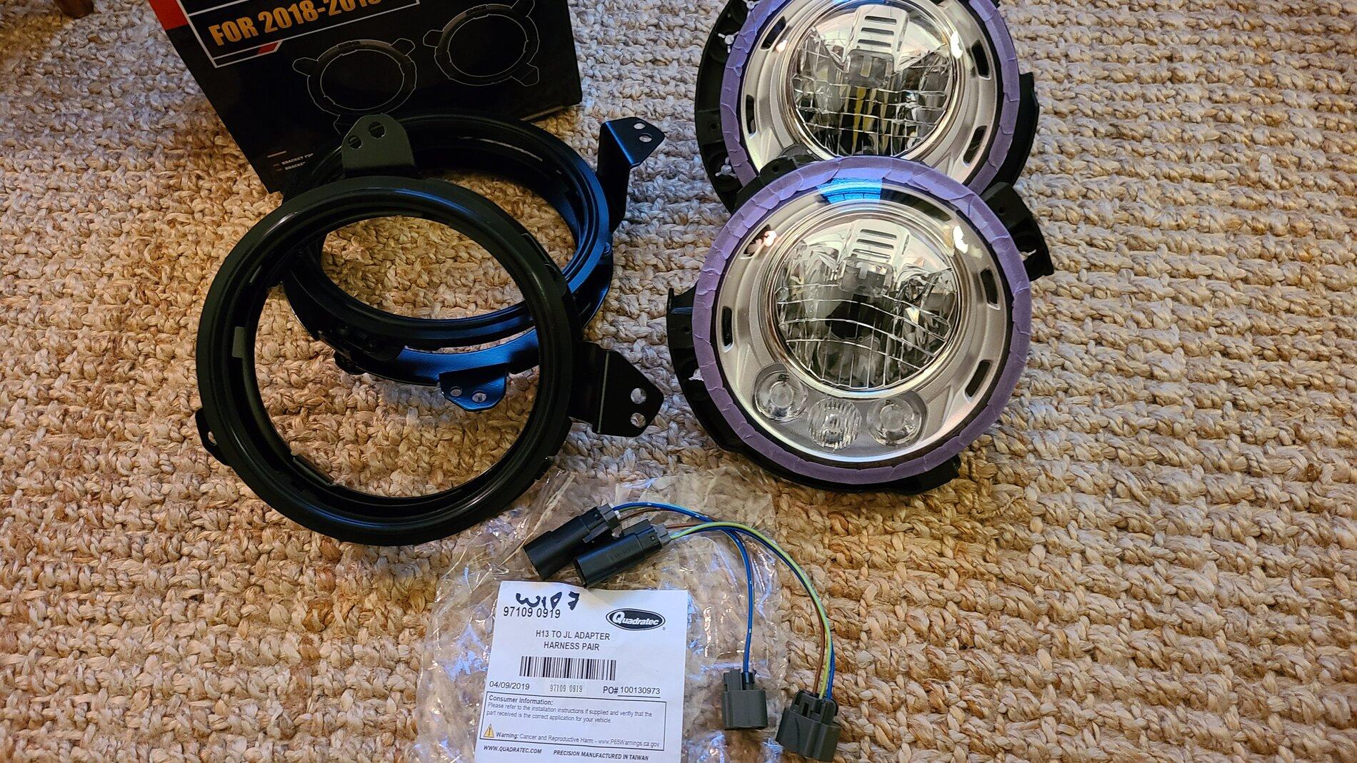

I got a set of JK LEDs with a broken mount for $100 on Facebook (awesome deal). Quadratec makes a harness specifically to go from the JK connection to the JL connection. As for the headlight adapters, I went for the Amazon specials but you can get yourself a really nice set for more money. (Which I might do in the future)
What you'll need:
  1. Headlight adapter brackets ($45): https://www.amazon.com/gp/product/B07KJZNM7P/ref=ppx_yo_dt_b_asin_title_o00_s01?ie=UTF8&psc=1
  2. Quadratec ($29): https://www.quadratec.com/p/quadratec/h13-jl-adapter-harness-jeep-wrangler-jl
  3. 2017 - 2018 Jeep JK LED Headlights (100): Facebook Market place
  4. You will need an LED headlight programmer or programming but I already bought mine for tire size, etc so for me: $0

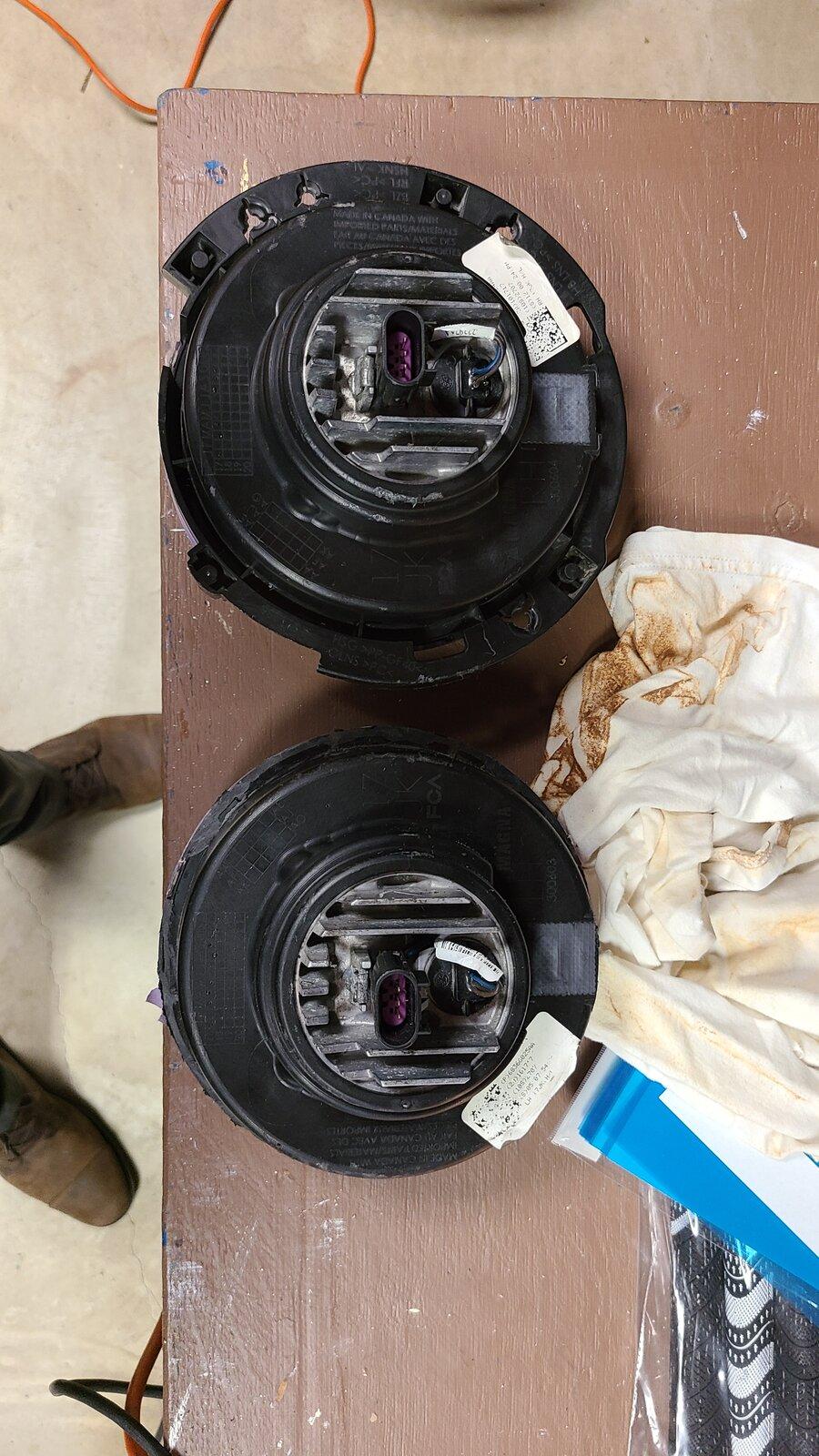

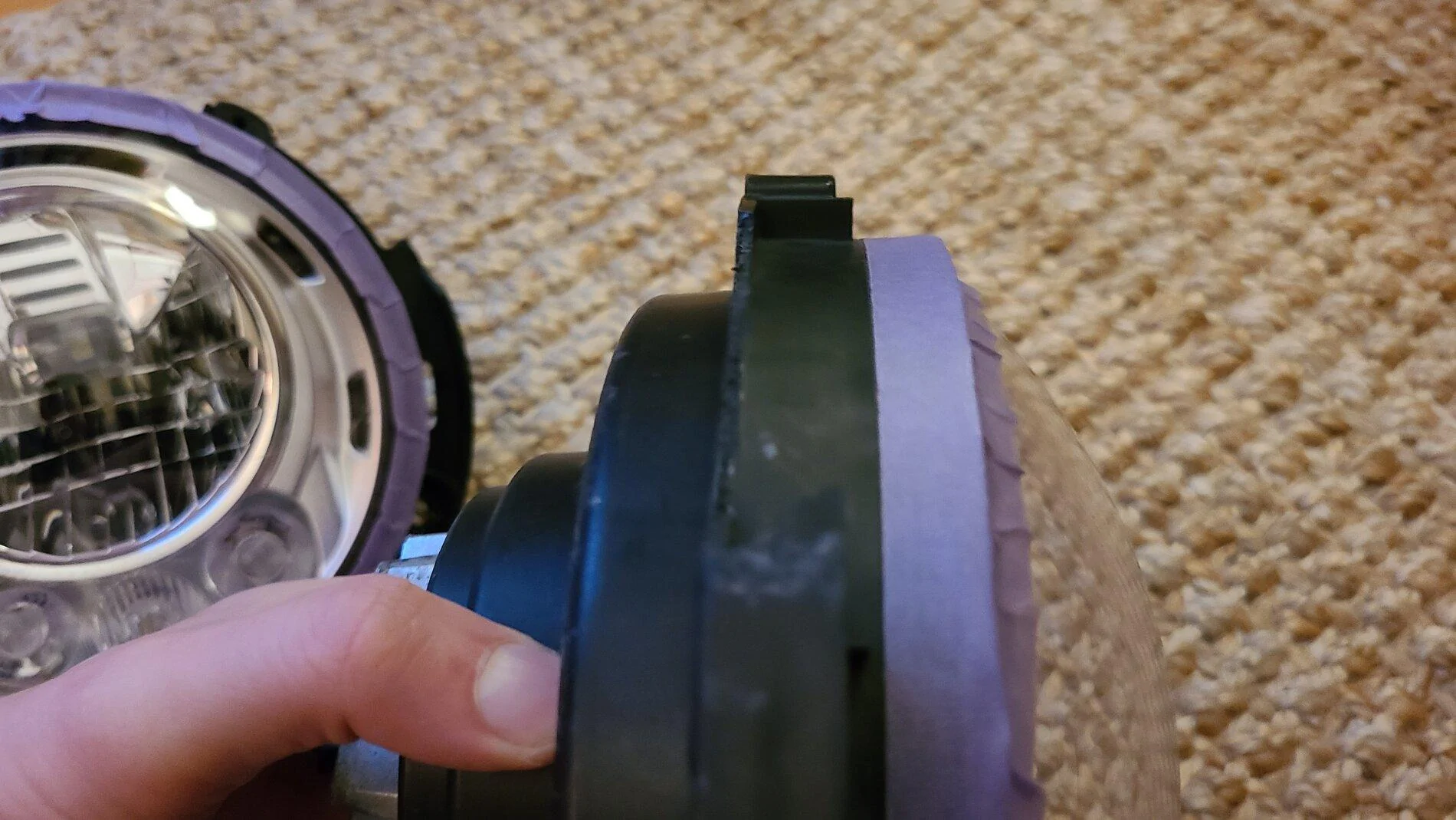

As of today - I have all the parts and have confirmed that the lights are plug and play with the quadratec wiring adapters. I will need to trim the JK light housing in certain areas to get them to fit inside the adapter rings. The trimming will only include removing plastic that was originally part of how they mounted to the JK. Should be a simple job for a dremel. The purple taped off area in the below pictures is the area the rings will cover. I will be trimming the raised plastic areas up to that point.
Over the next few days I will get to the install and tweaking the adapter rings to be just right. I will report back with my progress and more pictures of the install but couldn't wait to share.

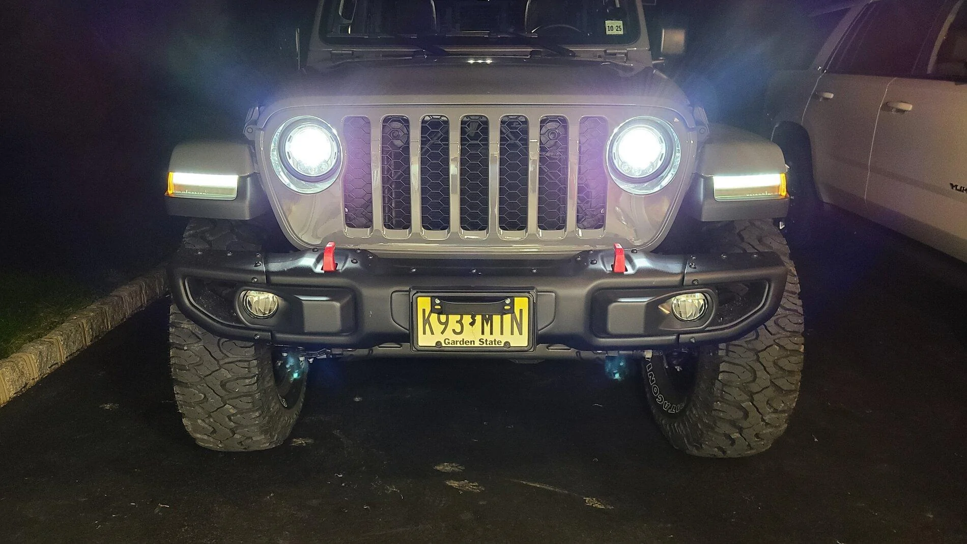

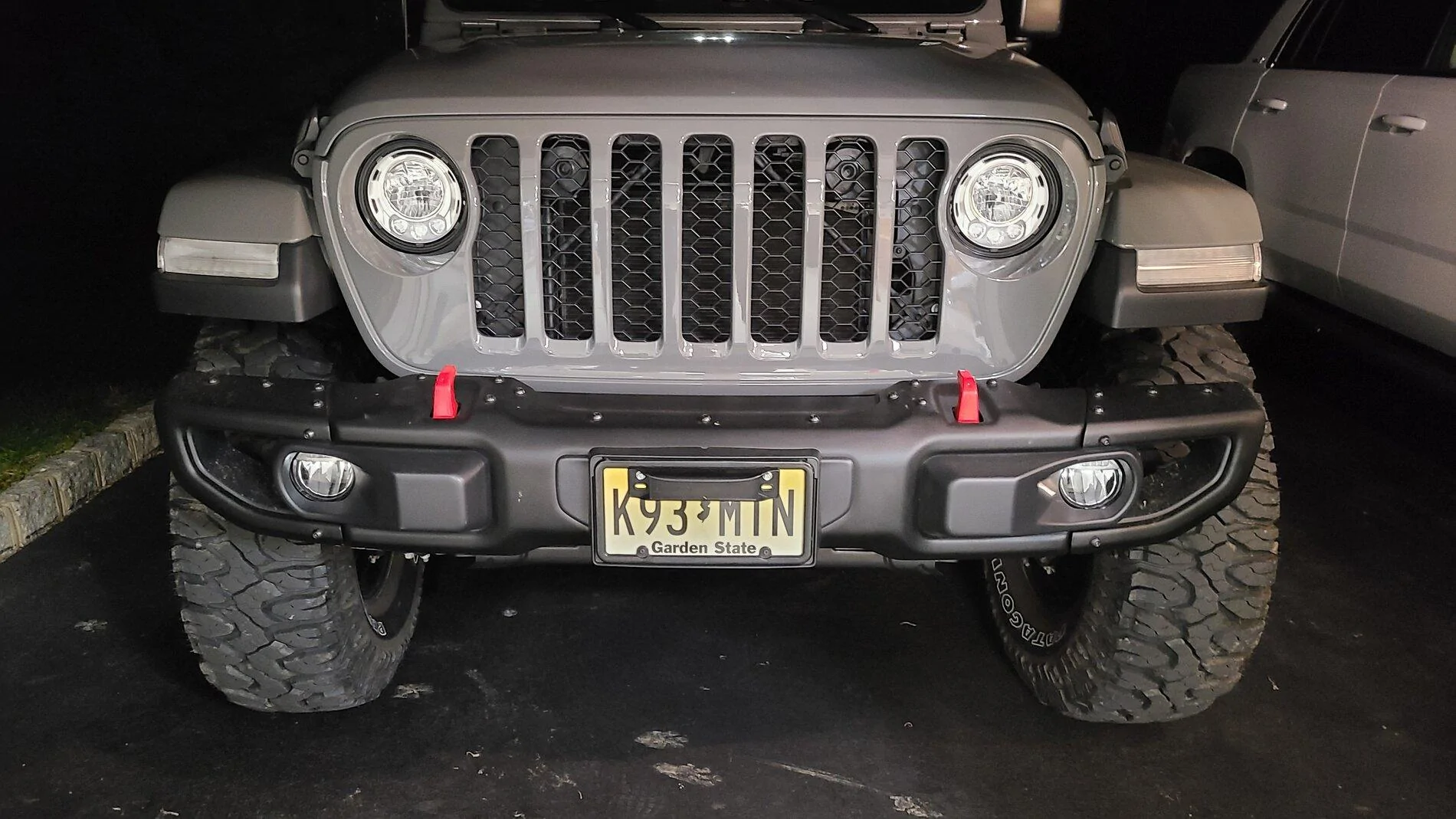

I completed the install tonight. Had to do a lot of cutting and sanding on the JK light housing to get it to fit in the adapter brackets. Overall install was about 3 hours including the cutting and sanding.
Jeep Gladiator Jeep JK LED Headlights Installed for $174! 20210401_215416
Jeep Gladiator Jeep JK LED Headlights Installed for $174! 20210401_215353
See pictures below of how to remove the old mounting locations on the housing. You then need to remove the tapered outside diameter of the housing so they slide into the adapters.
Jeep Gladiator Jeep JK LED Headlights Installed for $174! 20210401_193731
After that, the rest was easy. Mount the light in the adapter - mount the adapter/light on the Jeep - plug in the adapter wiring harness - adjust the beams and flash the computer.

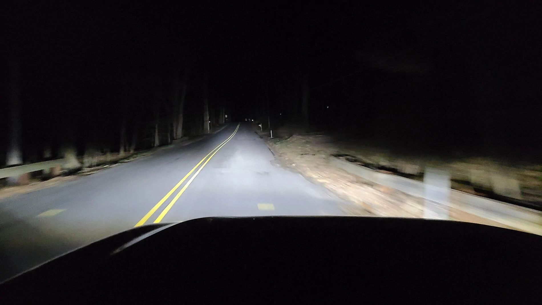

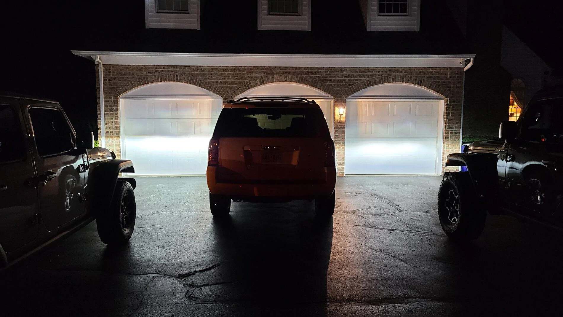

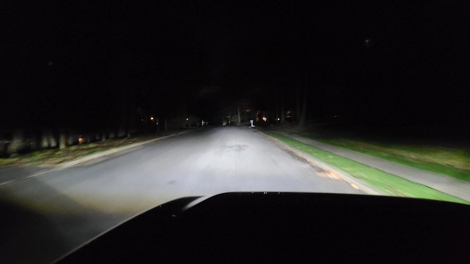

Overall, so far I am very pleased with the look and the functionality of the lights. The beam cutoff, spread and brightness are almost the same as my brothers Jeep JL with factory LEDs. See for yourself below.
Low Beam: (JL Factory LED left - JK LED in Gladiator Right)
Jeep Gladiator Jeep JK LED Headlights Installed for $174! 20210401_220233
High Beam: (JL Factory LED left - JK LED in Gladiator Right)
Jeep Gladiator Jeep JK LED Headlights Installed for $174! 20210401_220253
Low Beam at ~15 feet:
Jeep Gladiator Jeep JK LED Headlights Installed for $174! 20210401_220134
Low Beam:
Jeep Gladiator Jeep JK LED Headlights Installed for $174! 20210401_220532
High Beam:
Jeep Gladiator Jeep JK LED Headlights Installed for $174! 20210401_220556

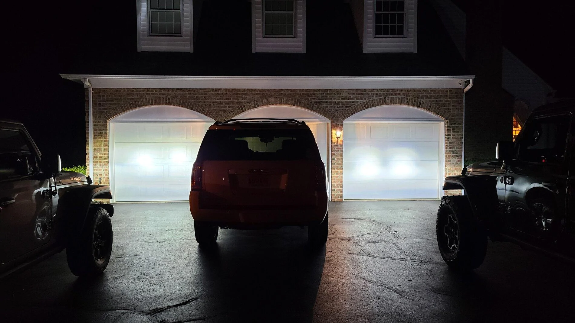

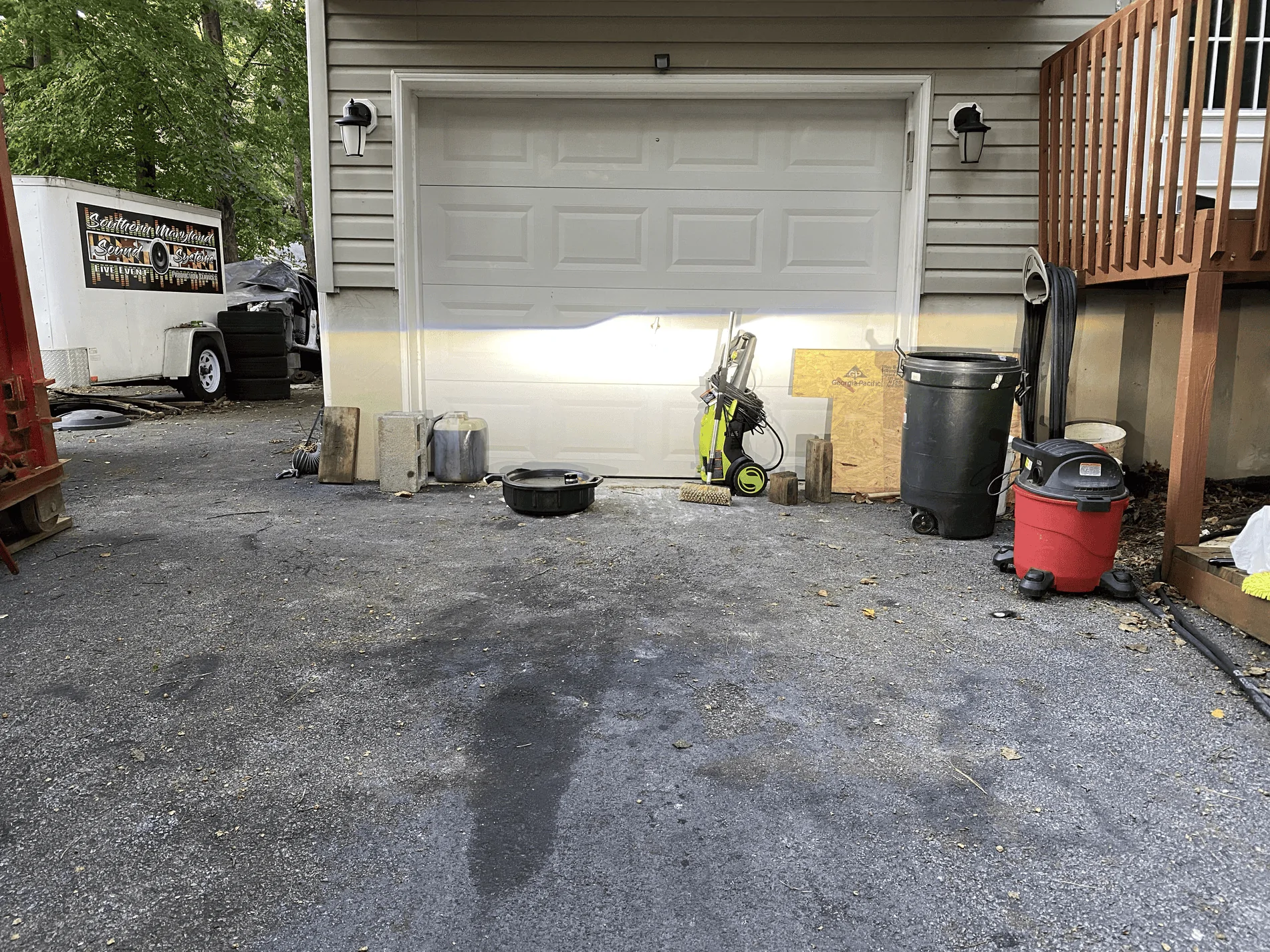

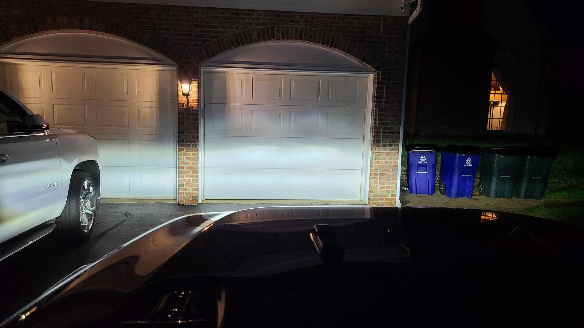

Jeep Gladiator Jeep JK LED Headlights Installed for $174! 20210401_220502
PASS... these have a lot of glare and will blind oncoming traffic... there should be almost no light on the top 2 garage door panels.
Here is what good headlights look like.
Gladiator_92
Gladiator_92
Rich
Aug 11, 2020
233
282
Northern New Jersey
2021 Gladiator Sport EcoDiesel
Project Management
Jeep Gladiator Jeep JK LED Headlights Installed for $174! tempImagei4woRu
I suppose Jeep manufactured headlights aren't "good" then? The lights I installed have the same cutoff as the factory JL/Gladiator lights in the side by side picture.
What brand of lights are you running? Also, how about a night shot, any minor bleeding above the cutoff will be significantly less during the day.
The install looks really clean and the 7" lights kinda have a utilitarian MB/GPW look to them. I also like the idea of OEM quality parts.
If I recall from my JK days, the 7" headlights have 3 alignment tabs to help them index into the buckets. From your pictures it doesn't look like those exist after trimming the extra material away. Did you have to manually align them and clamp them down with the adapter's trim ring? Have you seen any rotational movement?
Thank you, they have been awesome.
You are correct about the alignment tabs. I trimmed them off so these fit inside the adapter buckets. The entire circumference of the light makes contact with the adapter and it is clamped down so absolutely no rotational movement. You need to adjust them outside of the adapter because of how tight it is. Yes, it is a manual adjustment to align them rotationally in the bucket and then you can use the adjuster screws to align the light pattern out front.
