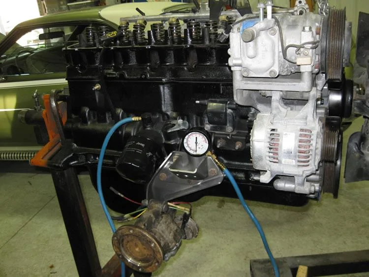

I have three 4.0 engines at home if you need specifics. They are the same dimensions as the 258 - and I have a couple of those, too.
The engine you refer to is based on the 4.0, a "stroker", most likely. They are strong engines, very strong, and crazy torque stroked. Hard to beat them on torque.
I still have my aluminum 4.0 prototype head to put on something - maybe a stroker should be what I do with the third 4.0 I have.

wasnt there some combo of using the 258 crank in the 4.0?
I think there was a problem with the squish, so you needed custom rods??
A "stroker". No need for custom rods.
There are two versions - the cheap version and a more expensive version with different pistons.
The cheap version - 258 crank, 258 rods (5.875-inch long), and pistons with the stock 4.0L piston pin height (around 1.60 inches.). (short rod version)
The more expensive "long-rod" version - 258 crank, the longer 4.0L rods (6.125-inch) and a shorter piston pin height dimension.
You may be talking quench - you want good quench and turbulence to prevent detonation. If the piston is too deep in the hole, (aside from lower compression) you are more subject to detonation issues, especially with slower RPM engines.
I've grossly over-simplified above - there's a lot more to it, multiple ways of building them, you can get kits, some end up needing higher octane fuel, and so on.
Frankly there are other things you can do with a 4.0 to beef it up a bit - the 4.0 in my SX4 isn't totally stock - .024" shaved off the head, roller rockers, Xtreme 4x4 cam, and I have an experimental prototype head sitting in a box I could swap onto it some day...........
