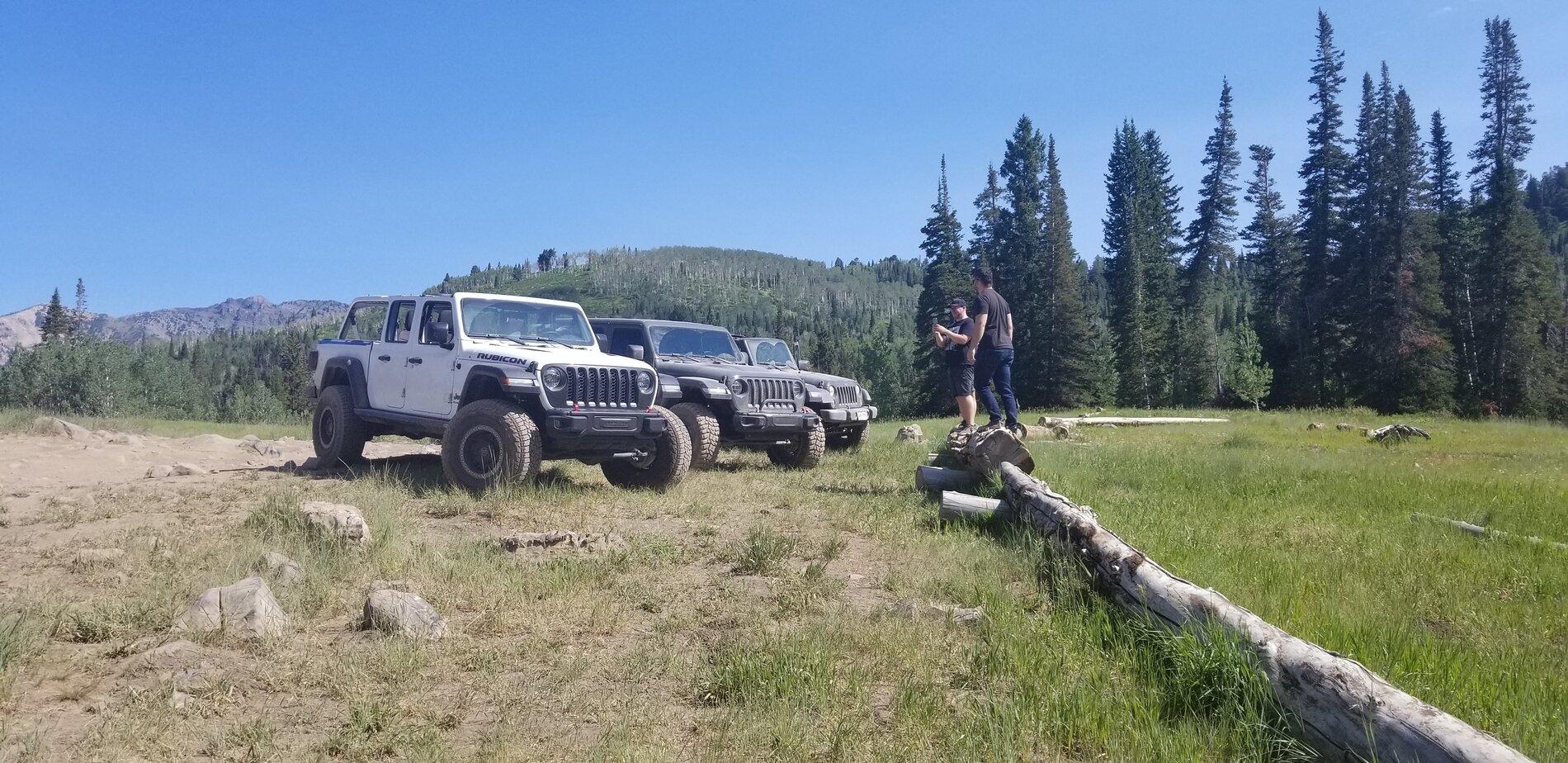

Yes and No.. After the mega delay from Covid lockdown, We ended up remodeling the house and this project had to go after, so now it is in process again, almost wrapped up but need to do final body work on the roof still. We have had it out and on the trails and the added stiffness from teh extra roll cage is great. The roof panels allow just enough flex that nothing bad seems to be happening, and there are not any roof noises either. Also the Falcon 3.3 shocks combined with the Jeep Mopar 2" lift is a perfect all around combo, rides better than it did stock on road, and is super comfortable off road, definitely a combo I would recommend to everyone.
Jeep Gladiator Jeep Wagoneer / Spartan Build [7 Seater Gladiator] Copy of 20200717_102517 (1)
