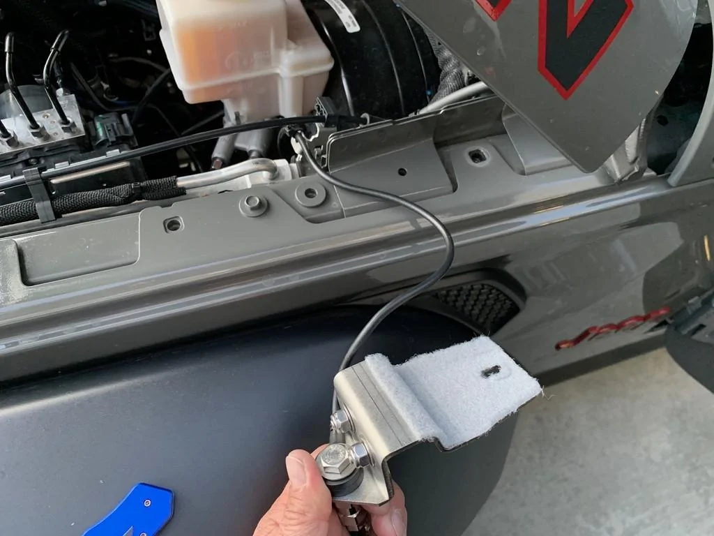

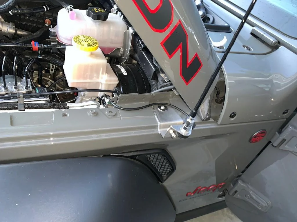

The Quadratec JLJT-CBFMK Stainless Steel Fender Mount CB Antenna Kit directions have you attach the antenna cable to the shielded wires on the inner fender. There is a rubber plug just under the drivers seat - exactly where the body seam is. Shielded wires run just under the plug. If you put your hand under the drivers seat and lift up the carpet, you can see it. Use an identical rubber plug with a hole in it, and then it is easy to route the wire under the carpet to the center counsel. The kit also gives you a heat resistant cover and stainless zip ties to put over the antenna cable because the cable is close to the exhaust.

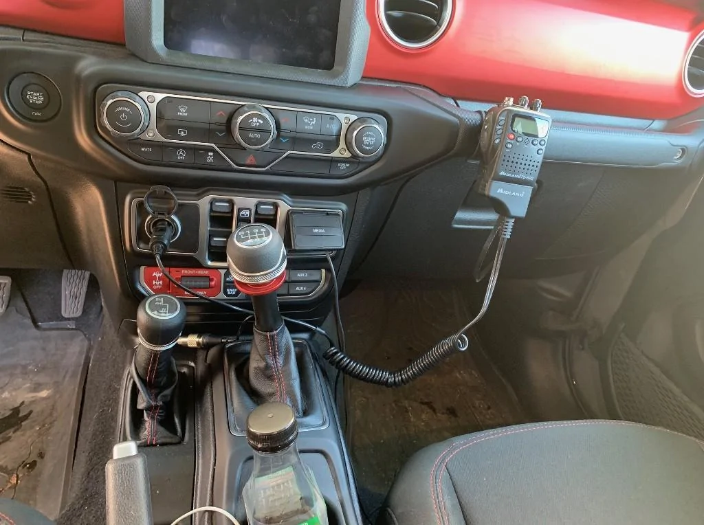

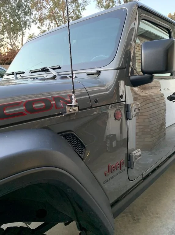

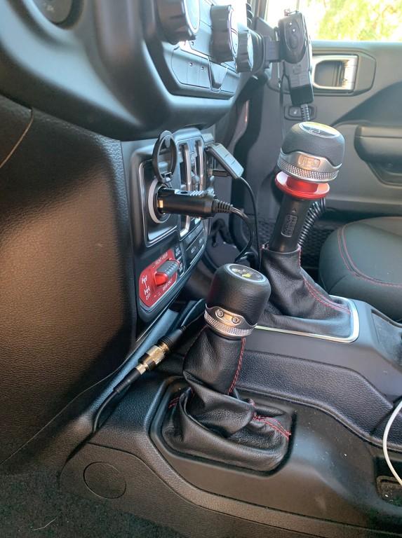

Here are some pics of the installation. I stuck some gray velcro fuzzy side tape on the bottom of the antenna mount to avoid any marks on the paint. I got a really good ground, I check it with the multi-meter. Mount is very sturdy, very level (can be adjusted) and routing the cable with the heat protection inside the frame is easy. Very portable handheld inside the Gladiator. I will only mount up the handheld when I need it.
