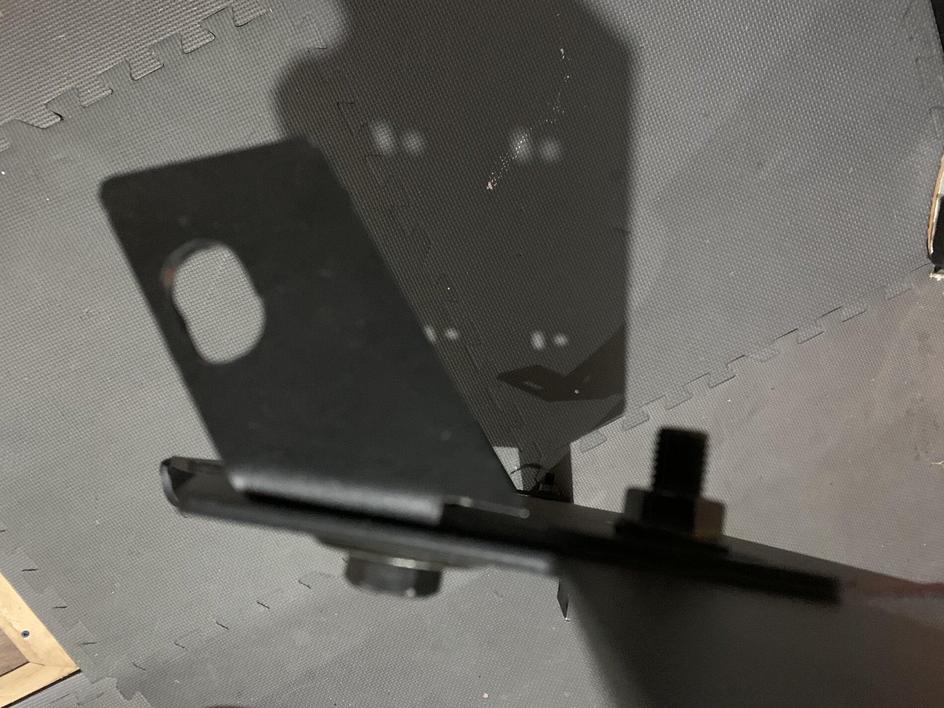

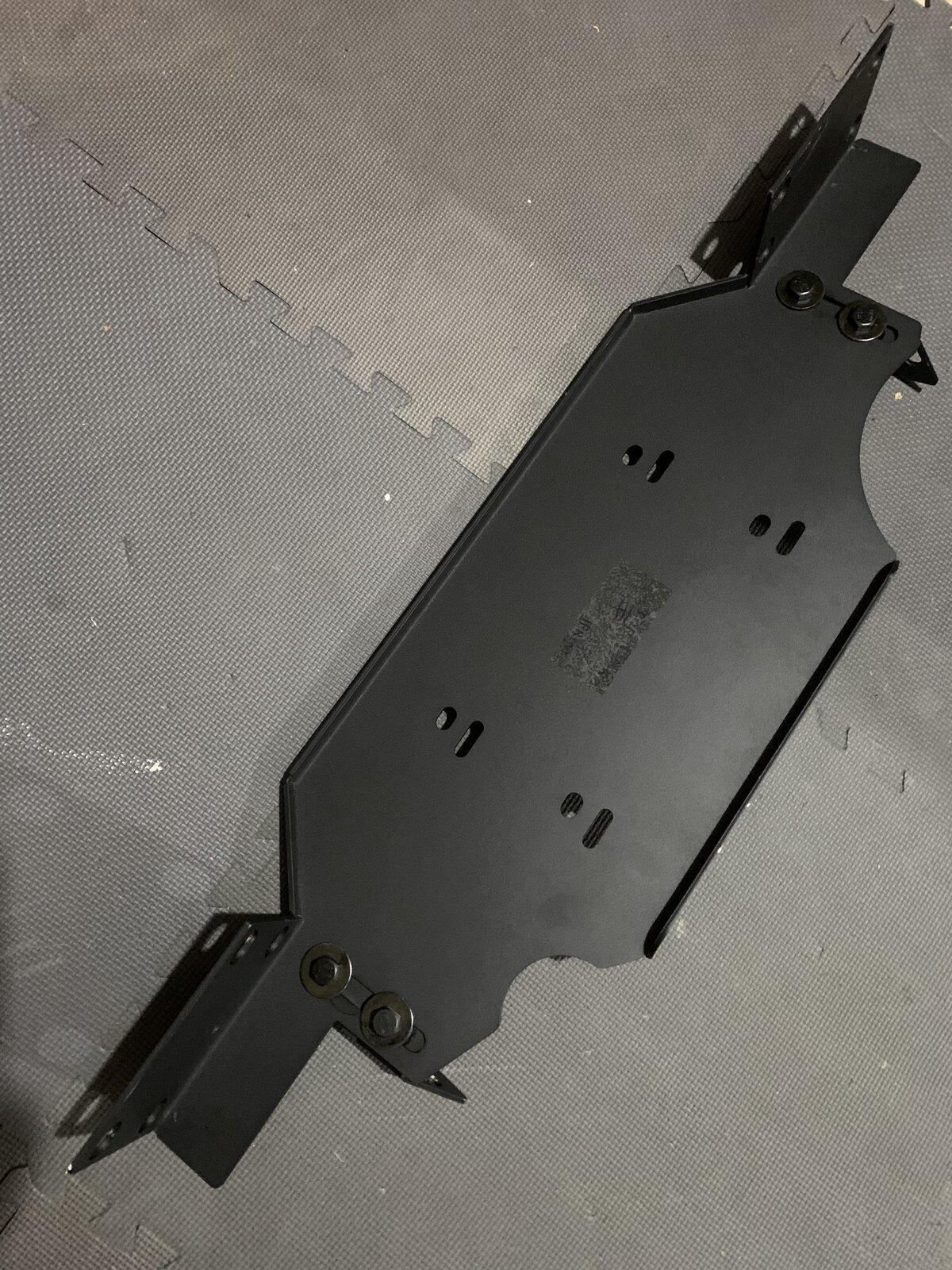

Jeep Gladiator JT front frame predrilled holes match JK? 922E94B5-2FF7-4018-AD08-D024D09CEED3
Jeep Gladiator JT front frame predrilled holes match JK? 39091BDD-DB73-4CB0-BE50-4BF9D365D728
Here is the JK winch plate that came with my Rubicon metal knockoff. It mounts right up to the 8 bolts on the JT and did fit with my knockoff bumper. The angled brackets in the second picture are where extensions go for stability and strength. Using a spacer before or after the plate should work, but like you said you will just have to try see what if anything needs to be adjusted.
