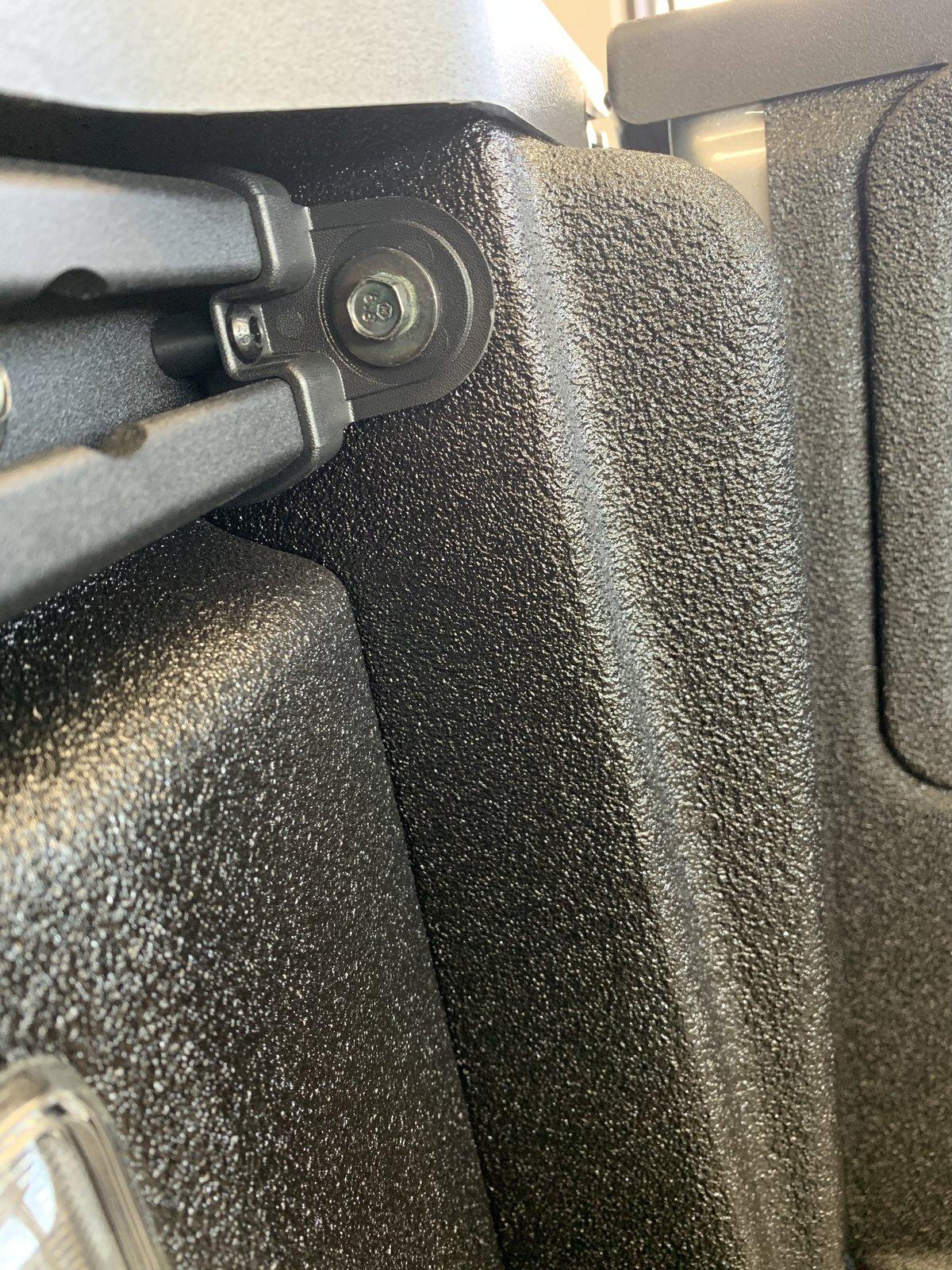

Clarification - know that the back rail has to be removed.
Do the side ones need to go as well?
Here's a pix. Not sure if you remove the end cap if the rail could stay on or not. Have more detailed pix on my build page - Glad Grandpa...
I was able to do the install with only removing the front ones and then adapting it to the current side rail.

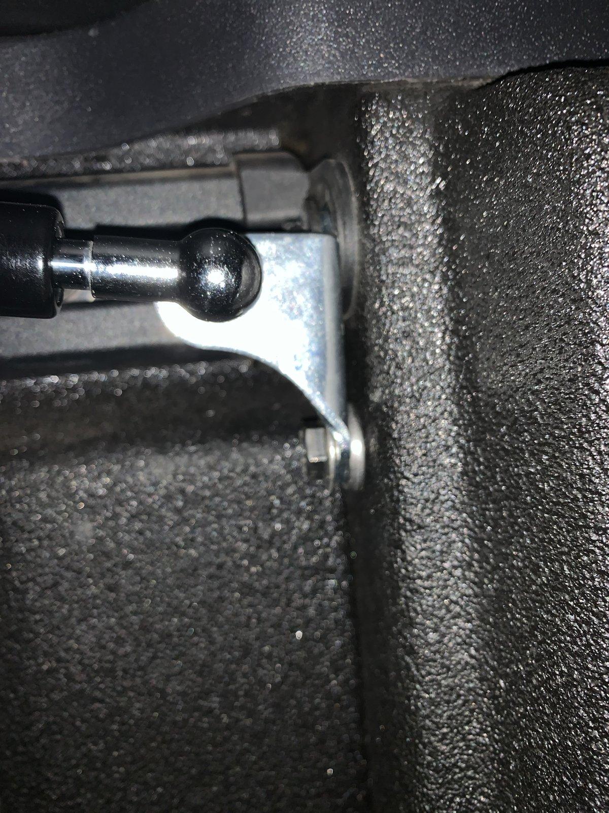

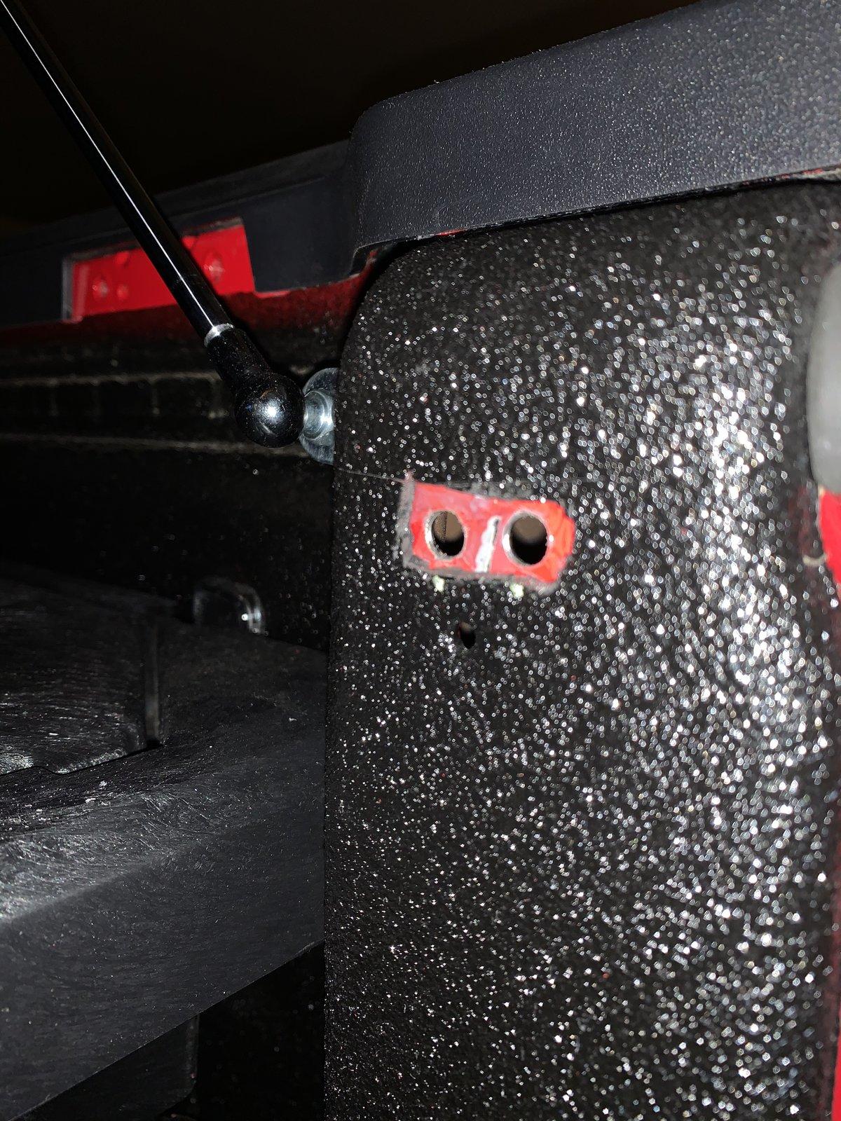

I think you should be fine with the rivet nut tool, just take your time and keep the insert as straight as possible. I busted my 4mm mandrel installing the nutsert for clips that hold the upper decker down when it is closed, on that side, one has been sufficient. On the other side, I decide to just use two self tapping screws which seem to be the better option anyway. Everywhere else, the nutserts went in easy with the tool.

Also make sure if you have the bedliner to clean some of it off if it is too thick......
