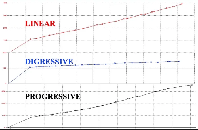

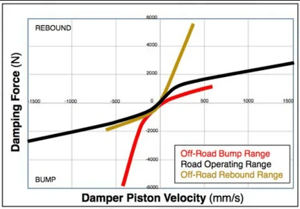

the big point of the ZR2 shocks is that they are DSSV dampers. Basically they use spool valves inside the damper to control the amount of pressure / damping force. Their selling point is that because of using spool valves, it is has more consistent performance (mostly while being pushed hard). Spool valves could have a digressive characteristic since they depend on a blow off. This usually is associated with comfort since they have less damping force at higher damper velocities. They say they can make any curve they want though so im sure they have some slick solutions for this. One thing I do know is if you have a problem, they are not cheap to go get a new one.
https://www.caranddriver.com/news/a...imatics-clever-spool-valve-dampers-explained/
https://autoweek.com/article/technology/what-heck-dssv-stuff-anyway
Fox shocks use a deflective disc design. These are pretty robust, and lots of tuning options and combos. You can even send the shocks back to fox to get rebuild or change the tuning. Most deflective disc have a linear damping force characteristic, but some trickery can be done by using preload disc or adding spring disc in the stack to change the curve. This is pretty good for a sporty feel but as damper velocities go up, so does damping force so that can be pretty jarring when you hit pot holes or rocks, or cracks off road.
Depending on what jeep bought from fox, they could have very similar tech inside. The DSSV damper has a sort of "anti bottoming" feature. so if the damper gets compressed too far the damper gets more damping force. Fox also has something like this. One thing fox has that I dont see on the DSSV damper is internal bypass. this makes it possible to control damping force biased on the position of the damper. example would be if you know at ride height the damper could see some short high speed inputs like driving down a dirt road, you could lower the damping force for the first inch of travel so its more comfortable.
