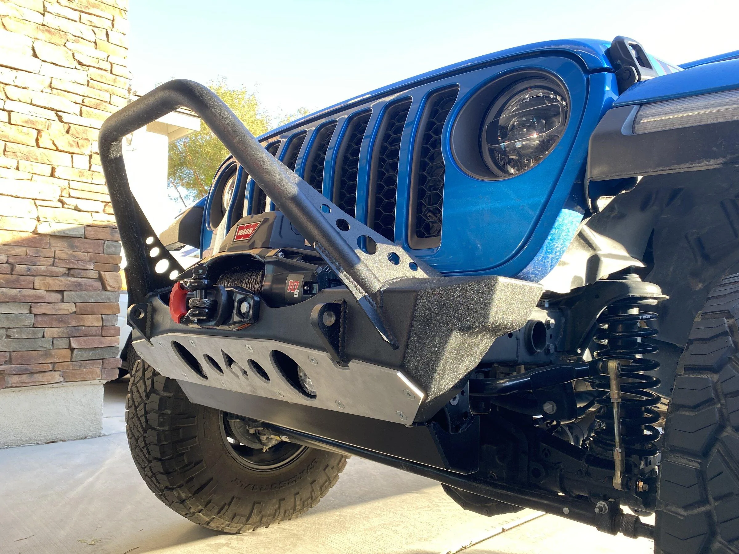

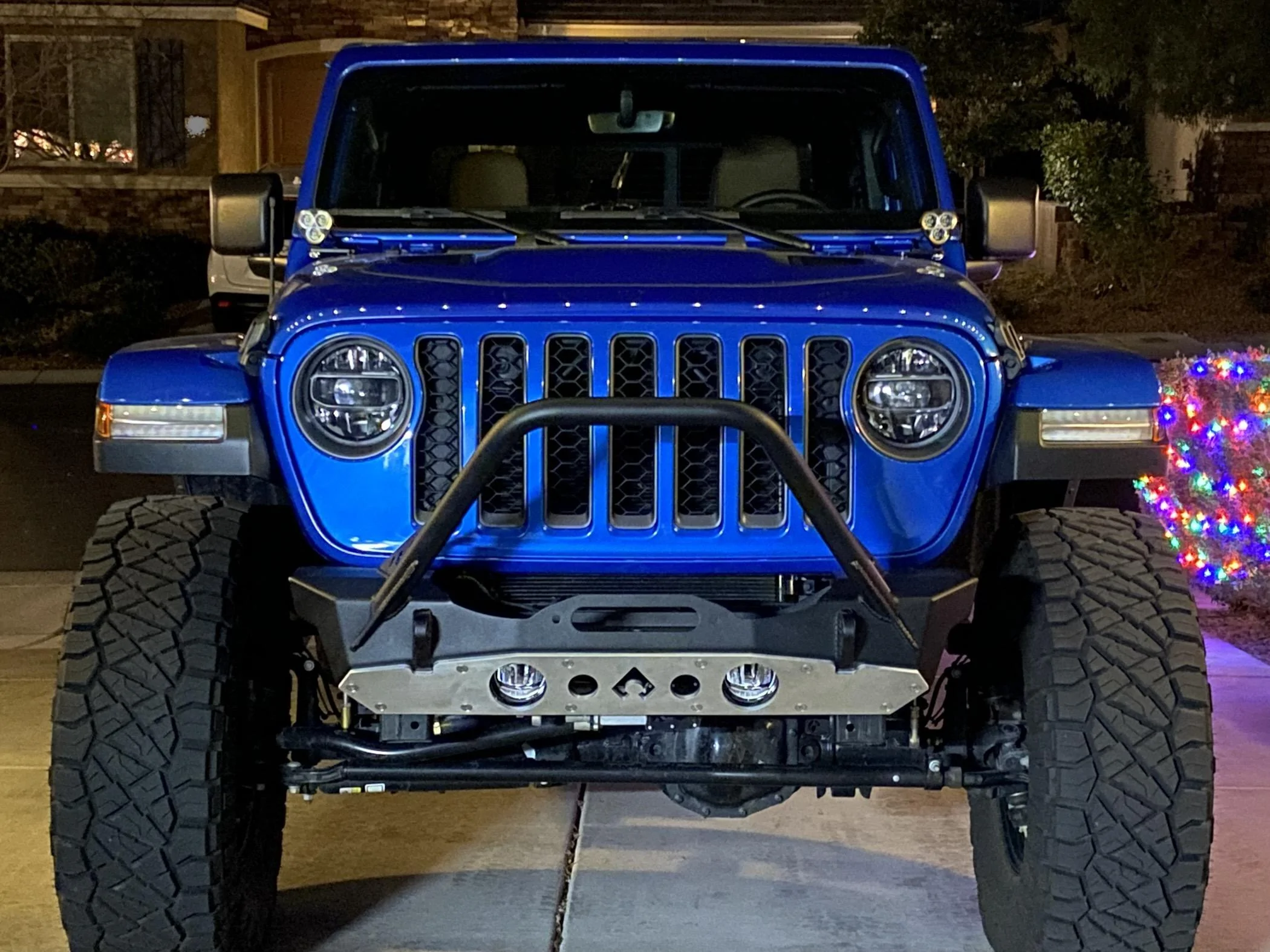

I appreciate everybody’s photos as it has helped guide my decisions regarding my own build. Here’s what I’ve done so far. Hope it helps some of you with your build decisions

Swaybar disconnect skid is shown in this photo. I just cleaned, primed and rattle canned it. I had to remove the two lower factory nutserts on the frame horns so it could fit.

  • warn evo vr10s winch w/synthetic rope
  • Artec Nighthawk front bumper and skid
  • Artec front axle truss w/labor
  • Clayton 2.5” Overland Plus lift kit, Artec rear axle truss, and labor

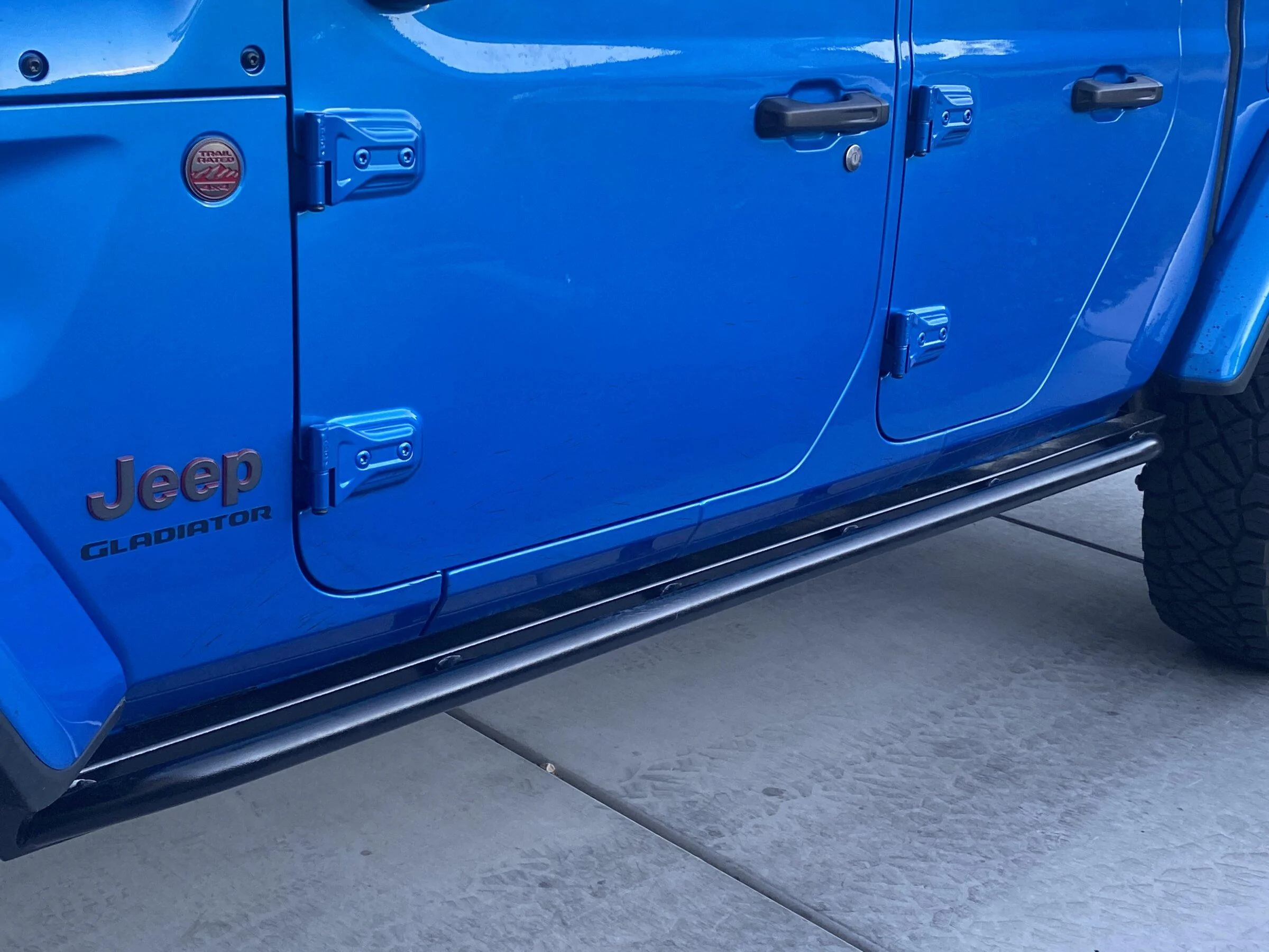

  • Rock Hard rock sliders
