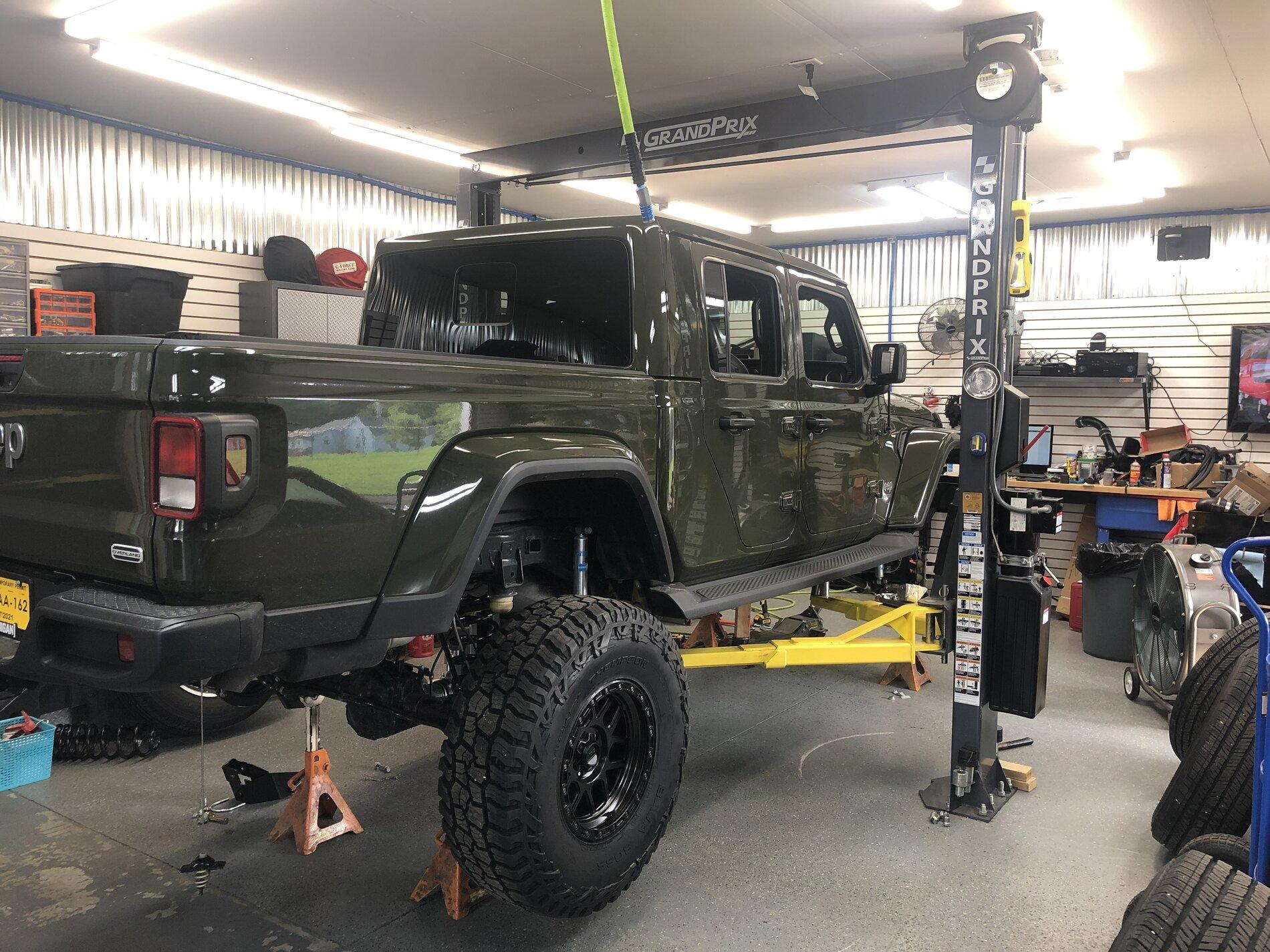

Hopefully my evo 4.5” overland kit will be done this weekend, crossing my fingers wheels and tires will be in
Would you be able to upload some pictures once it's finished? I'm debating between 2.5 or 4.5 for running 37" tires.
Also, did you have to install a new driveshaft? I can't seem to get a solid answer for the EVO 4.5" lift...

I’ll buy new driveshafts once it’s done and settled in. Rear track bar bracket was bent/welded wrong. Evo sending me a new one out. At the moment I’m cutting off the additional bracket the diesel gets on the driver front spring bucket area to install a synergy steering box brace. Picked up my kmc wheels and 37” Mickey thompson trail boss a/t today.
