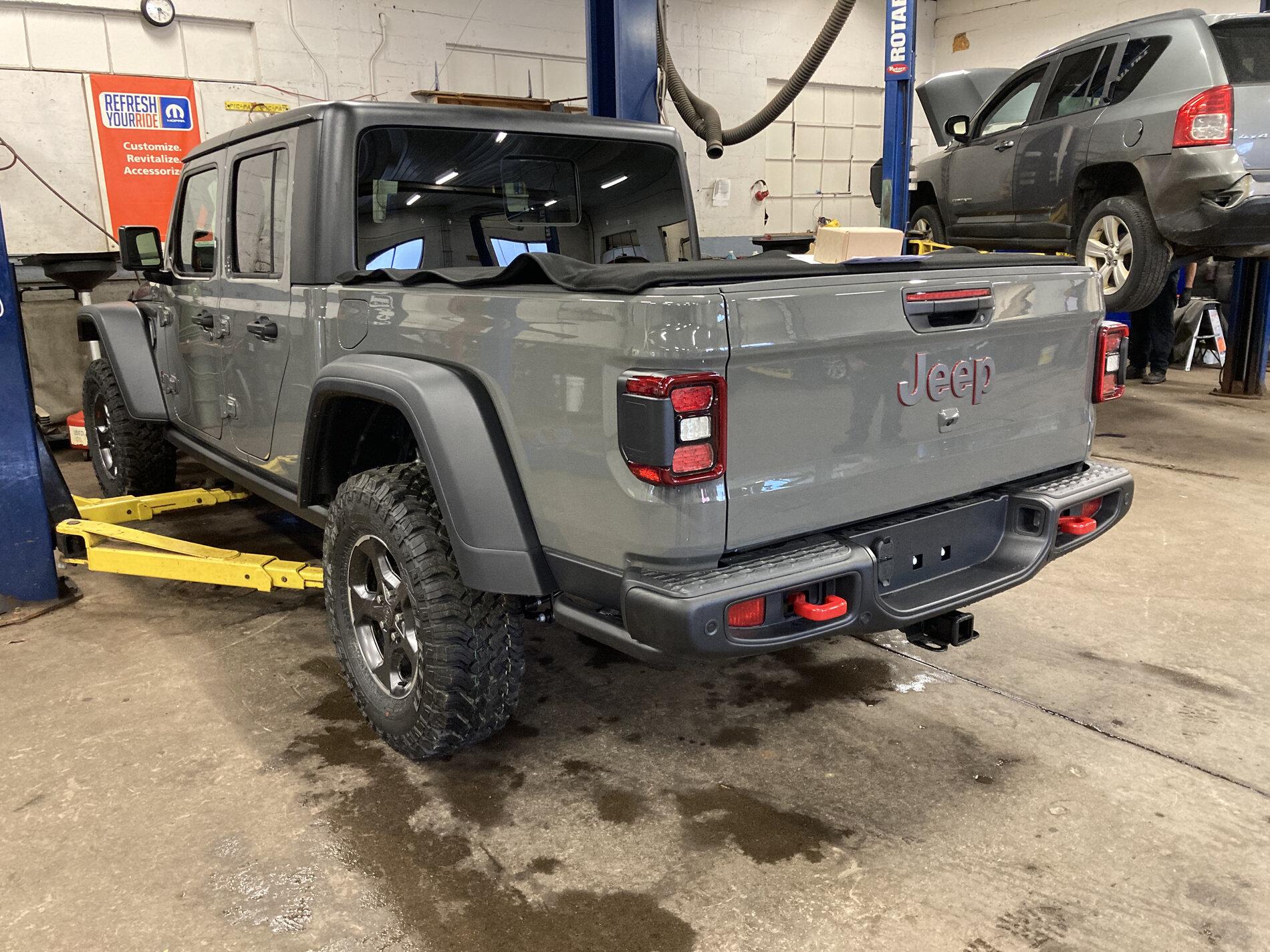

Post BFGs and Mopar lift:
Jeep Gladiator Having it all - JTRD sun buggy, trail rig and overlander IMG_3425 copy

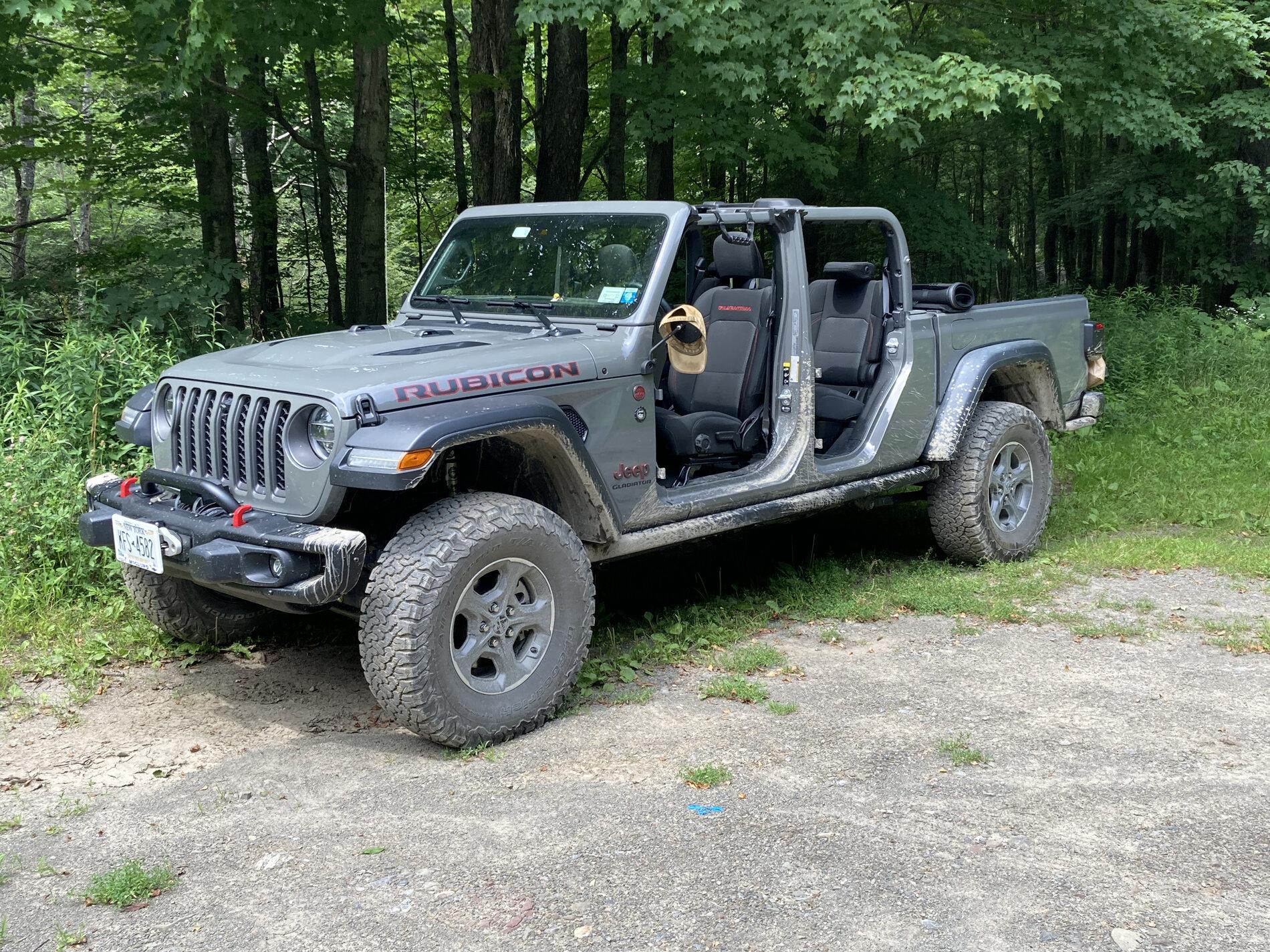

Typical Northeast trails:
Jeep Gladiator Having it all - JTRD sun buggy, trail rig and overlander IMG_3458

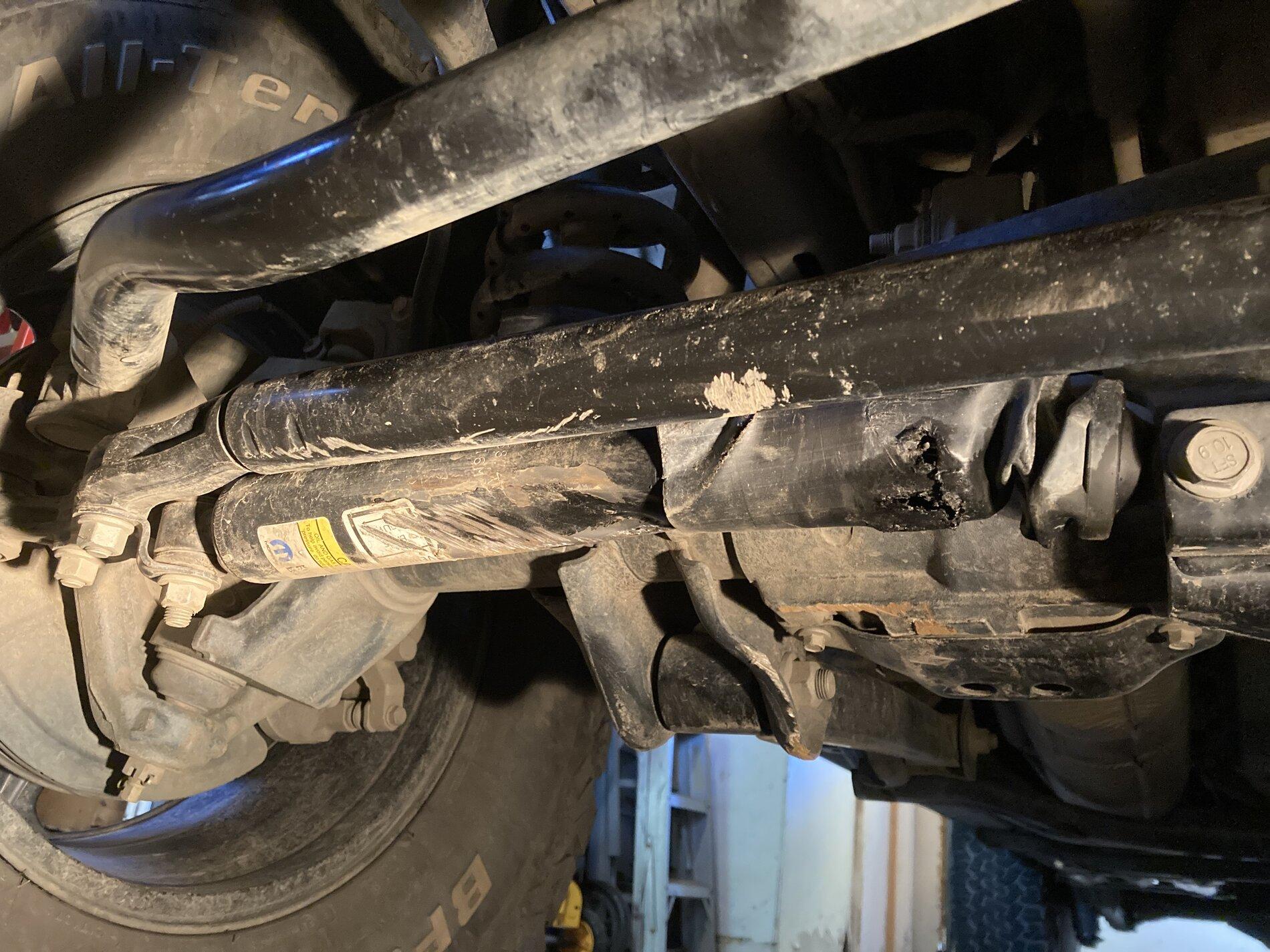

Had a great day last weekend with a group of folks from this forum at AOAA in central PA. Definitely learned a lot about the rig and a lot as a driver, especially after an afternoon session on some more technical blue trails wheeling behind @Kindafearless.
One of the lessons, and one I was looking for, was what else might need some protection. Took enough hits to see that control arm skids make sense, and a post trail introduction to death wobble at 60 mph taught me that a stabilizer relocation is a smart investment. That stock location is not rock friendly at all.

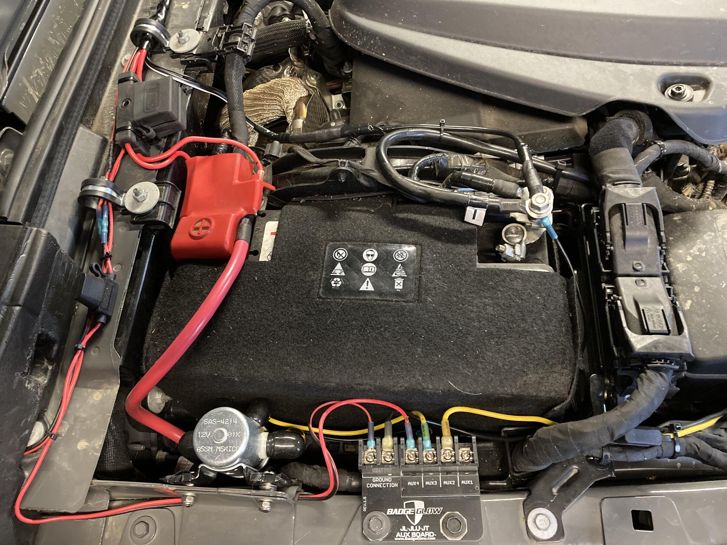

Just catching up on some of the work I've tackled since Thanksgiving. Nothing earth shattering, but we're getting there ...
First up, I installed the Warn interrupt solenoid into my winch wiring. Pretty much borrowed the layout and wiring from @rickrogan and the folks in this excellent thread.
Layout is a little different since the battery is in a slightly different spot on the diesel. I used some bolts and spacers to attach the solenoid to the pinch seem at the top of the fender. Ground is straight to the battery. Switch trigger power for the solenoid comes from Aux 3 (only needed a little power to flip the solenoid, main power still comes direct from the battery). Absolutely love this thing. I've respooled a few times on an incline, and the solenoid has shown no issues with getting too hot. It's off most of the time, and using the Aux line let me set it up as ignition power only, so no battery drain snags.
Jeep Gladiator Having it all - JTRD sun buggy, trail rig and overlander IMG_1232
I'll throw in a plug for another thing I found on that thread: the BadgeGlow aux board. Easy install, they even included the connectors with heat-shrink tubing, and it mounts right above where the factory wires terminate (they tossed in the needed second bolt as well). Super easy now to add or switch wire connections. Aux 4 and 3 are lower amp and run small Rigid Duallys and the Warn Solenoid. Aux 2 got KC Flex 4s. Aux 1 is waiting for a DC power outlet I plan to add to the bed.

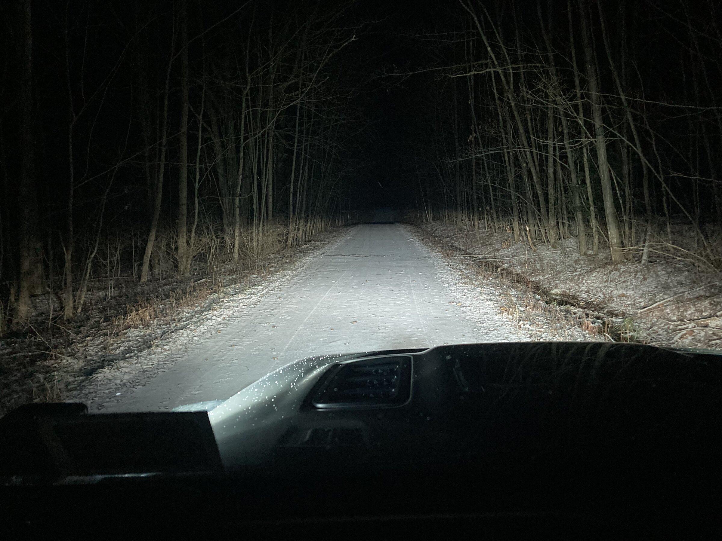

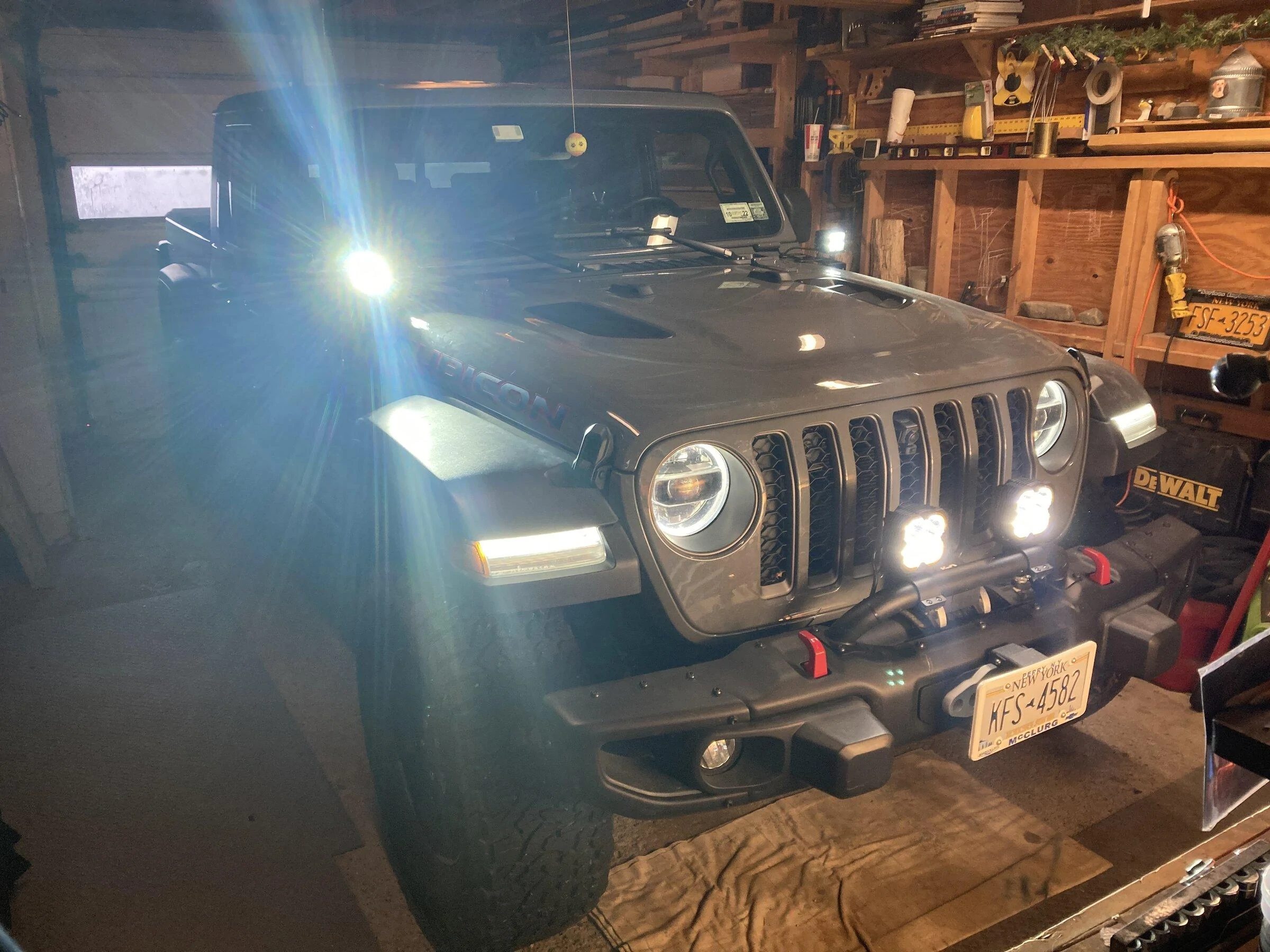

As noted above, next up was some basic trail lights.
I added a set of Rigid Duallys mounted on the Mopar A-pillar bracket. I was happy to get the newer version of the bracket, that doesn't look as blocky. With a slight modification to the aluminum base, my Lange Coyote mirrors (which I love) went right on and work with the Mopar brackets. These point forward now, but will mostly be angled sideway when I'm on the trail as ditch lights.
For a better look forward, I added a set of two KC Flex Era 4 lights. Man, they package those things as pretty as iPhones! Solid feeling lights with more than enough switches, wires and relays to get the gig done, very little of which I used since I was just going back to the Aux 2 post on the BadgeGlow. I left the inline fuse in, which might be redundant when using the Aux lines, but what the heck. They're mounted to Mopar winch guard brackets.
Jeep Gladiator Having it all - JTRD sun buggy, trail rig and overlander IMG_0935

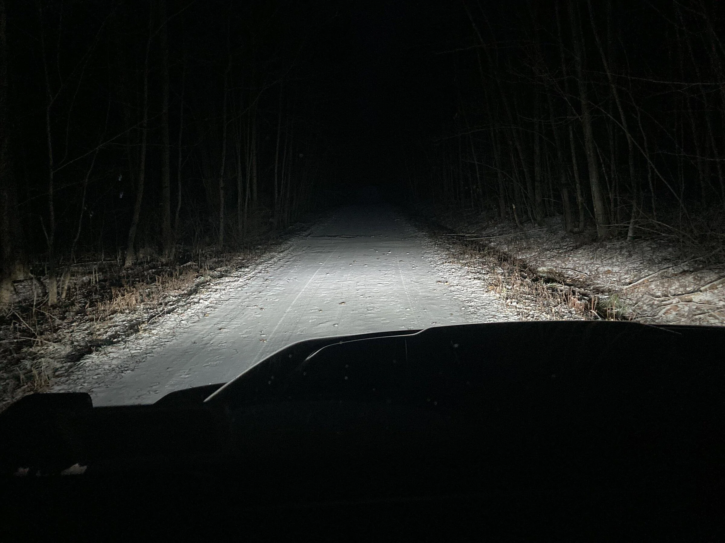

I know this is pretty modest for trail lighting, but I'm trying to step into this gently and see what i need in real use, rather than break the bank on items that end up as overkill. I did take the setup out to a state forest for a winter darkness test, and the vey unscientific results are below. All I can say is damn, those KCs lit up the world!
First, just the factory fog lights in the bumper (rise down the trail is about 300 feet away)
Jeep Gladiator Having it all - JTRD sun buggy, trail rig and overlander IMG_0938
Add in the headlights (I have the LED option)
Jeep Gladiator Having it all - JTRD sun buggy, trail rig and overlander IMG_0939
Highbeams
Jeep Gladiator Having it all - JTRD sun buggy, trail rig and overlander IMG_0940
With Rigid Duallys
Jeep Gladiator Having it all - JTRD sun buggy, trail rig and overlander IMG_0941
And then turn on the KCs. They easily toss out more light than the rest of them combined.
