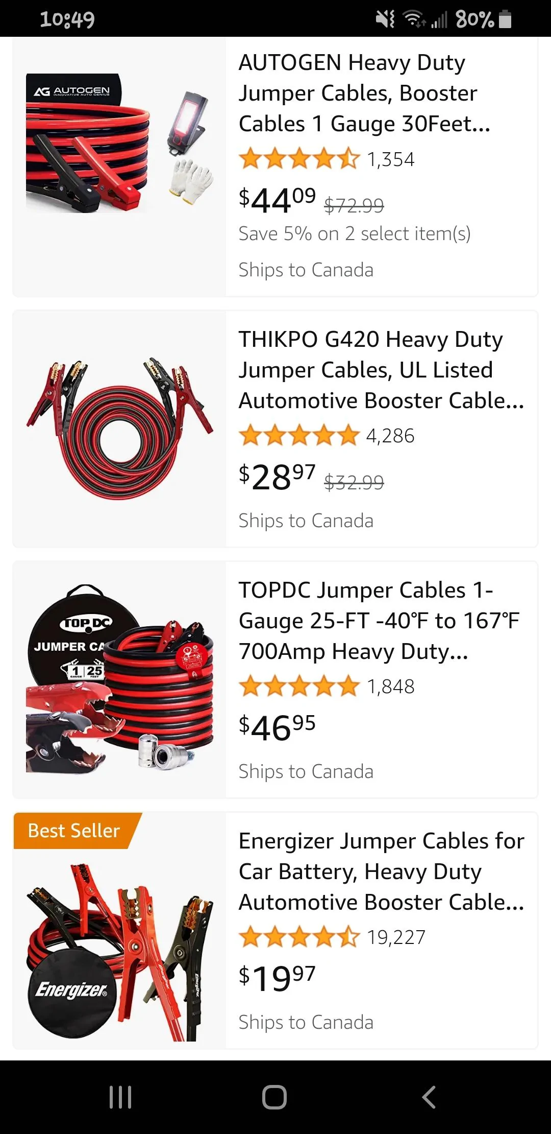

I carry the 30 footers, you can minimize space with the 16 foot length. I do like that jump box idea. However I always crawl
Jeep Gladiator Jumper cable or alternative Screenshot_20221117-104907_Samsung Internet
with a buddy, so I'm good with the cables.
