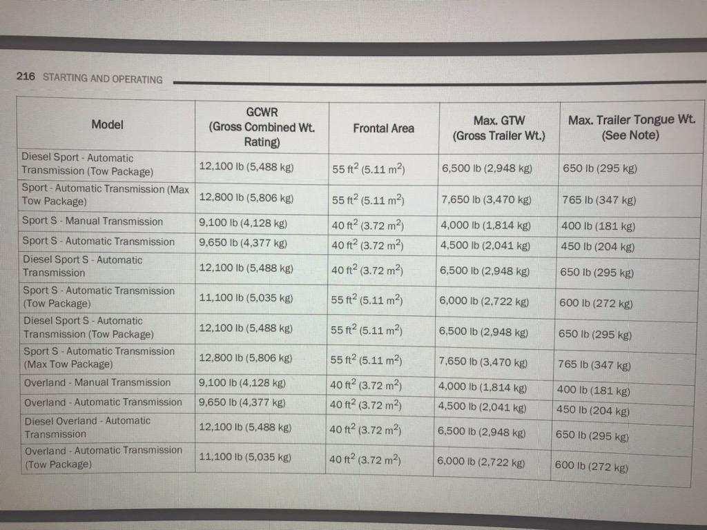

there are some threads on here, I asked this too back when I bought my Willys, I’ll see if I can find that thread and link... in my digging this site/these fine people are the best/better sources of otherwise hard to find info: “Tow Ratings.... clear as mud”
beerviper posted this in that thread:

I guess that tow ratings guide is all we have to go by. The Willys doesn't have the exact same suspension as the Sport S but should be at least as good towing.
