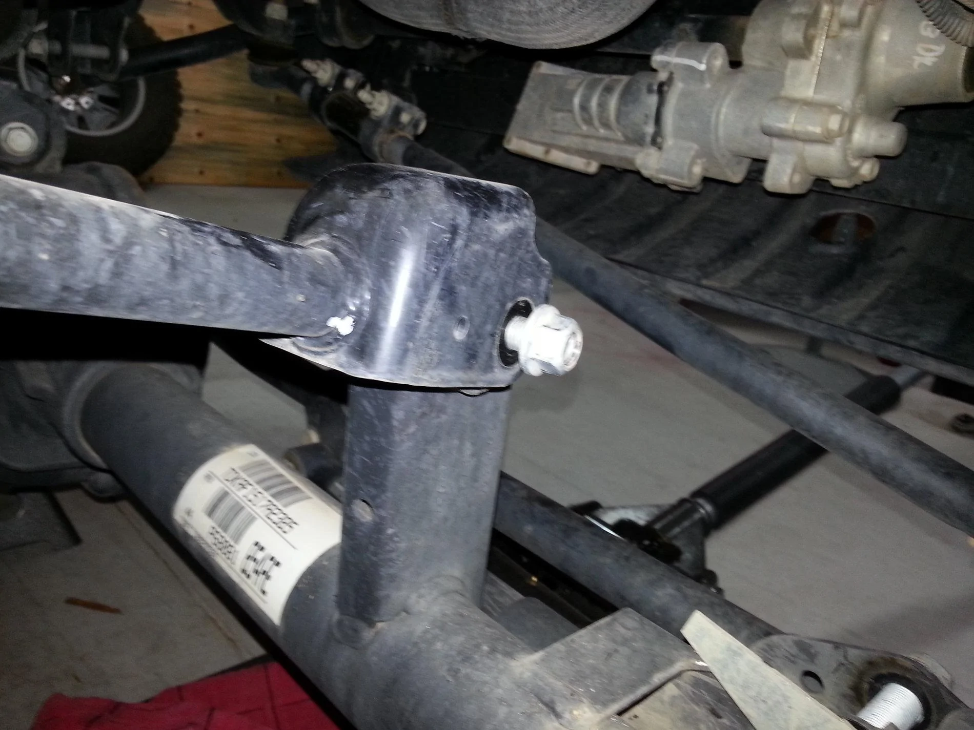

Discovered this on my 17 JKUR when I was putting the lift on at 5000 miles. Don't know if the factory failed to torque this bolt or if it backed off. I think it never got torqued at the factory.
YIKES! it backed off but the only reason would be it wasn't properly torqued. They don't just walk out if it's a good bolt and torqued to spec. Not after that few miles unless you drove Illinois highways, then all bets are off.
