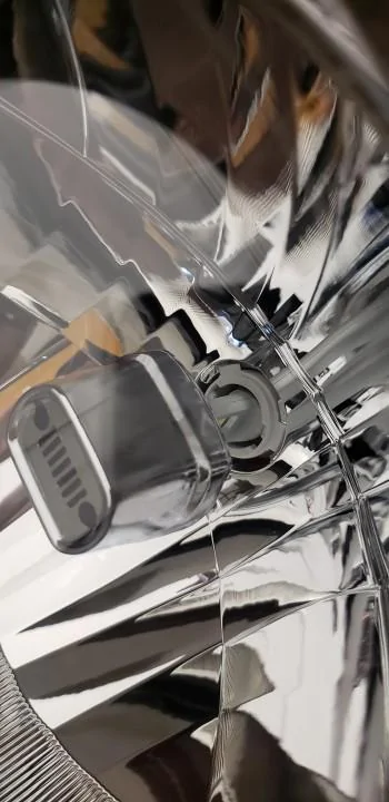

Just put in a set of beamtechs. They are oriented up and down correctly, but i notice that when screwed into the light housing, they arent 100% straight up and down for the light body. They have little screw holes in the beamtech housing itself that you can take out and clock it to another hole, but if I did that, the bulb body would be even more crooked than how they are currently. Is it normal when putting them in for the LED body to be just a hair cocked on each one say 5 to 10 degrees from being 100% up and down. There is no in between for the adjustment holes on the body. Otherwise they look good and highs and lows act normal. Didnt know if that 5 or 10 degrees from straight vertical would make any difference on each light, or maybe they are made to be that way.

I have different brand LED, this is how mine looks like

Led should be a lesser draw as stated. Before switching settings, system is looking for 55W draw, or close to. How the system operates is what causes the pulsating, or hyperflash with blinkers, and eventually throwing a bulb out warning. Not all canbus bulbs are perfect either, but most are fine. After changing settings, system will see all is good and less likely chance of issues. But if u run bulbs that are at or near original wattage, u shouldn't need to change settings. Been playing with leds for a few yrs now and the tech seems to change bout once yr. Also, when referring to led bulb orientation, please reference diode placement at 3 and 9 o'clock for clarity. I was about to pitch a fit bout ur first post. Luckily I read everything completely. Finally, make sure ur beam is mostly flat, a little higher on rightside is ok, but make sure the cutoff is where ur halogens were so as not to blind traffic. Best of luck.
