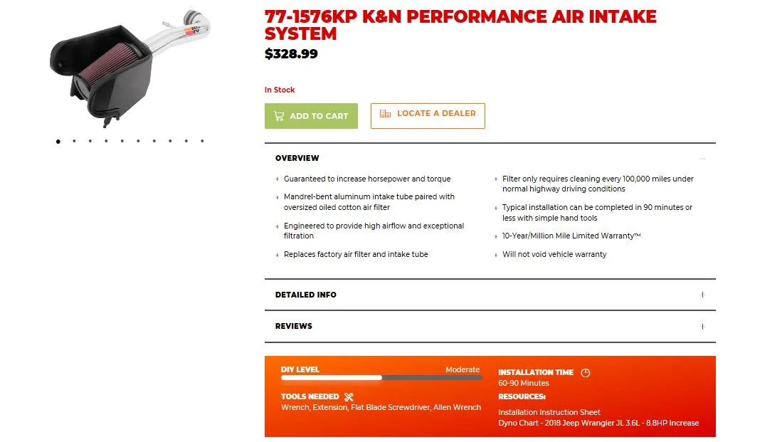

Installing this tomorrow:
Who else has installed a CAI and what do you think so far? It's a standard upgrade that I perform on all of my Jeeps, but excited to experience it on the JT.
WXman
Mar 1, 2017
69
3,102
4,068
Bluegrass region of Kentucky
I think it's interesting that they claim "will not void vehicle warranty". So is K&N giving a written guarantee that if your engine gets hydrolocked because it's now easier to suck in water and larger particulates and FCA denies coverage due to the non-factory part, K&N will step in and pay for the repair?
I've used these kits on Jeeps and pickups and cars in the past. But I tend to shy away from them these days, especially the K&N kits that use oiled filters. The oil can coat the MAF sensor and over time it can lead to poor readings coming from that sensor. Also, there is zero fuel savings because the ECU will always keep the stoichiometric ratio where it's happy. So, more air in equals more fuel in. So really, all these give you is more sound, and sometimes 5 HP at RPM above 5,000. It's sort of a waste of time.

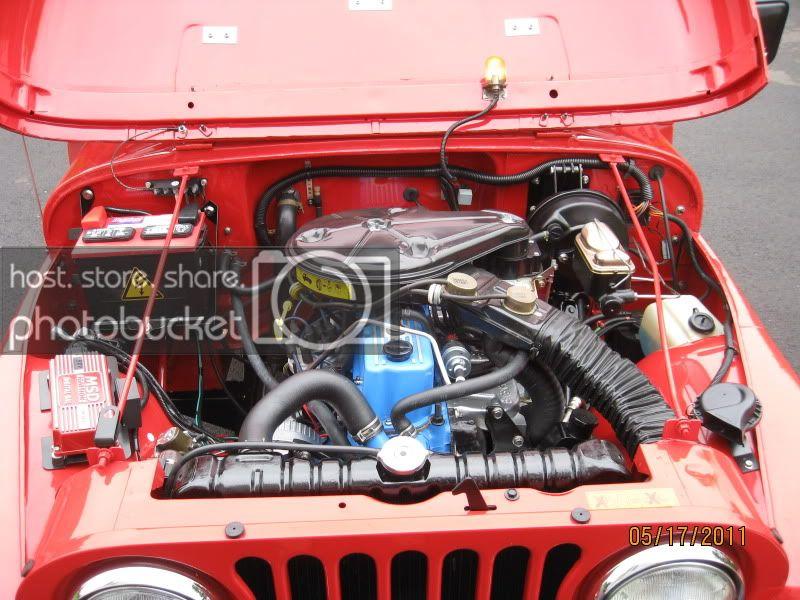

OEM CAI
This works it is what I based my design on a noticeable difference in + mpg about 1-1.5 mpg improvement city/hwy. Jeep ports the intake hose directly to the back of the headlight bucket.

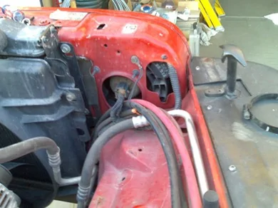

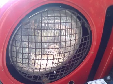

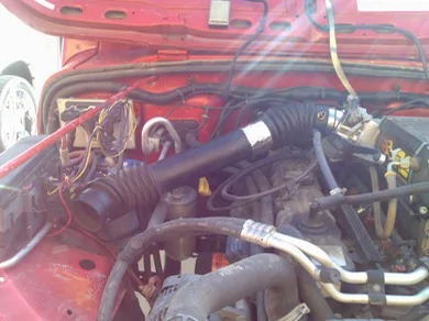

I did play with it and it really worked, almost too good. I had a hood and cut a hole in the side and used 2 OEM plastic tubes + OEM filter box and a # 10 Folgers can. It was quite comical but worked great.
The snorkel does have a drawback albeit minor. Due to the intake runner length, the engine has to suck a lot harder to get a gulp of air, now this gets offset as your speed goes up. So you lose some on the streets but gain some on the highway where you get the "ram air effect.
I have found over the years that almost everything you do is a trade-off, a +/- if you will. The orginial OEM setup on the CJ Jeeps was truly a win-win and I found it to be so when I adapted it to my Jeep.
After that I went to the OEM design using my right front headlight bucket.
One of my best mods in terms of results and cost
More pics and the write up: http://www.savagesun4x4.com/enter/fabwerks_-_projects/tj-projects/cold_air_fab_and_install.html
