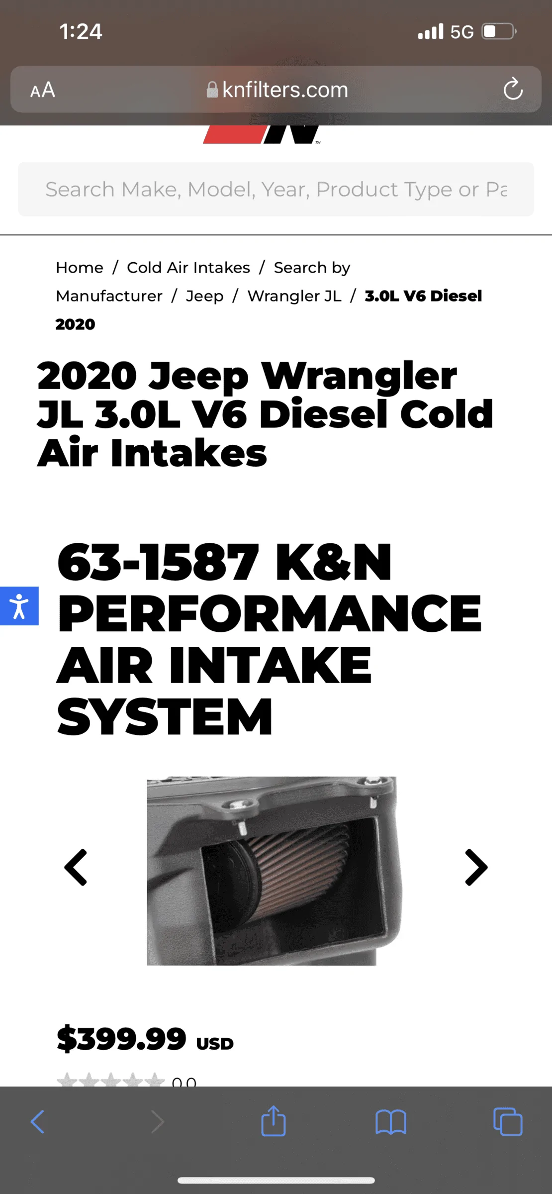

Just saw this on the k&n website for anyone looking for a cold air intake others then aFe
@californiajeeping
Apr 1, 2020
922
933
California
2022 Jeep Gladiator diesel, 1977 cj5 LS swapped
Honestly since this is the only available option I may give it a dry.
If you unbolt the lid you basically have unlimited flow to the filter so I dont see how any other intake will be any "better".

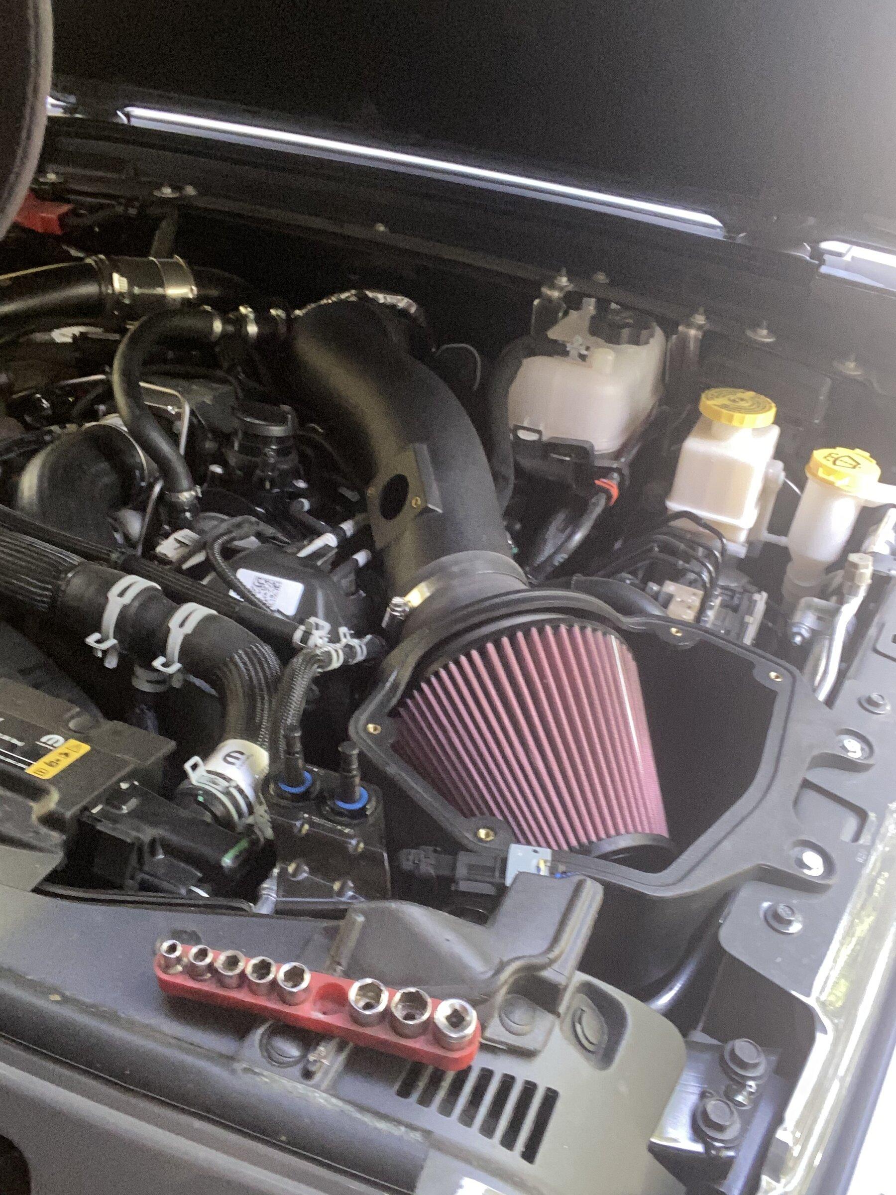

Got mine on. Not much power gain but there is slightly faster spool up.
Way way way more turbo spool noise but once spooled up thereā€™s no difference.
two things.
1: fit and finish are perfect and this thing has a foam pre filter. It breathes through the lid through the foam pre filter. If your worried about Kn not filtering enough you can oil and clean the pre filter often and like a dirtbike it will keep it clean.
2: the crankcase vent tube prodtrudes into the intake tube drastically this is likely to avoid throwing a CEL but either way itā€™s blocking a lot of airflow. We need to figure out if it can be shortened flush with the tube.
