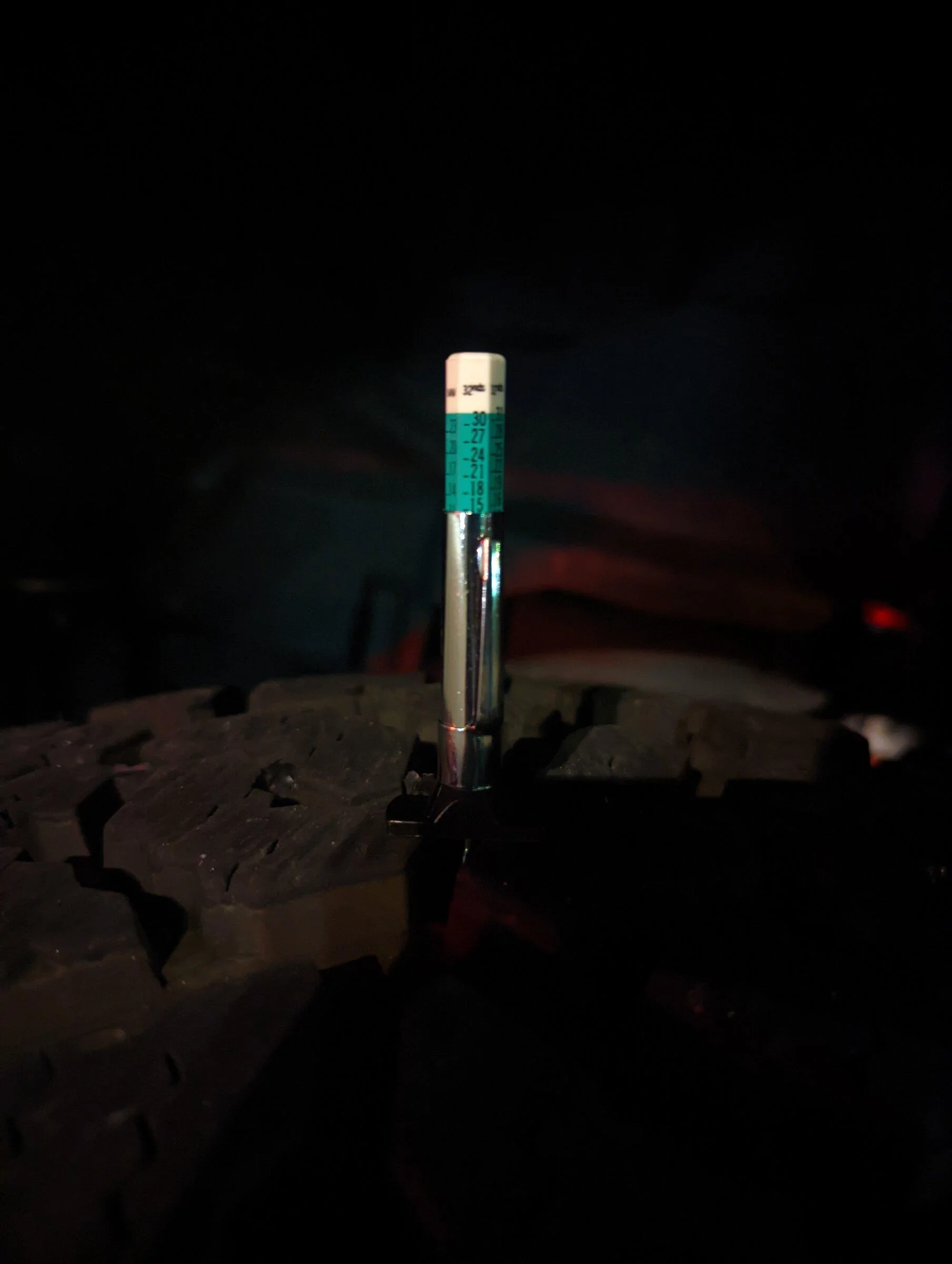

So I'm at just over 7300 miles on these and haven't rotated them yet because I had them mounted about 2,000 miles before my last oil change so I'll rotate them at about 10,000 miles. Specs on Greenballs website say these are 18/32 brand new and they were new when I had them mounted. I'm at 15/32 on all 4 tires front and rear and that seems pretty consistent all the way across the tire outside and inside from and rear both sides. 34psi cold and 36 when they warm up seems to be the sweet spot for these tires as far as how well they ride and wear it seems. I only have $1150 invested in them and I hoped to get at least 40,000 miles out of them when I had them mounted. That seems totally possible if they continue to wear at this rate. Just wanted to give a update. I'll update again at around the 15,000 mile mark.
