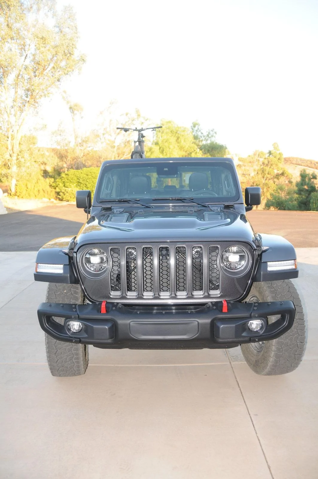

  • Off road pages: So when I first picked it up, I had pressed on the off road page and quickly explored them. While driving off road on the way home, I decided to play with some of the off road capabilities. When I pressed on the off road pages, it would start to open then close. Tried multiple times, and it kept happening. I was in an area with no cell phone coverage so couldn’t try to search for a fix (and didn’t really need them anyway…just wanted to try it out). When I was back home this morning tried it in the driveway and it worked fine.
  • Console buttons: Seemed I occasionally would bump various knobs & buttons while steering or shifting. Again more of a getting use to the vehicle.
  • Audio controls/Apple Car Play: I though when I started the trip I would listen to SXM, and when Google maps had directions it would interrupt the music, give the directions, then go back to SXM. Toward the end of the trip when it would give directions, music would stop following the directions (was switching to phone audio). Haven’t tried it out again after I got back in cell range to see if it’s fixed like the off road pages. 10/8 Update: Tried it again tonight. While giving directions, SXM volume would lower, then return to SXM after it's done giving directions. Must have been a temporary glitch like the off road pages.
  • Spare tire: I removed the spare tire to get the vehicle weighed (see future post below). Took a while to figure out how to remove the jack and lower the tire. Not hard, just stumbled through it the first time getting everything aligned. Recommend trying it in your garage/driveway before you really need to use it.
  • Engine Start/Stop (ESS): I know lots of folks on the forum complained about it. I don't find it annoying at all. Engine restarts before I even have my foot all the way off the brake pedal.

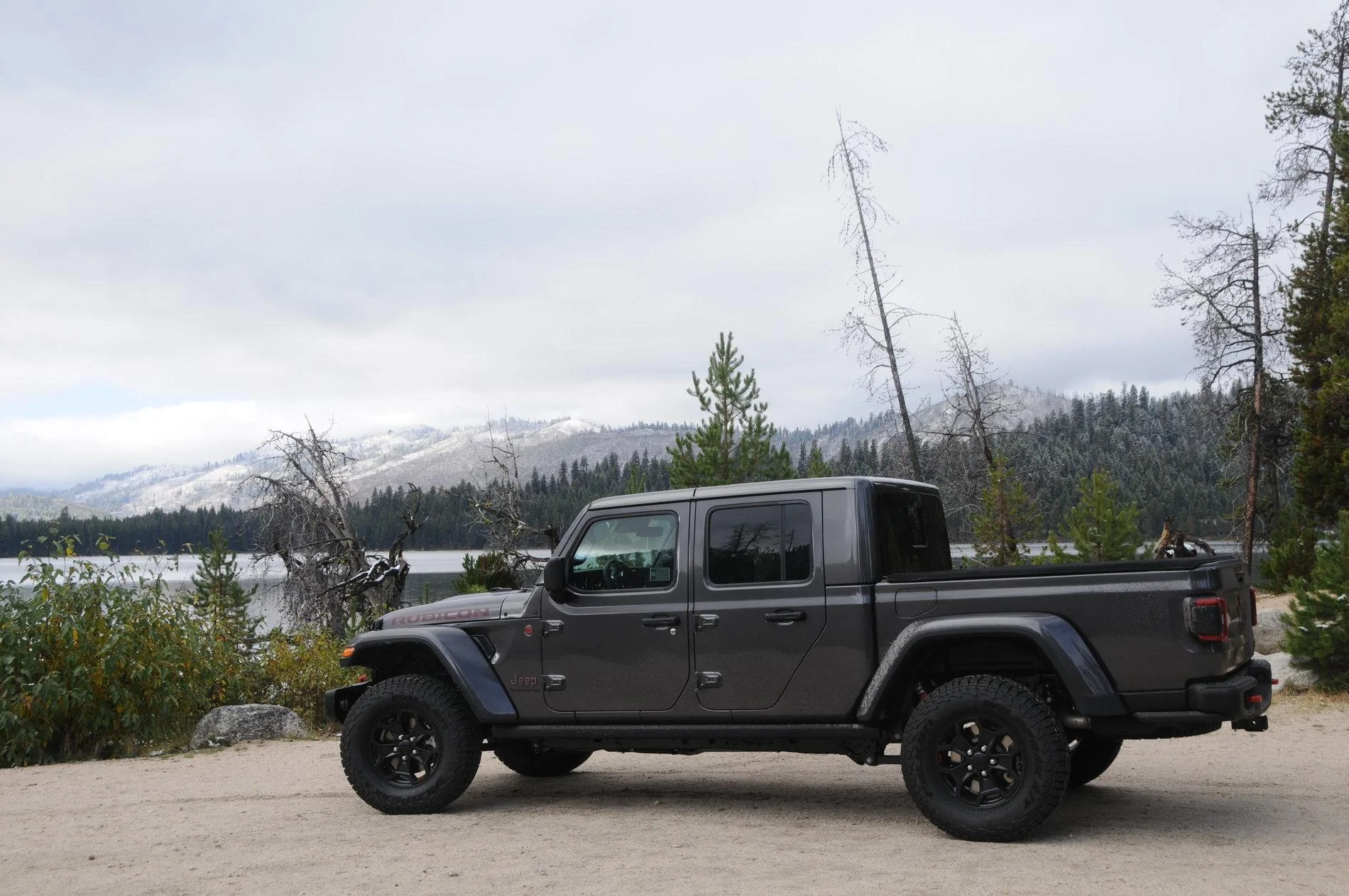

I flew up late in the day on a Monday to pick up my JT from Kent in Nampa, ID (Boise area). I planned to stay at a friends house a few hours north in McCall, ID, but by the time I was heading north sun had set. The drive was interesting getting use to a new vehicle, in the dark, on a windy mountain road while it was raining & lightly snowing. No major issues, just getting familiar with it.
Tuesday I stayed in the McCall area. We decided to go mountain biking in the afternoon once it got above freezing. Rented a bike at a local bike shop and it sure was nice to just throw it in the bed of the truck. Lots of Jeeps in the area, and got lots of thumbs ups or questions when we stopped around town.
Wednesday I started the drive back home. Woke up in the morning with light ice on the Gladiator.

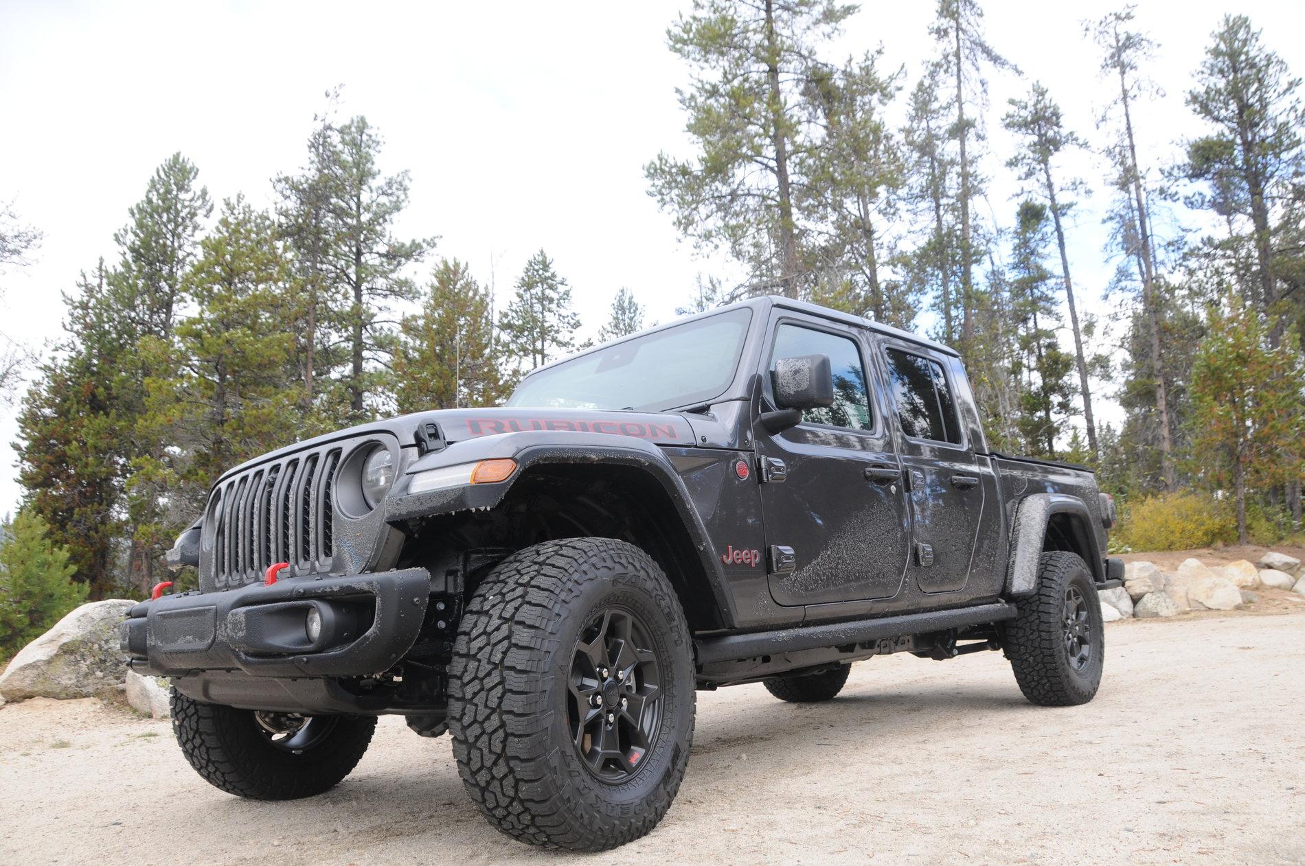

Based on several recommendations, I headed south to Cascade, ID then took a fire road over the Sawtooth Mountains to Stanley, ID. First stop was Warm Lake.
Climb up from Warm Lake.
Spent more than an hour on a dirt or snow covered dirt road. This handled the road with ease and when dirt only I could hold 50 MPH easy.
Thursday took me from Ely, NV back home to the San Diego area. Temperatures varied from 15F west of Ely to 85F in Death Valley/Trona.
Goldfield, NV was an interesting town for photos. Looks like they are working on a bypass around the town so this could be a town that is completely missed if you are driving along 95 in the future.
I peeled off 95 at Beatty, NV to cut through Death Valley.
I spent a bit of time playing around off road at the Trona Pinnacles, then stayed off road through the Spangler Hills OHV area. Even did a quick drone video while at Trona.
It looked less Granite and more Gobi by the time I finally got home. Fortunately the desert dust washes off. I should point out that some may say the roll-up tonneau cover is water proof, but it definitely isn't dust proof. This is what it looked like when I got home. I had the freedom panel bag in the bed. The bed was covered in dust, as can be seen when I pulled the bag out.

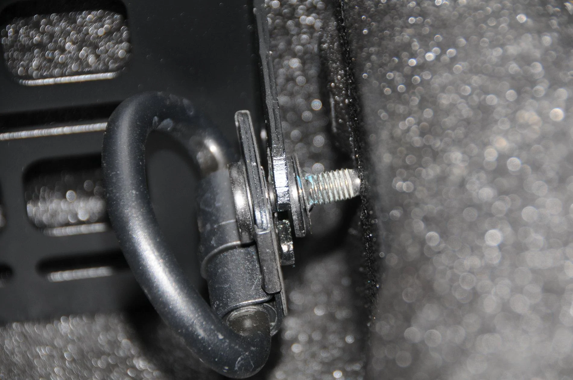

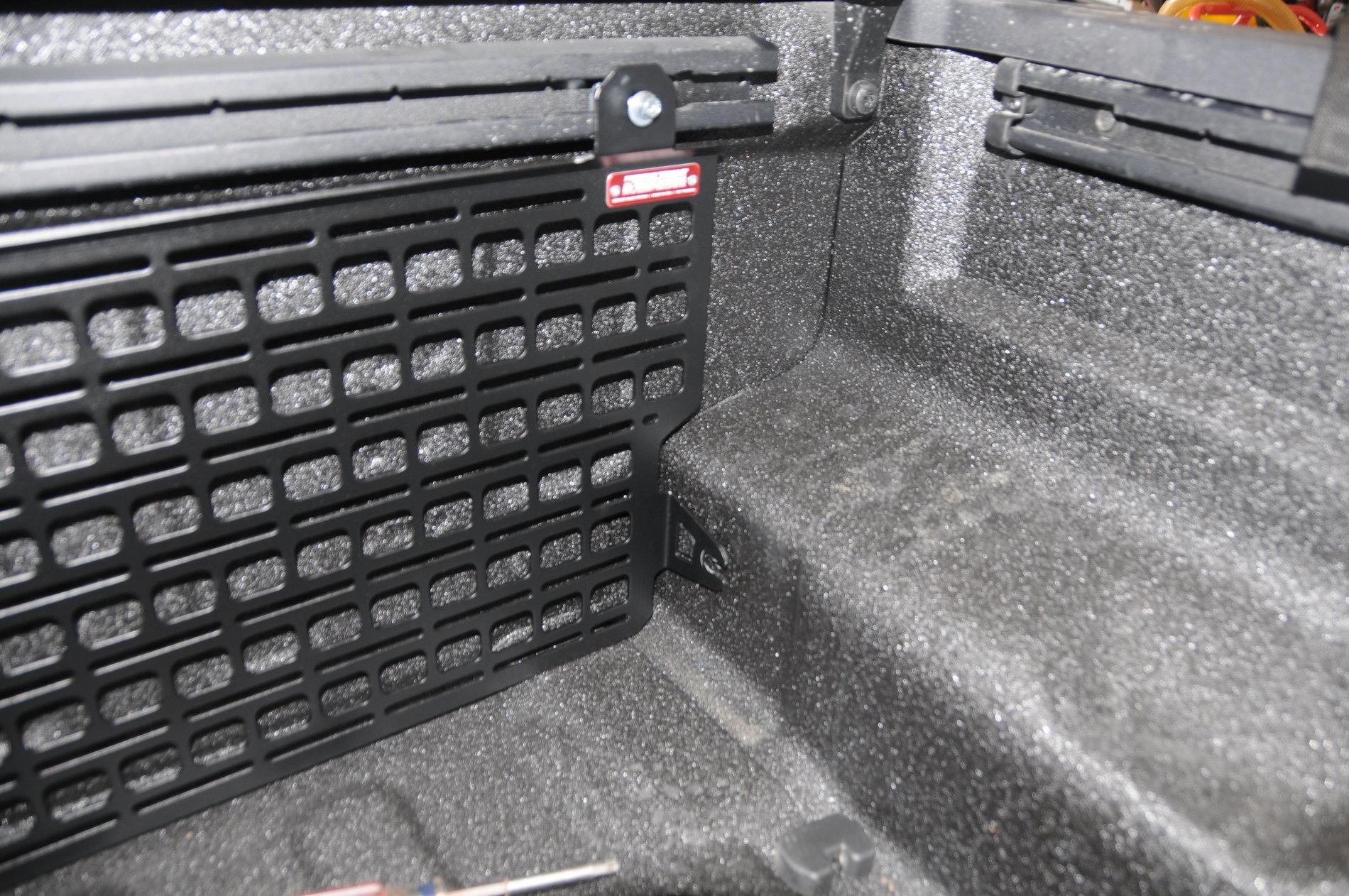

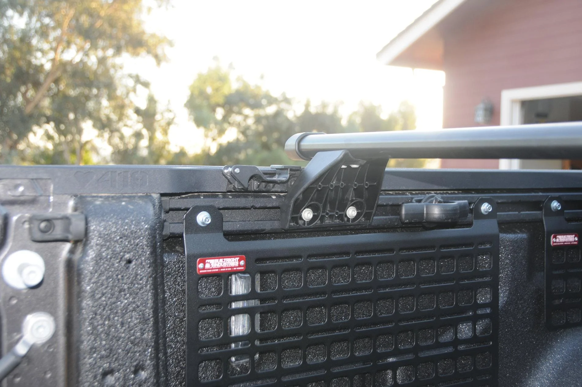

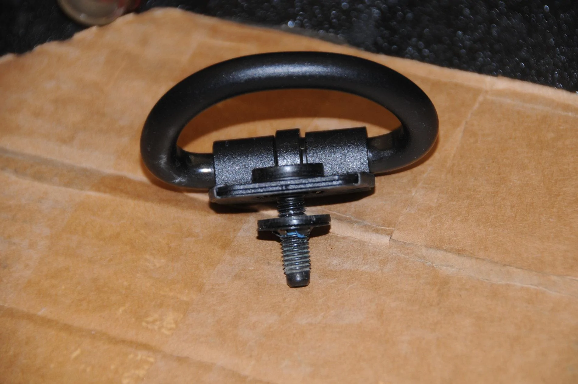

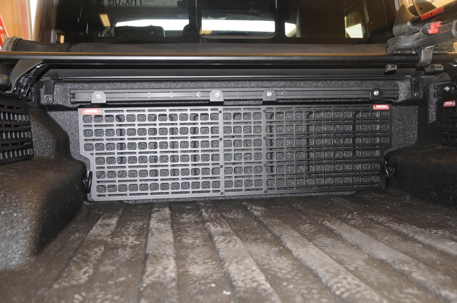

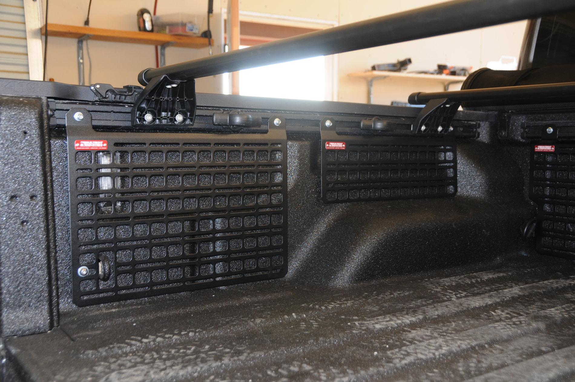

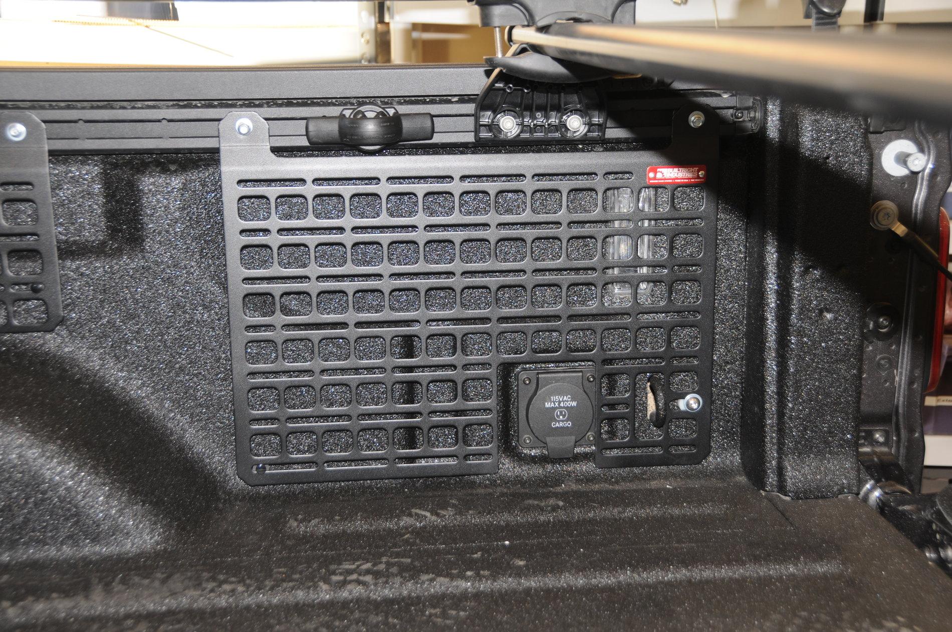

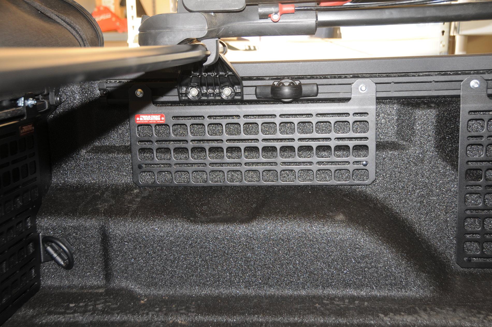

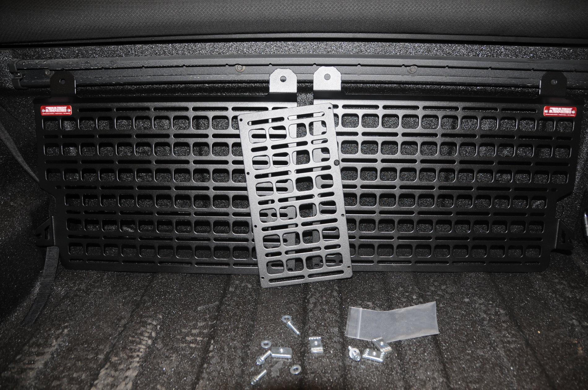

@BuiltRight Bedside Rack Install
The side rack panels arrived several weeks ago (while still waiting for my JT to arrive). I also have some clamps & rotopax attachements to add once I figure out how I want to arrange things. When I came back from my road trip picking up my Gladiator, there was another @BuiltRight box with the front rack ready to be installed on my new JT!
The rack install went on pretty simple. I remember Matt sent out install instructions when the side racks were shipped, but didn't bother trying to find them and could put these on without the instructions.
The front panels are shipped in 3 pieces. Short piece in the middle goes behind the two side sections since it's tapped for the fasteners. One issue I had was figuring out how the factory tie downs work with the side sections. At first I removed the tie down and tightened it over the side section bracket, which seemed to twist the bracket. I found that moving the lock washer a bit and sliding it into the slot on the bracket fit into the side of the bed much easier without twisting the bracket.
The side panels went on super easy. Tried to install the lower rear nuts solo, but ended up getting my son to come and help tighten the bolts while I held the nut plates in place. Right now I have the short side panels removed while I played with the cross bars, and moved the rear panels back a touch so that the tie downs/115V outlet are centered in the panel cutouts.

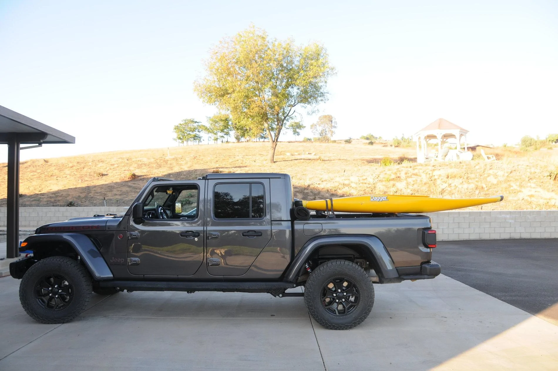

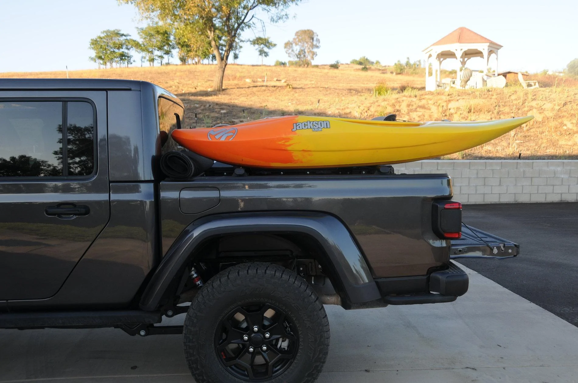

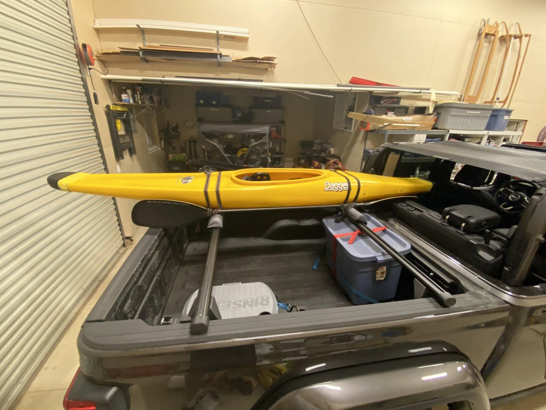

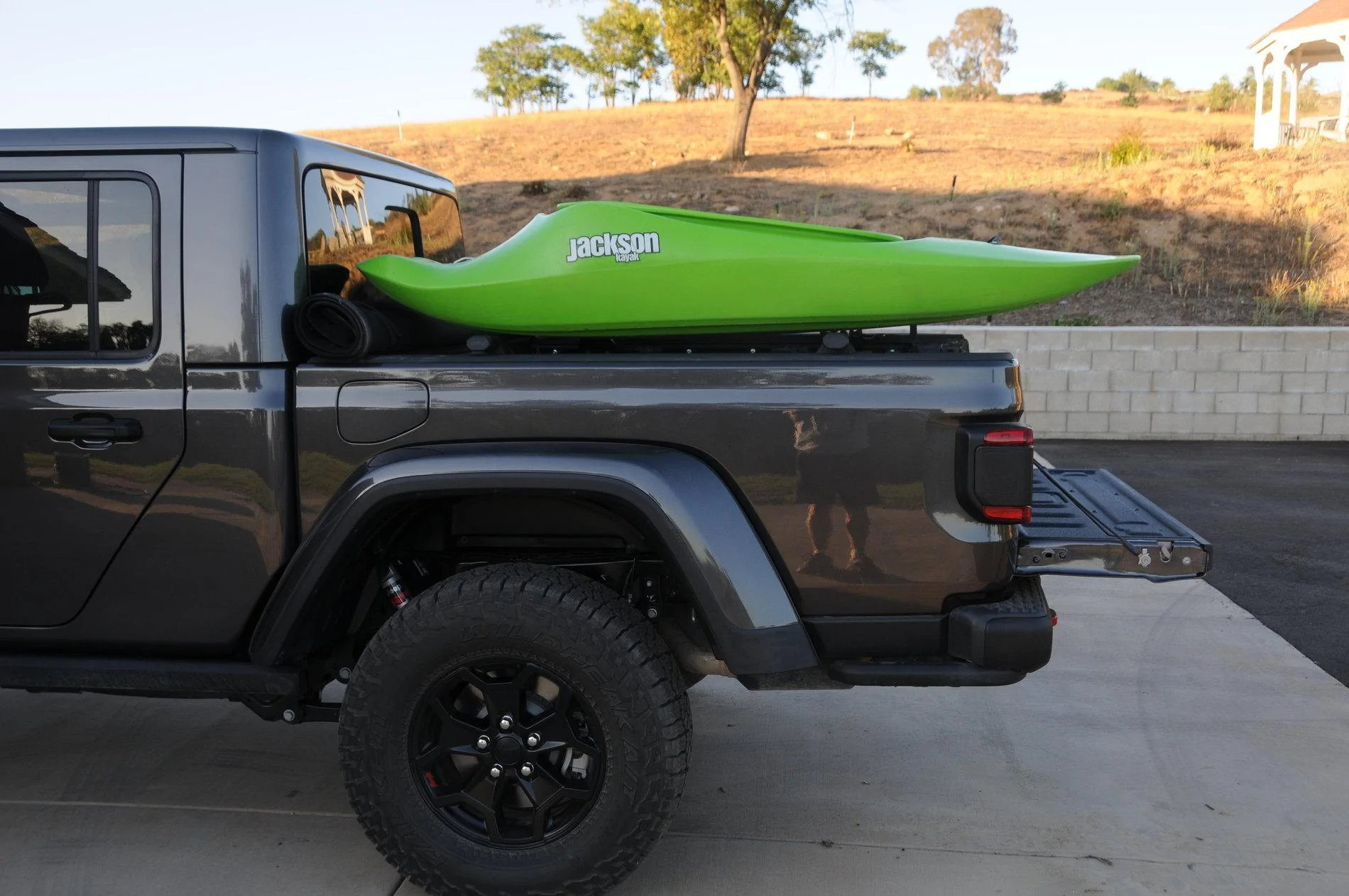

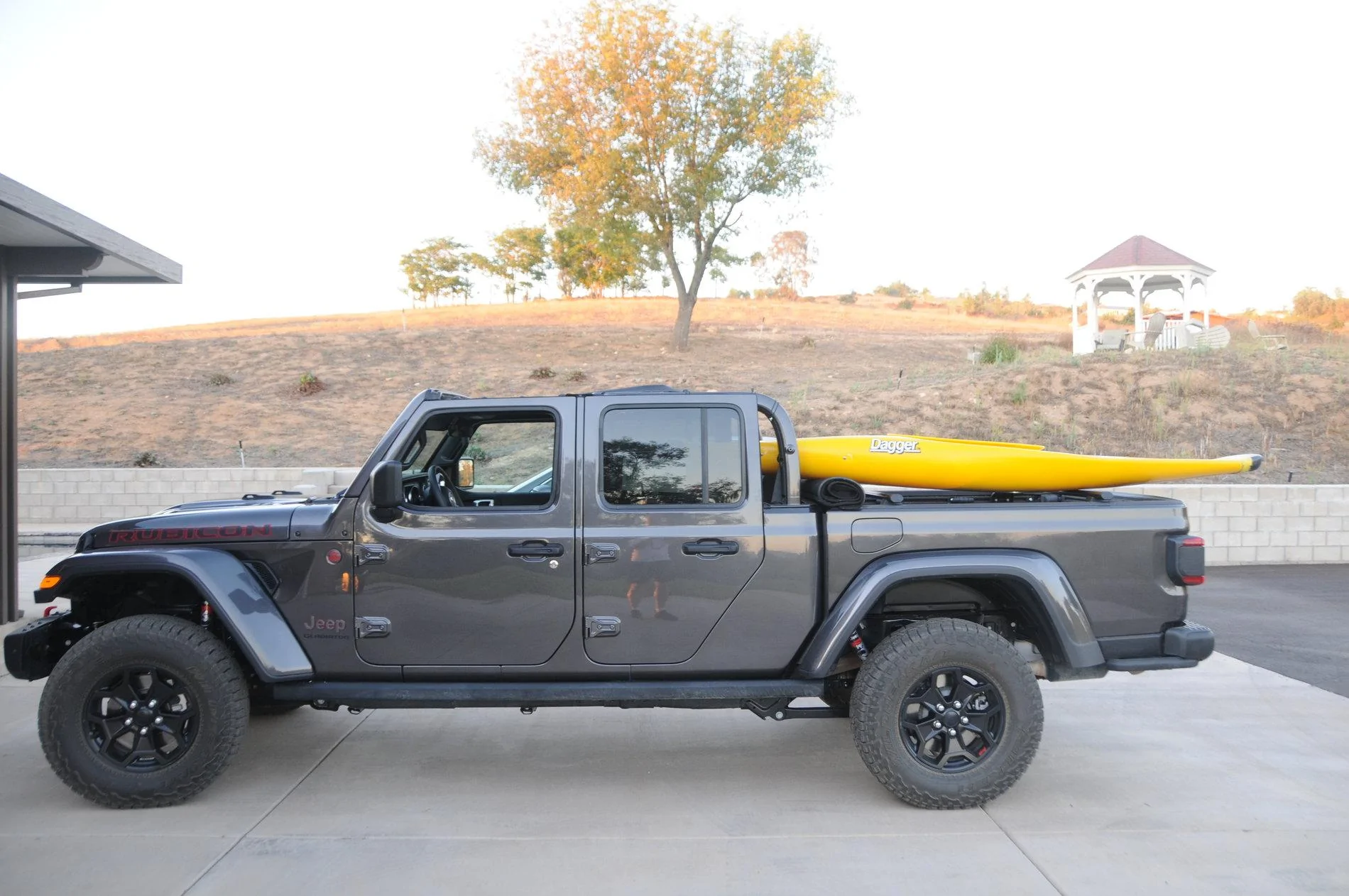

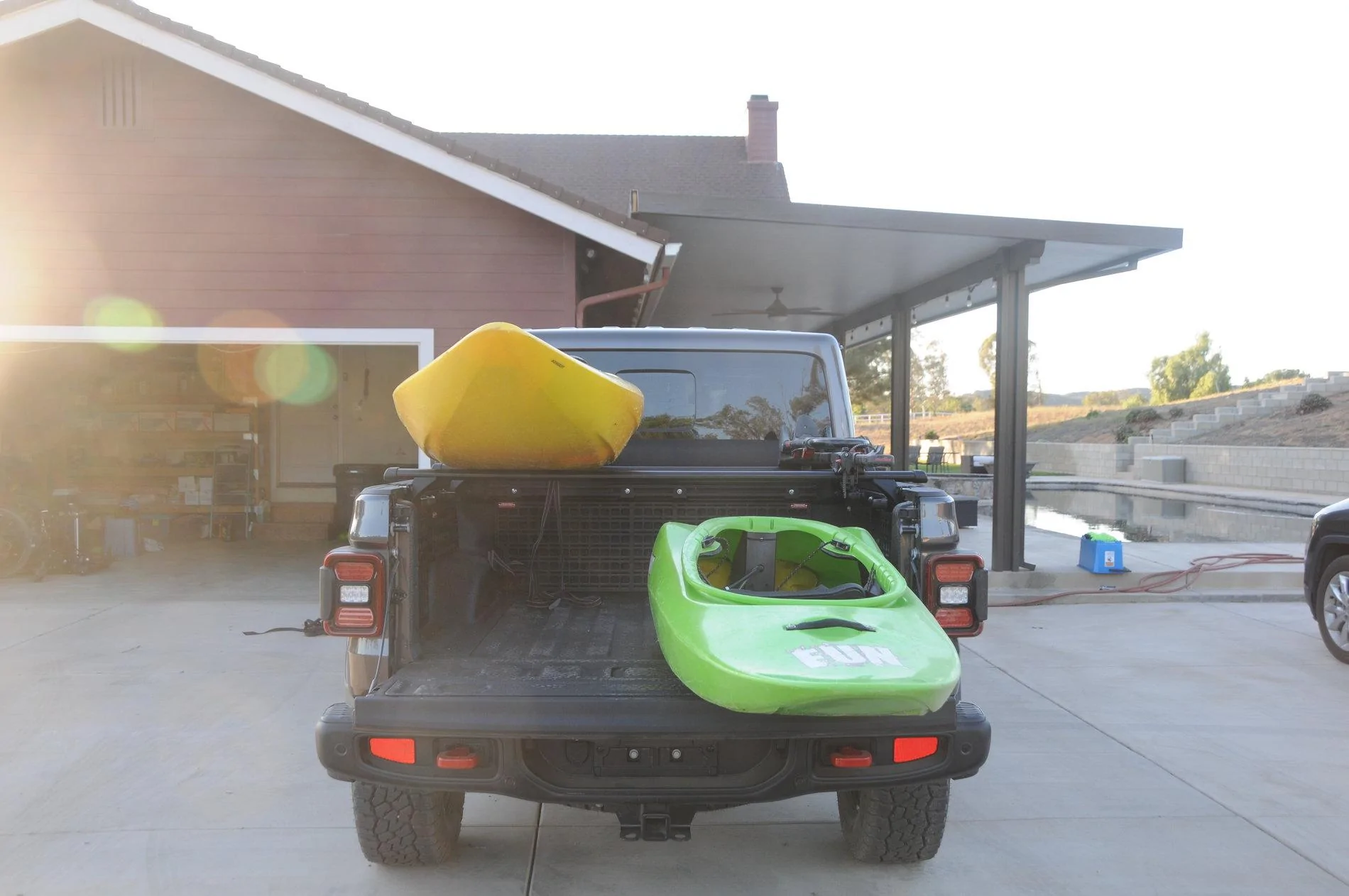

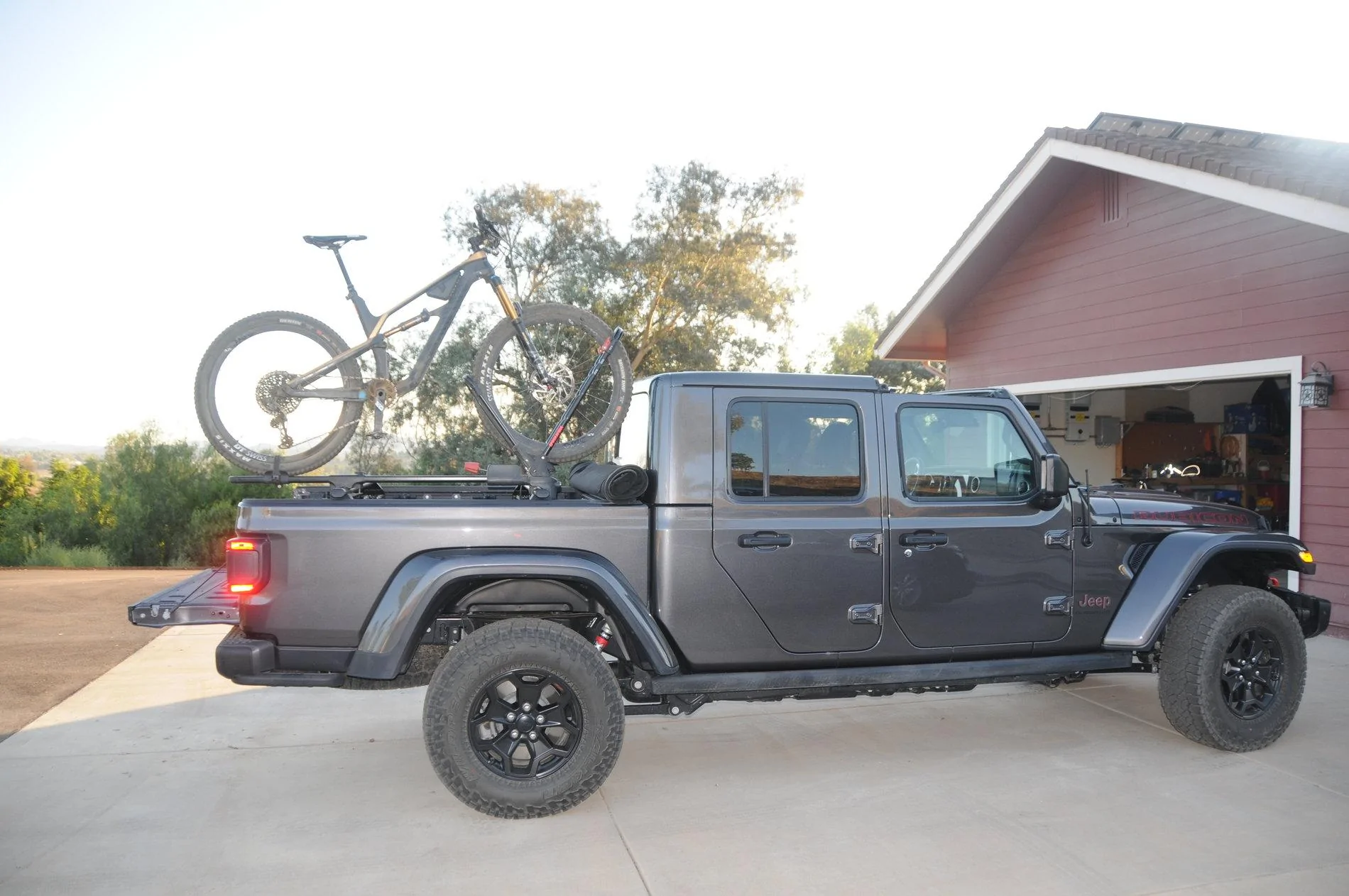

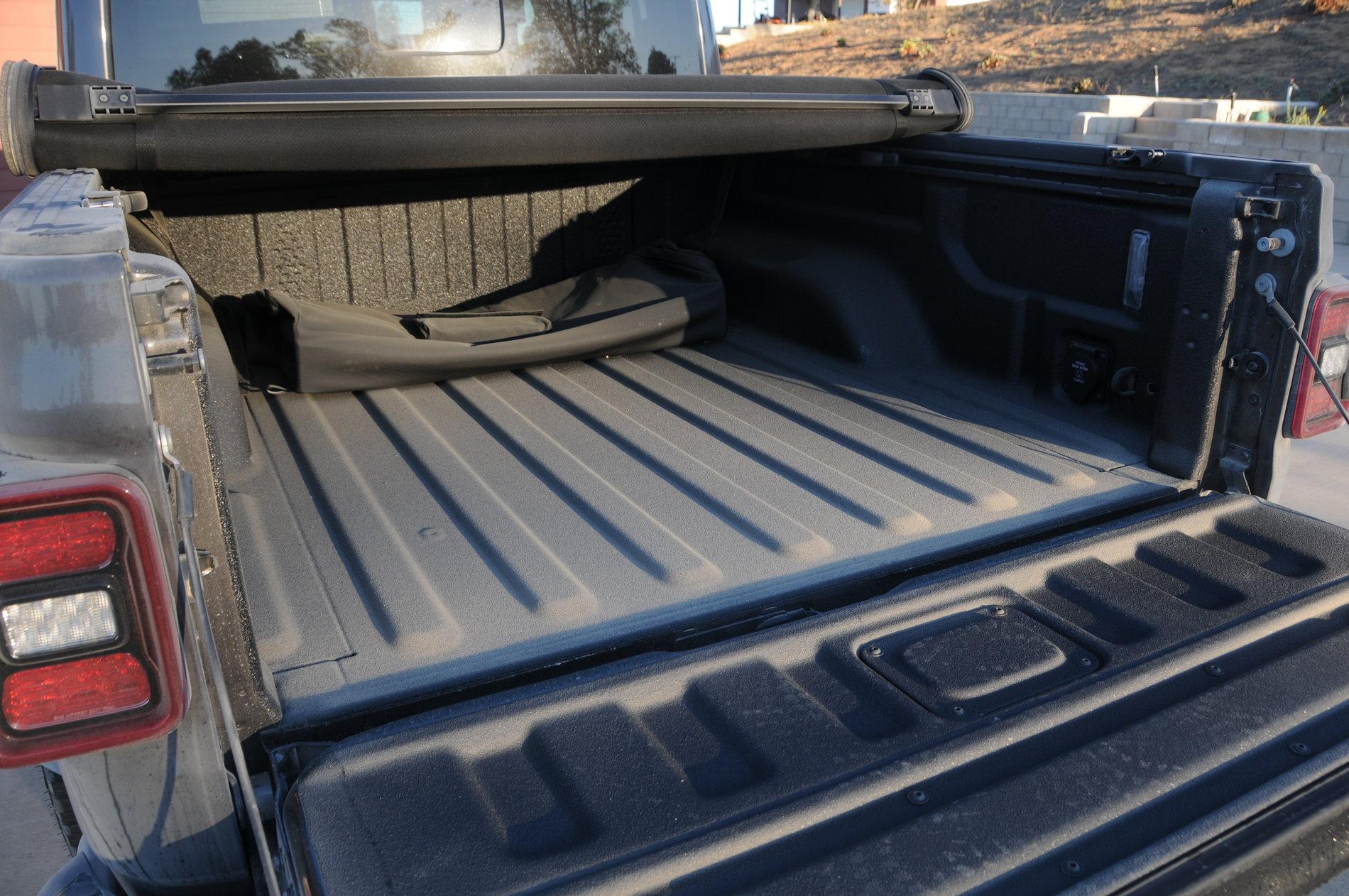

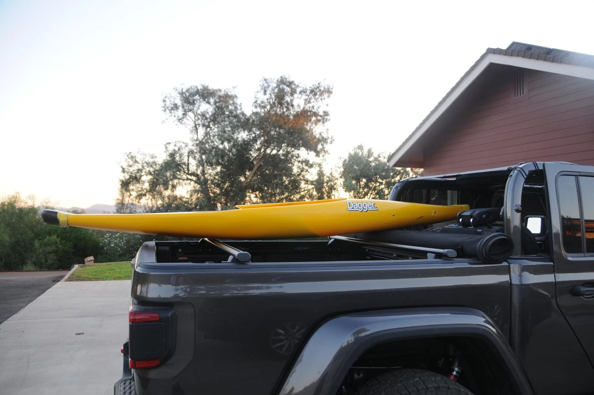

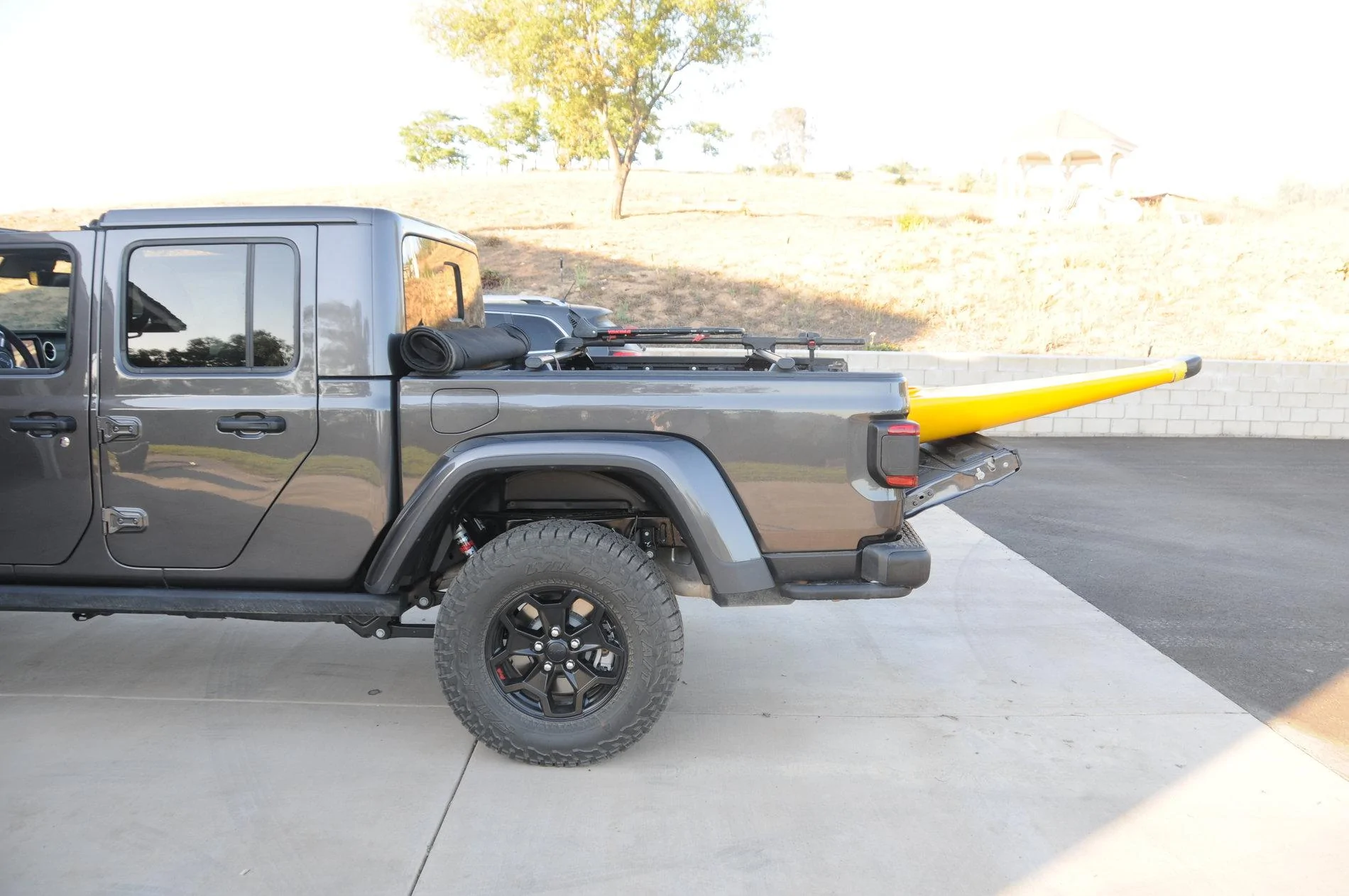

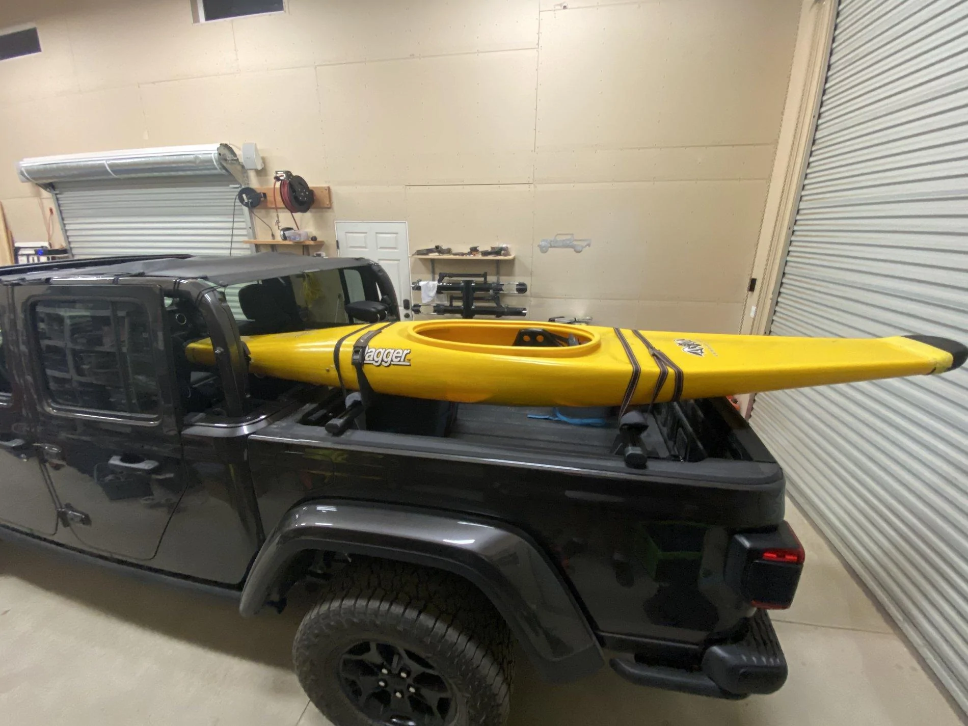

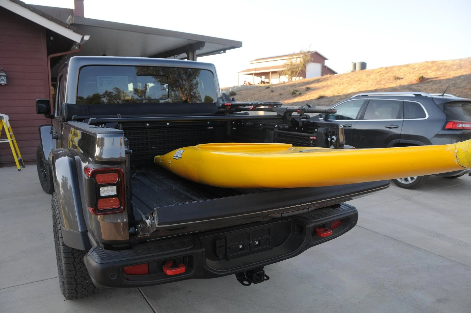

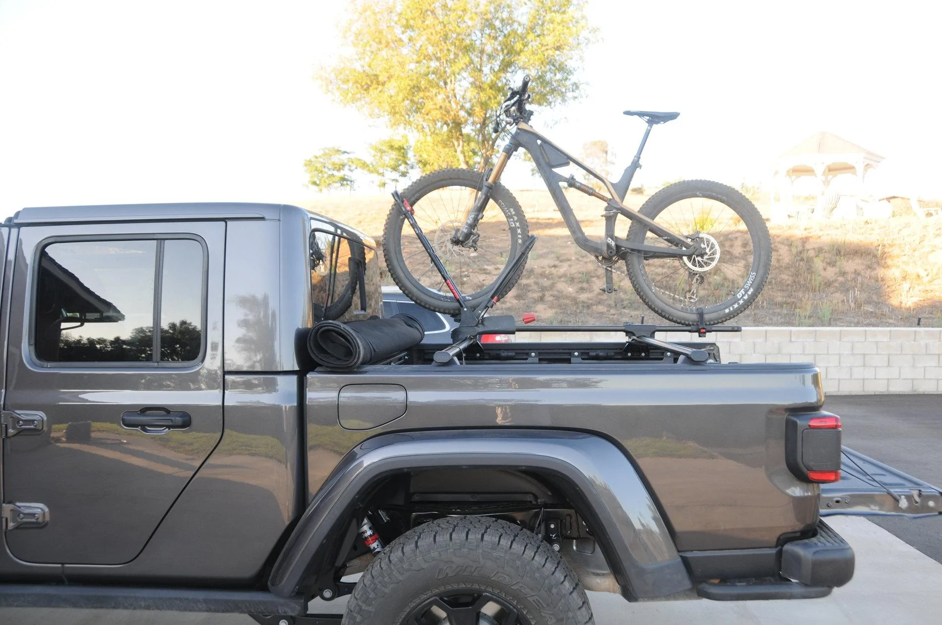

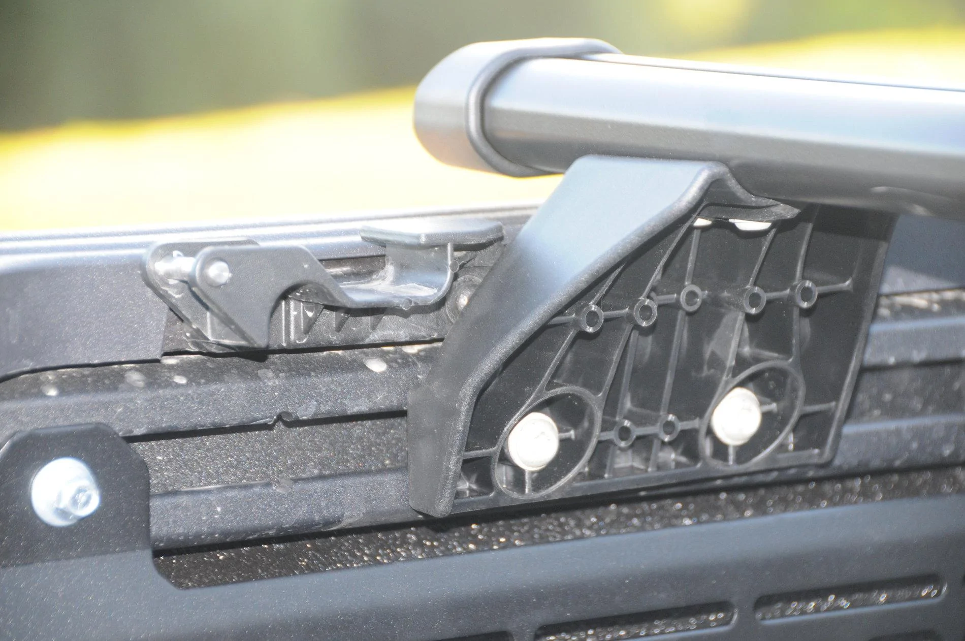

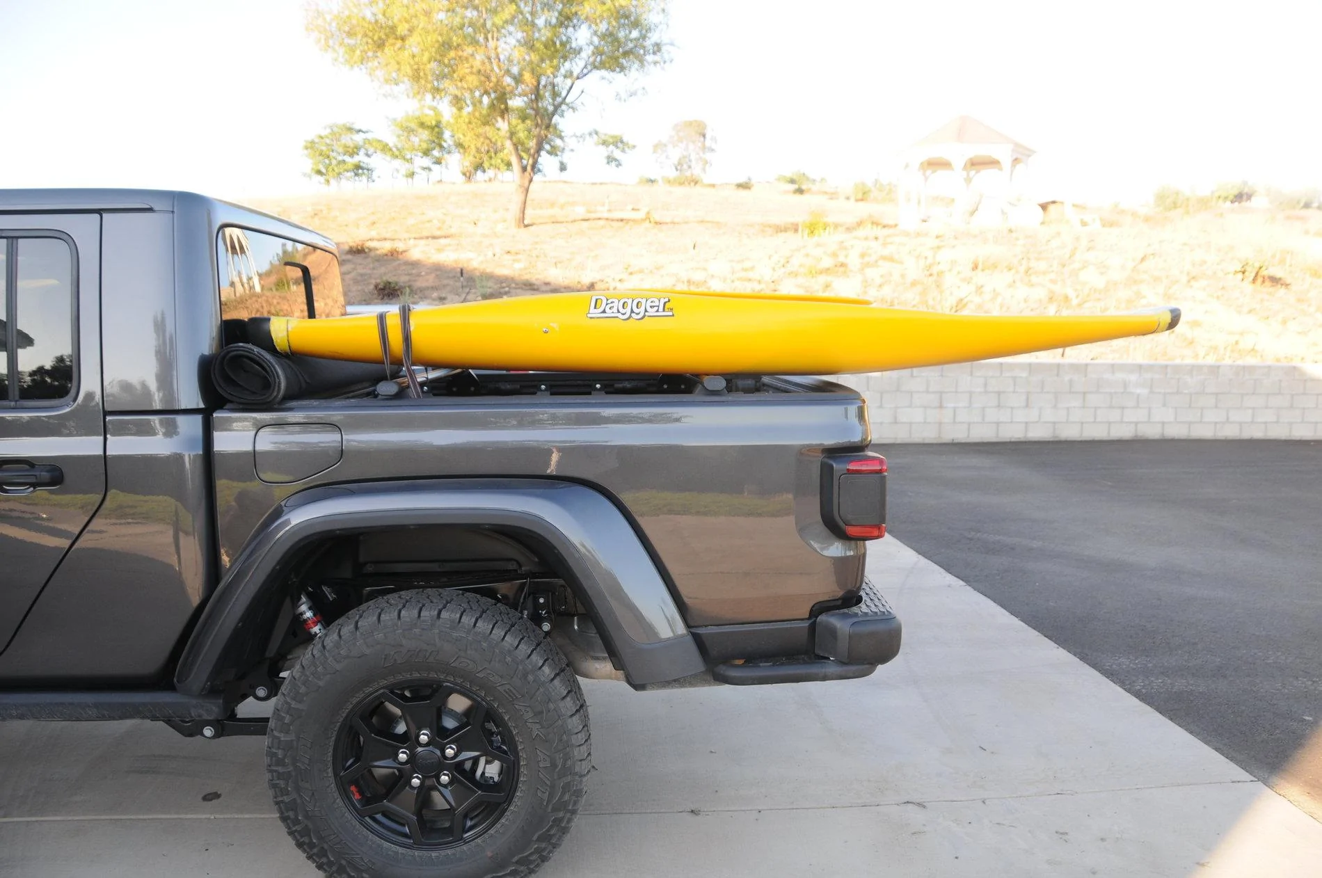

Mopar Cross Bars with Kayaks and Bikes
One of my biggest concerns with the JT is mounting kayaks. With my old Grand Cherokee, I had to climb on the seats, tires, or use a door jam step. With the original JT marketing photo, it looked like we might be able to mount short kayaks in the bed of the JT. I had bought the Mopar cross bars several months before I got my JT, so was eager to try it out with some of my kayaks.
The limitations I see with these Mopar cross bars are the following.
  • The front cross bar needs to mount several inches from the front of the bed. The trail rail system has about a 2" cutout on the front end of the rails to allow for sliding in the racks. Unfortunately that mean you can't clamp down an accessory there. Not really a limitation since I don't see a need to have a cross bar right behind the rear window.
  • Bigger issue is placement of the rear cross bar. Because mine came with the roll-up tonneau cover, there is the latching bracket at the rear of the bed. This limits how far back the rear cross bar can be mounted. If I remove those brackets, the rear cross bar can mount aft another 3" or so. I also have the @BuiltRight bedside panels installed, but I don't think these will limit moving crossbar back much because of the bed sides get wider in the far aft position, which would also limit how far back the the rear cross can go.
In the photos below, there are 3 different kayaks:
  • Lime green one is a Jackson Fun (Gen 2) playboat. It's 6' 6" long.
  • Yellow/orange one is a Jackson Antix M downriver kayak. It's 7' 9" long.
  • Yellow one is a Dagger VampireBat kayak polo boat. It's 9' 9" long.
The photos below show mounting options for the kayaks. Both of the shorter Jackson kayaks work OK on the Mopar cross bars, and I would be able to fit both of them side by side on the rack (didn't since I had put a Yakima bike rack on the right side for now). In these photos the nose of the kayak is less than an inch from the rear window, so may not be desired driving longer distances. I use these kayaks mostly for whitewater, which means only a handful of trips a year. I think both of these would still work with a receiver mount bike rack.
We usually play kayak polo in Mission Bay in the summer. Last session is tonight, so I was eager to see how I can mount it. After I sold my Grand Cherokee about a month ago, I had a rental Nissan Frontier. It also has a 5' bed, but had no internal tie down points. I only used it one week, and hauling a nearly 10' boat in a 5' bed was awkward.
With the Mopar cross bars, the kayak polo boat doesn't really work with the top on. Of course, this is the setup I'd probably want to use most often. I had to tie down the nose just to keep the kayak from pivoting off the rear cross bar. Maybe removing the tonneau cover latches would help a bit.
By then I could remove the rear cross bar (and probably the front cross bar) and just use the tailgate like I did with the Frontier. I tried that too by putting the tailgate in the middle (plywood) position, and this would probably work OK. This is probably how I'd haul with the top on.
Sunday I pulled the top off. For polo tonight, I decided to try the polo boat on the cross bars again. Sticking the nose into the rear seat area, the kayak rests better on the cross bars. It did sit on the rolled-up tonneau cover rather than the front cross bar.
I then proceeded to remove the tonneau cover, which is done really easy with just removing 2 #50 Torx bolts. I did fold down the drivers side rear seatback. This is how it's attached today, and was solid on the drive to work today. The nose is sticking about 12" into the rear seat area. The @BuiltRight bed side racks provide a lot more tie down options for gear in the bed. It's also nice to be able to strap down the kayak without climbing up to a roof rack.
I also looked at putting one of my Yakima bike racks on the cross bars to see how they would work. Cross bars would be great for this application. Only issue I had was my Yakima rack rear tire strap isn't long enough for my newest mountain bike, but this isn't a JT/rack issue.
I'm not completely sold on the Mopar cross bars. I'll try them out over the next few weeks and see if I want to keep with this setup. Long term I may look at the Yakima OverHaul HD rack system to mount kayaks over the cab.
