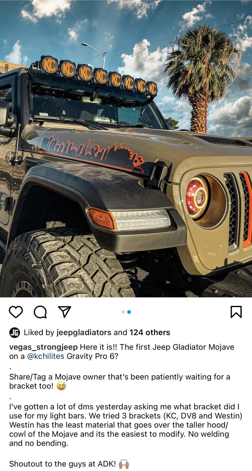

This guy on IG just installed that light bar with a westin bracket. This actually looks great. Called KC and they told me they are working on a pro6 bracket for the mojave but it wont be out until the end of the year. Im just thinking of going this route in the mean time.

Go rhino brackets fit perfectly.
