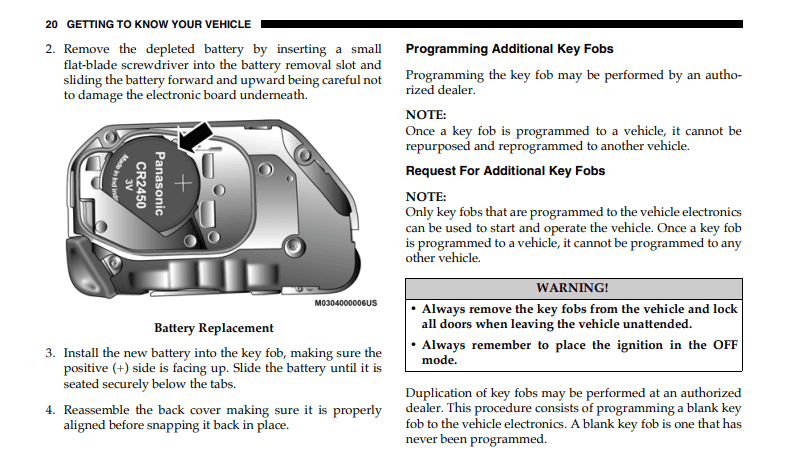

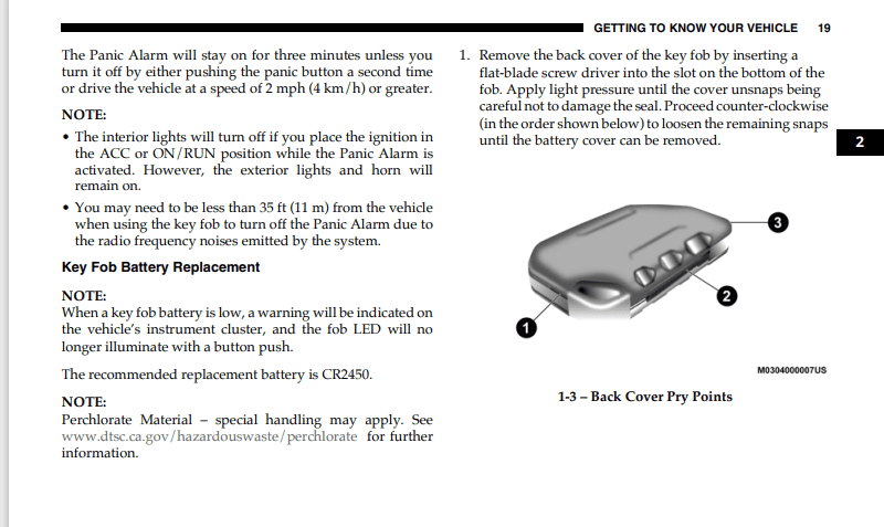

I'll give that a shot...if I can get the effing things apart :LOL: :LOL::LOL:
I tried yesterday to open one up to see what battery it takes and it's like trying to open King Tut's Tomb 😳😳😳 couldn't get it open 🤬🤬🤬
I'm thinking of just taking them to the stealership to get it done.

That could be real expensive for what is.
Right next to where a key ring would go through the hole in the silver part you'll see a slot that is wider than the rest of slot running around FOB. Small straight screwdriver inserted in slot and twist screwdriver. Then cuss when all the guts come flying out after it pops open.

Same issue when attempting to replace the fob battery. There are a couple YouTube videos showing the trick to get the case open. I just Googled "jeep key fob battery".
