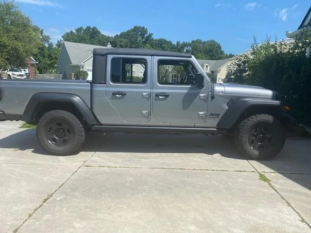

I just went from 35 inch tires to 37s on my max tow yesterday. I have a 2.5 inch lift in front and a 3/4 spacer in the rear
and its a little closer fit than i would like. I also added Rubicon fenders a while back.

Max tow has the wider axles which helps prevent rubbing on turns. I chose 255-80-17 which are 10 lb lighter than the Rubi size, narrower--at the same width as the stock max tow tires, while being 33.1" spec height, slightly over the Rubi size and about 1.5" over the original size. I think they are the "safest" oversize to keep most of the tow rating.
now thats an interesting tire size pick! Ya mind throwing up a picture of them from the side and front?
