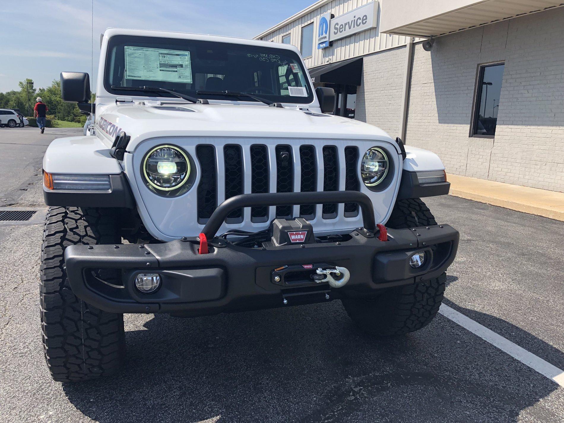

Not a LE, but a Rubicon.
Jeep Gladiator launch edition on 35’s no lift FE9FFE60-22EC-4014-AE36-A413DC23AD8D
Jeep Gladiator launch edition on 35’s no lift E3A017BE-7AB0-427B-B436-08BE735A9E8E

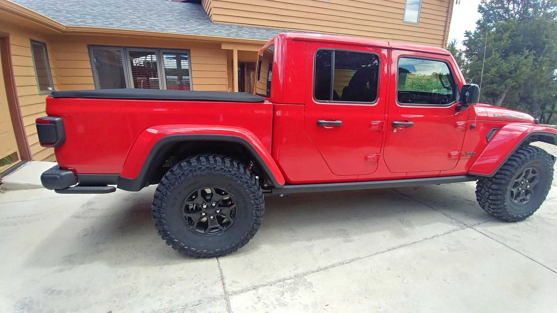

Launch edition on 37's no lift yet waiting on RK to deliver

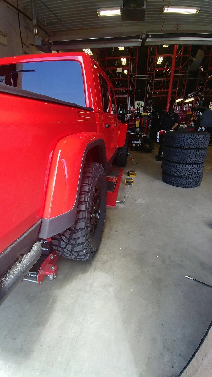

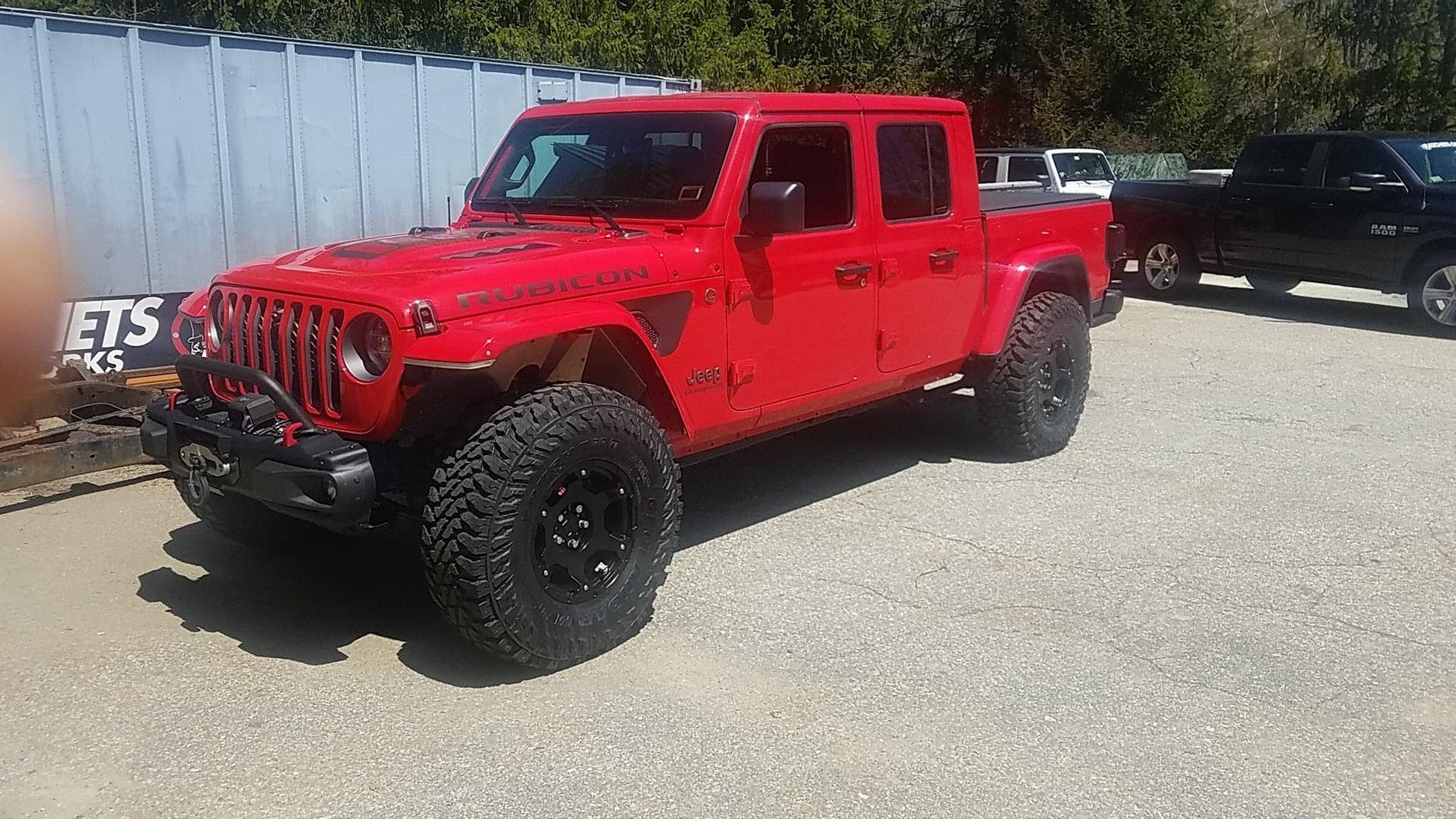

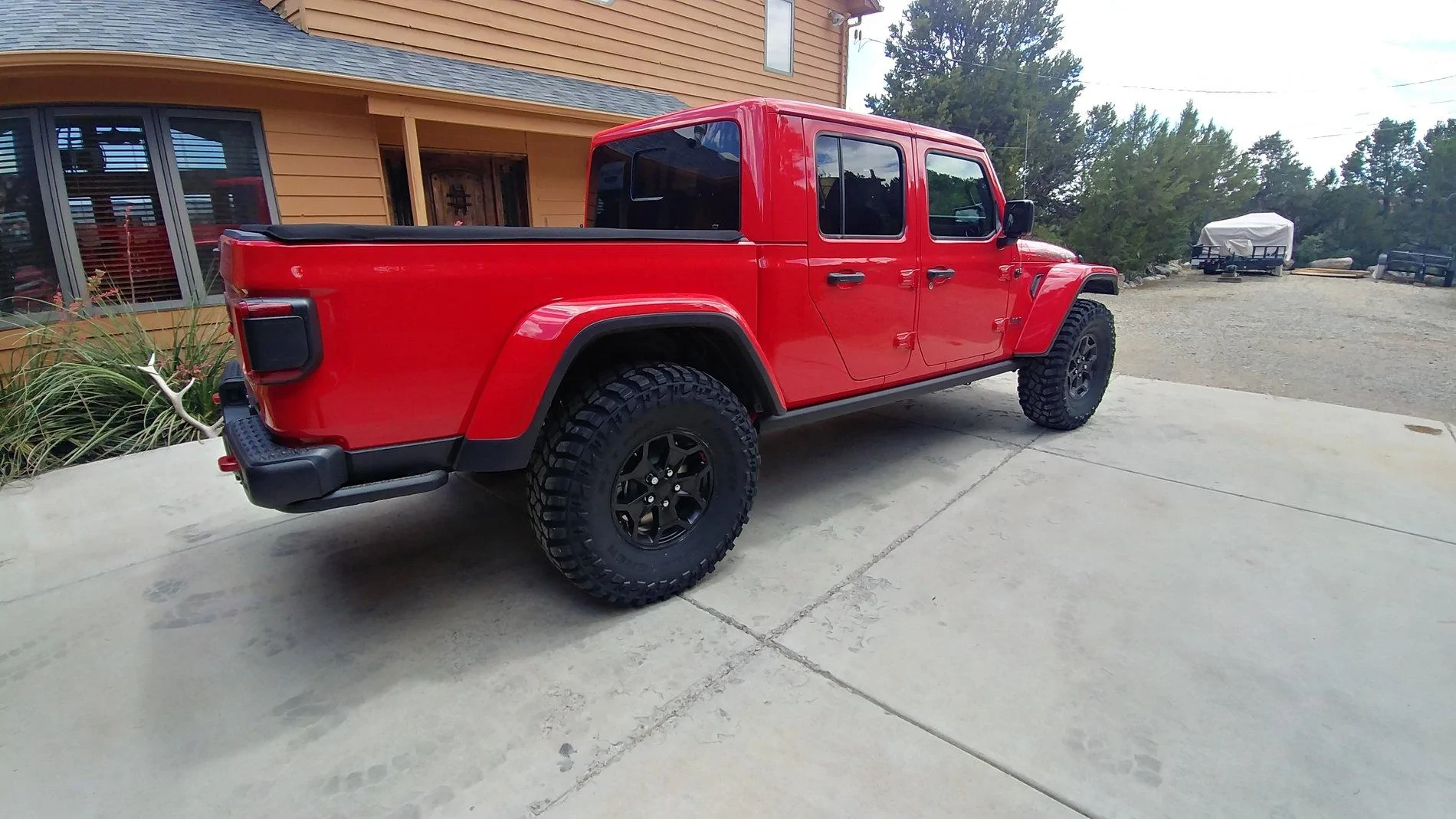

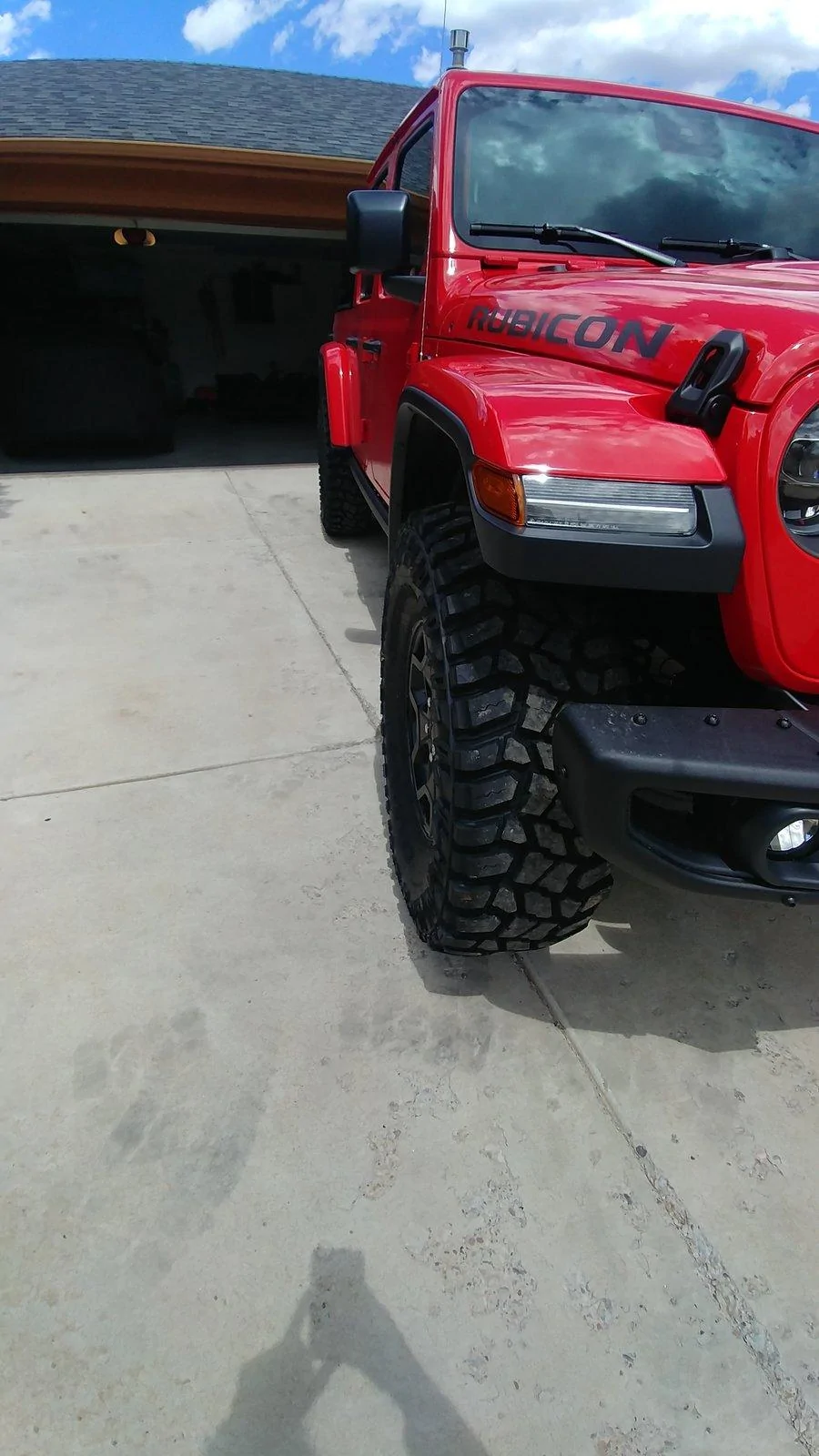

What is the offset on your wheels and when does it rub on 37s with no lift?
Lorenf303
Loren
Apr 23, 2020
Denver
2020 Gladiator Rubicon, 2013 Camaro 2LT RS
retired

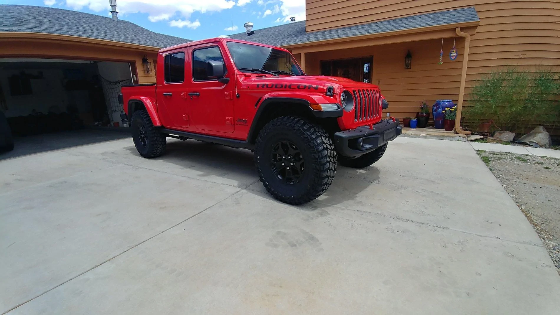

So your tires are 35x12.50r18? 18” wheel right? No issues???
Yes, I went with 18's with a +1 offset. No issues and love the look.
