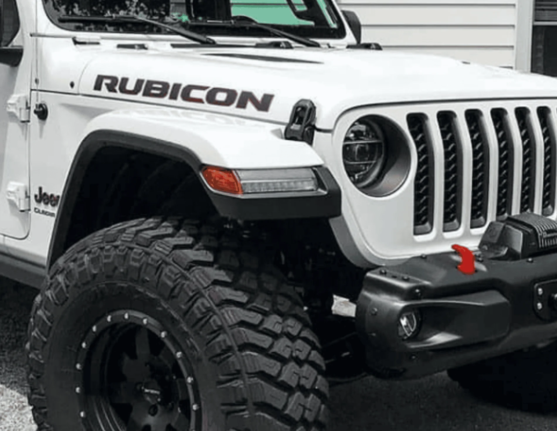

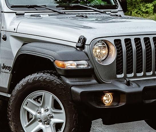

Edit: based off pictures, they are not the "high" fenders. I've attached pictures highlighting the difference. The Rubicon flares appear to be about an inch or two higher and have a notch cut out for the hood latches. However, American Adventure Labs does have a kit that fits Sahara JLs and I'm pretty sure those are the same design as mine.

The highline fenders will work 'IF' you can separate your fenders in two. Please keep us updated as many of are curious about the fenders on the Max Tow Package. Both front and rear.

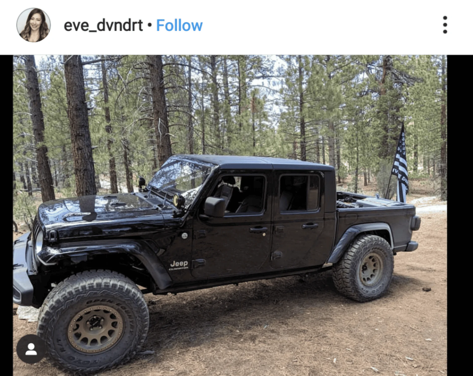

Update: I spoke to several people who are running 2.5" lifts as well as someone at Evo and they all said the same thing -- by "trimming" the fender flares on both the Overland and Sport S w/ Max Tow, you can run 37s off-road.
In short, I'll be trying it for myself. Feel free to look for updates on my build thread (linked below) and on my Instagram (@smokymountainoverland). I will try to remember to post on this thread as well!
I've also included a photo of an Overland with a 2.5" lift, 37s, and the American Adventure Labs fender kit. The username is visible, so go check her out on Instagram!
