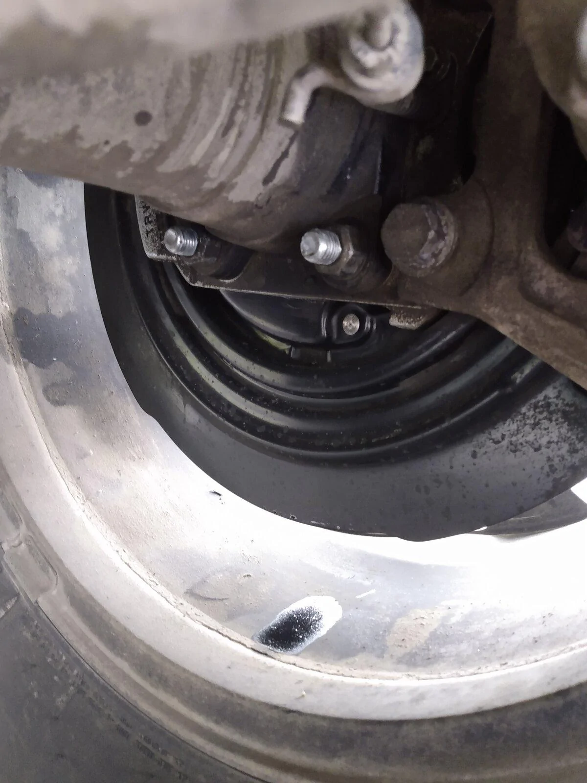

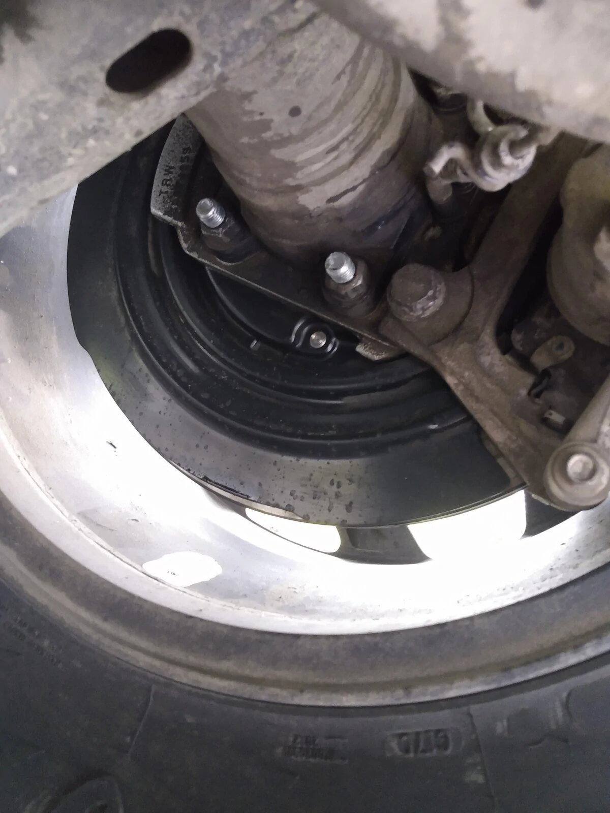

The part came in and got the Jeep "fixed" Monday. When I picked it up it already looked like there was a drip happening.
Woke up to this.
Looks suspiciously like another leak 🤦🏼‍♀️

Either they did a shitty job cleaning up or that didn’t fix the leak👎

My husband and I both looked at the seal area when we came back to the shop to get it, and they definitely did not clean it initially. Must have misplaced their funnel that day. I wouldn't sign their paperwork until it was cleaned and I told the service team that it looked like it had already been leaking... "Oh that's just over spray of the cleaning products"... Sure guy 🙄 I already sent the pictures to my Jeep Wave case manager. Guess we keep getting shit parts until there is a recall 🤷🏼‍♀️

When I discovered my leak it was about 1000 miles after my free Jeep wave oil change. They rotated my tires at that time. I found oil all over the inside front tire. This tells me the leak was there when they did the service. It should have been identified then but nothing was said by the techs. I highly recommend everyone who had a repair thoroughly inspect and demand its cleaned before leaving

Mine was fixed at 750 miles and they seemed to clean it up well visually, but a couple weeks later there was a layer of axle lube and dust on the back of the brake shield, but no active leak like before into the rear of the rim. I washed it off with dawn soap and gave it a good cleaning at the carwash with degreaser and rinsed it all thoroughly and has been nice and dry since. Maybe some residual from repair? A few others had the same issue for a few weeks after repair until they cleaned it up really well themselves.
