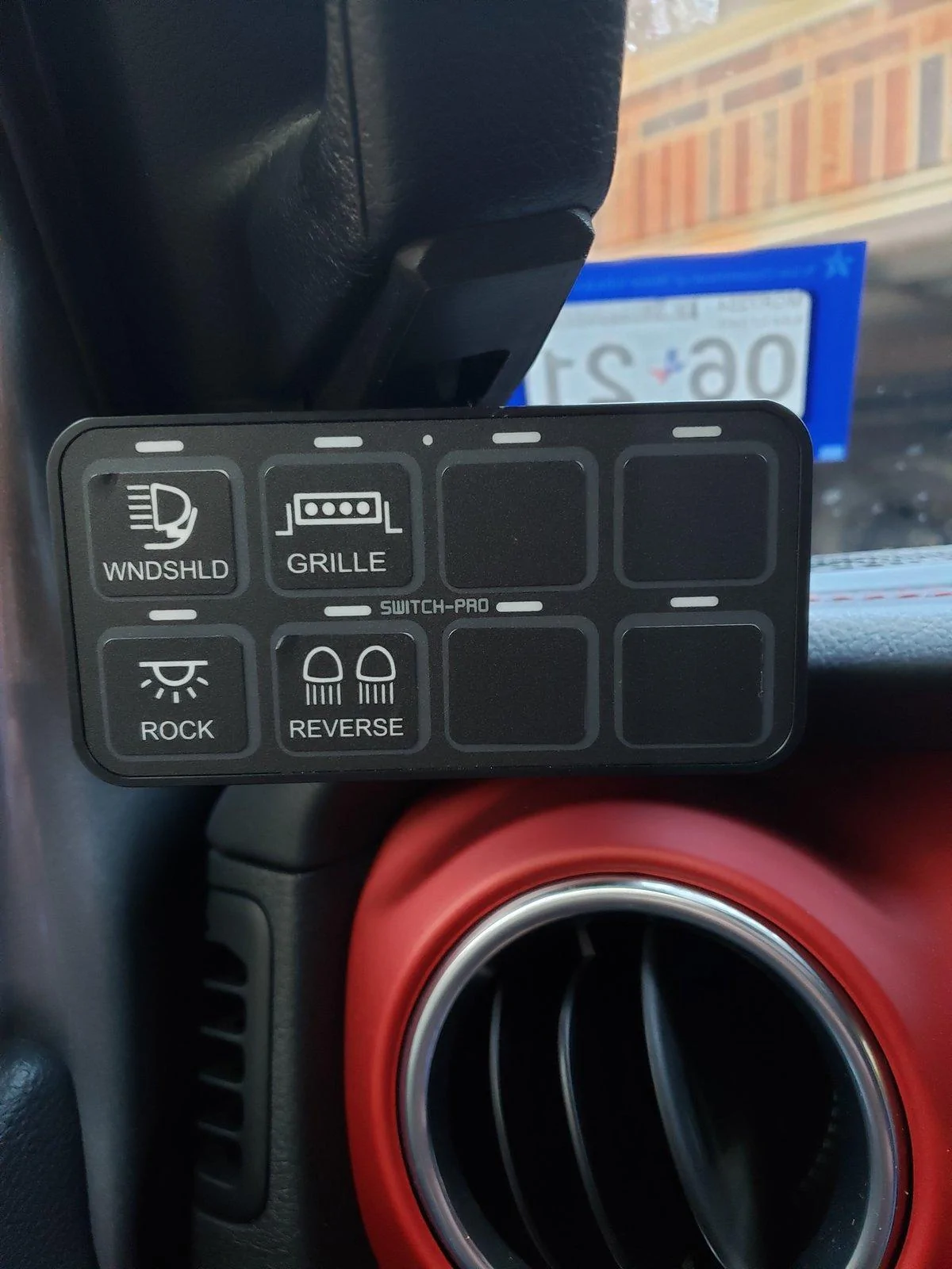

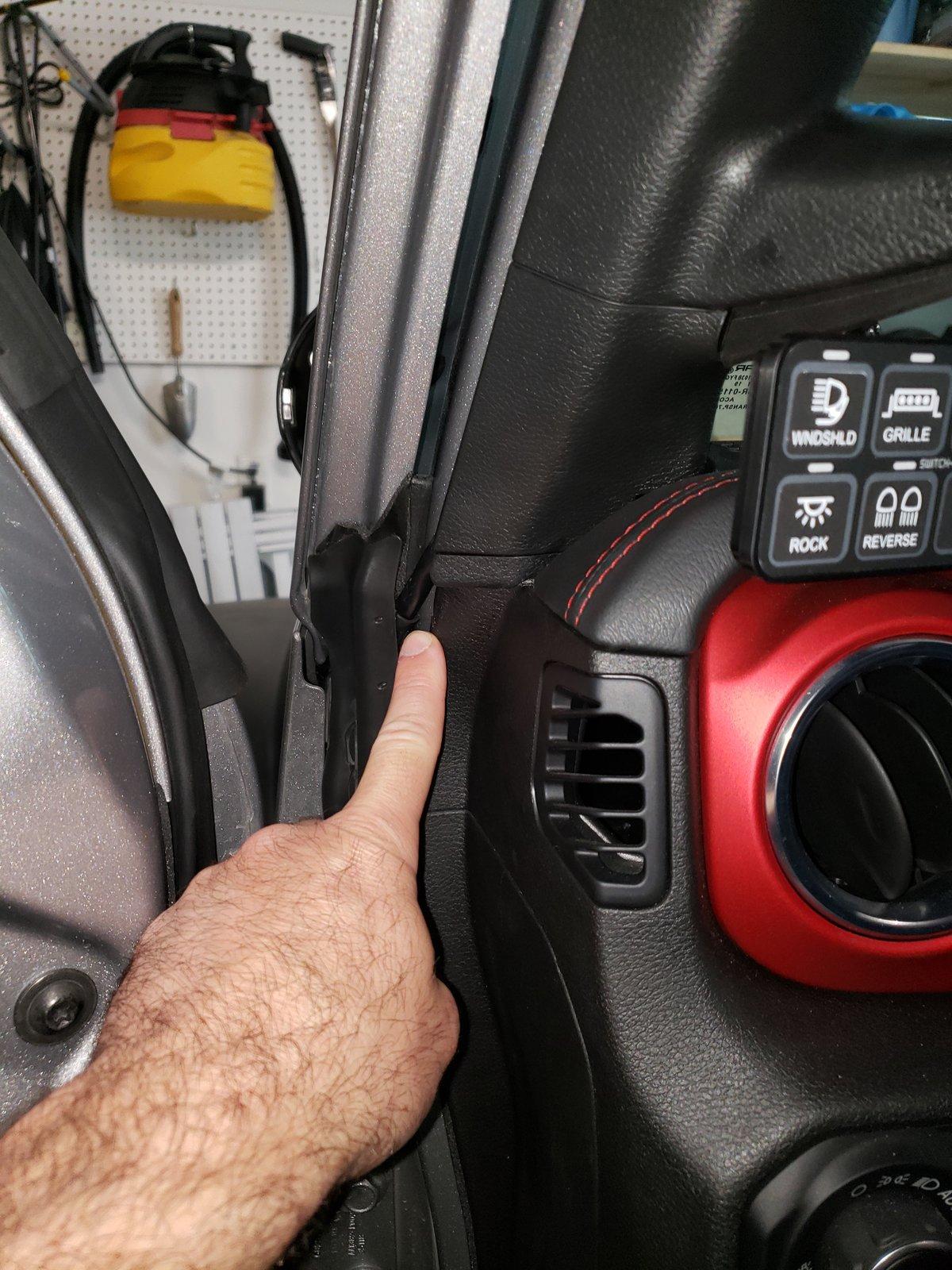

I just installed the Switch Pro over the weekend. You can see how I ran the wire into the cab...behind a piece of rubber trim. Sorry, not the best pics. Before I had the Switch Pro, I had wired a single switch the same way.
