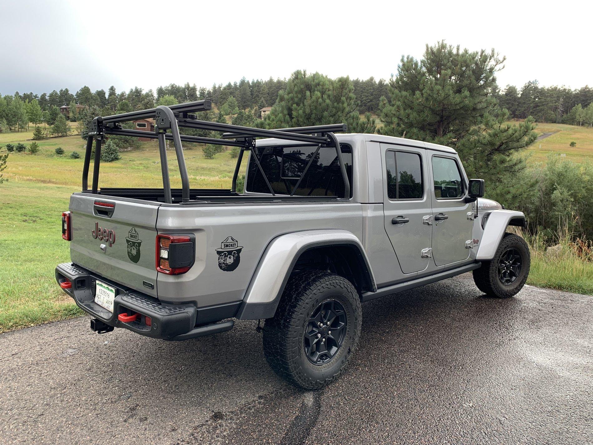

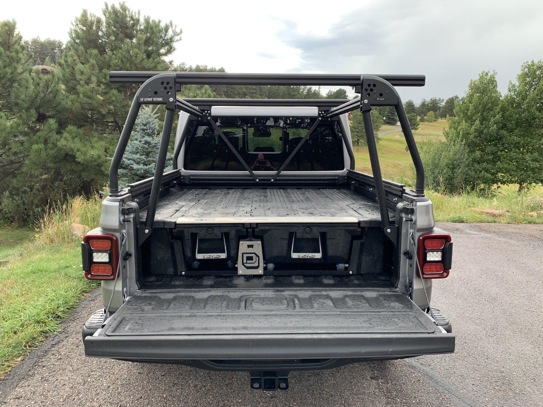

I’ve added a few extras to my Gladiator, iKamper goes on tomorrow!

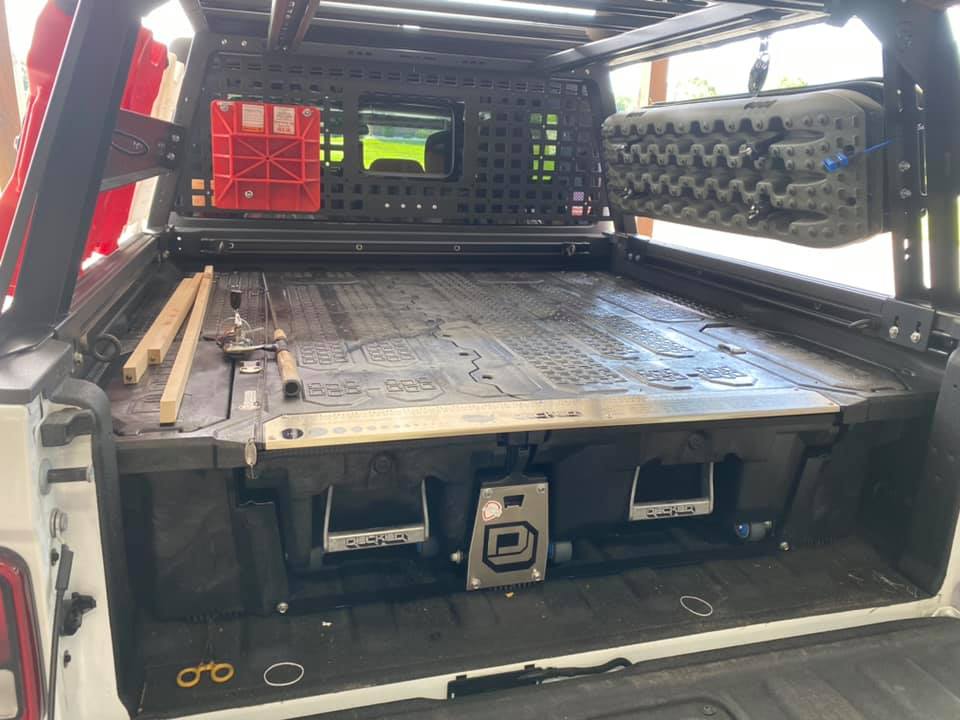

Awesome! Can you tell me the measurement between the top of the Decked, and the bottom of the front-rear rails? And also the distance between the bottom of the front-rear rails and the top of the cross rails?

The depth of the Gladiator bed is exactly 17.5" from the top of the bedrail to the bed itself. The DECKED system is exactly 12" tall, so this will leave you right around 5.5" to the top of the bedrails.
Thanks @theDECKEDguy I’m looking for between the top of Decked and the bottom of the Leitner rails to see if Leitner is going to work for me or not.

So you mean the top of the rack? Sorry for the confusion.

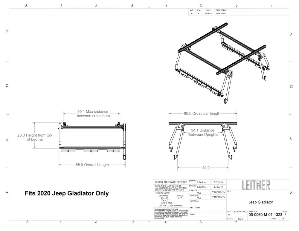

No worries. I’m looking for between the top of the Decked and to the bottom of the Leitner rails. The Leitner website shows 23” to the top of their cross bars from the bed rail. The side rails (that go front to back) sit lower than that, and I don’t know how thick their rails or cross bars are.
Funny enough, we happen to have a Leitner rack sitting out back of the office. I just measured it up. the side rails are 2" thick and the crossbars sit 3.5" up from the top of the side bars.
So in short,
DECKED system sits 28.5" down from top of cross bar
DECKED system sits 25' down from top of side bar
DECKED system sits 23" down from bottom of side bar
So in short,
Thank you! This is exactly what I needed.
