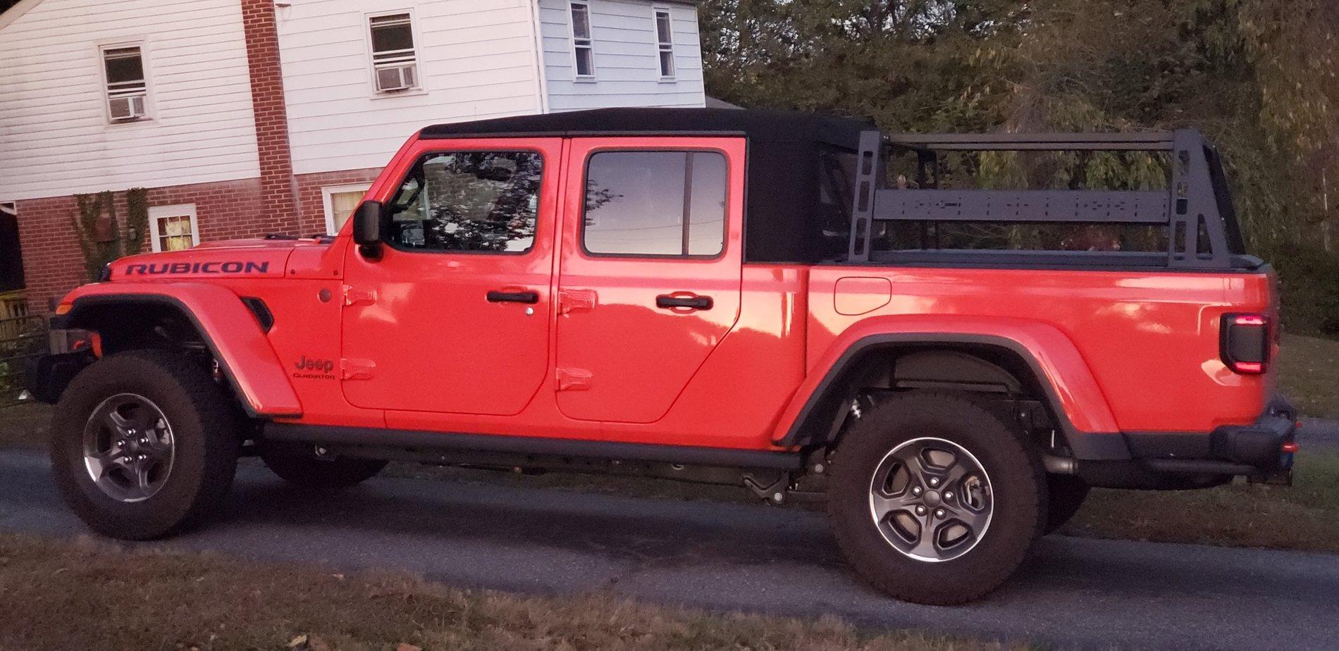

JcrOffroad
Feb 28, 2017
195
354
Portage, MI
www.jcroffroad.com
Sport S Max Tow - Firecracker Red
Am debating between these. Like that the JCR uses factory rails / seems like I could easily take on/off. Mainly for accessories - no RTT
the accessories for Leitner seems to be one of its advantages
don’t know build quality between them
other options? Thoughts?
any preferences? What’s the general sense
We've got some customers that pull their racks between trips, very quick process.

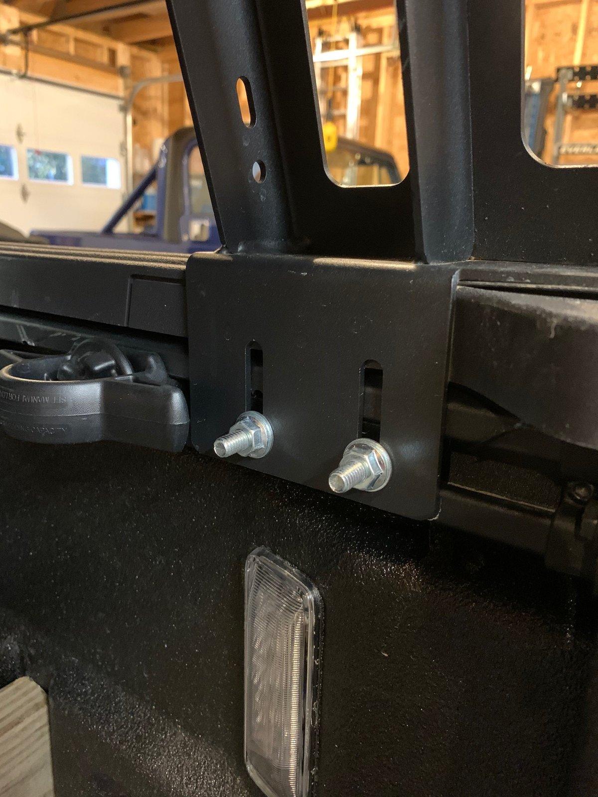

The JCR rack does not remove easily if you use the carriage bolts and plate inside the factory rails. The bolts stick out through the slots in the rack base plates. And because the slots do not go all the way down the plate, you can not lift the rack straight up. You have to loosen the legs of the rack and flex them to get them past the bolts.

I was going to make plates with threaded holes that slide into the rails and the bolts go in from the outside. Then I can remove the bolts and lift the rack straight up.
That was the reason I was looking at JCR; something I can take on and off as I need it or the bed.

Now I wish I had shot a video of me removing mine again yesterday.
I simply loosen and remove the 8 nuts from the rail bolt assemblies, push the bolts back further into the rail channel, and pull the upright bars one at a time “in and up”gently setting them back riding on the recessed bolts slightly rested on the plastic bed rub rail. Then with 2 people lift and walk back above bed. It’s seriously less than 3-4 minutes to remove.
Putting back on is slightly more hassle (a few more minutes) because you fiddle with aligning the bolts in the rails and feed through the back of the uprights. I don’t mean to be a JCR shill (but I kind of am) but this is not very complicated. Considering the utility of the system, being able to use it on demand with minimal hassle is an awesome game changer for us.

That all said, maybe the solution can be reversed with a tabbed nutsert plate in the trail rail with bolts being inserted from the “outside”, that way, no interference. I’ll throw the idea in the suggestion box.
