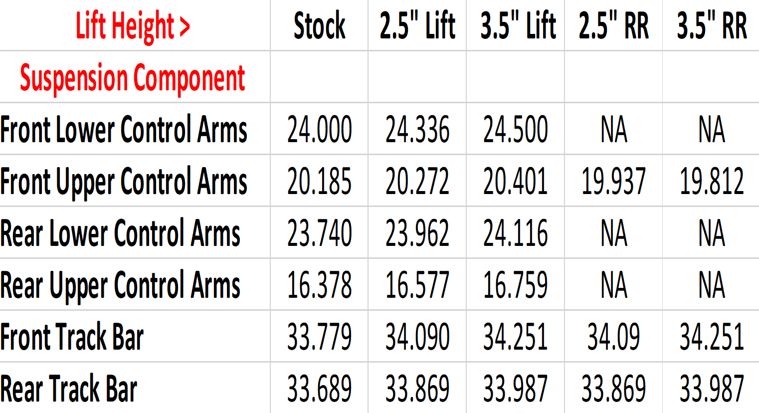

Anybody know the length of the Mopar lift LCAs eye to eye?

Thanks I appreciate it. Looking for a starting reference for my adjustables.

This is from the instructions for Clayton Offroads lift kit. It will give you baselines.
Jeep Gladiator Length of LCAs 1618065104161
