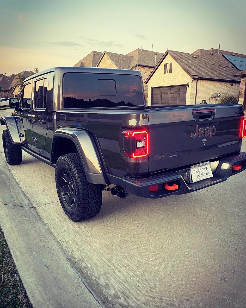

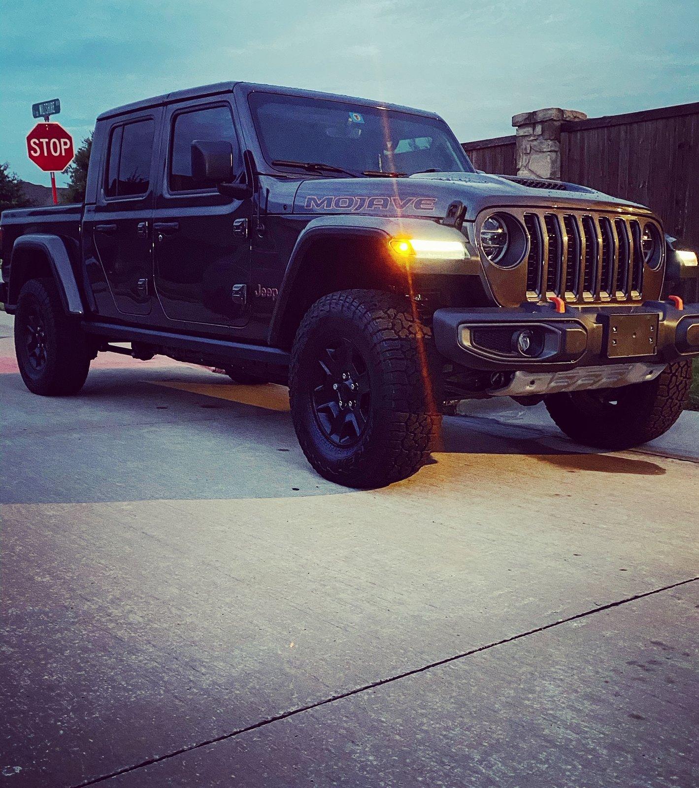

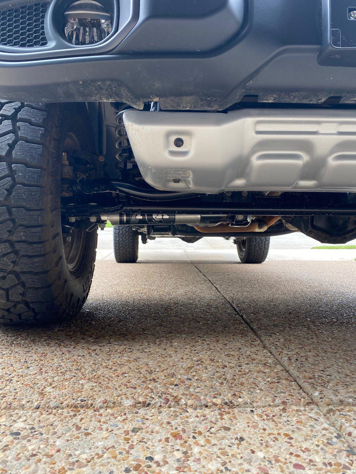

I will kick it off with a couple Mojave upgrades that i am loving so far! Follow me on insta: Texas_Mojave_Guy :fist bump: :beer:
Current Upgrades:
  • Borla Dual Atak Exhaust
  • Fox Steering Stabilizer
  • Grab Handles
On back order:
  • Metal Cloak Steering stabilizer relocation bracket
Near future:
  • Ready Lift 2.5" leveling kit (retains stock suspension)
  • 37" tires
  • Wheels Black Rhino - Armory 17x9.5
Wishful thinking:
  • Downpipe
  • Supercharger
  • Diablo superchip
  • intake
  • bumper/winch

Love the look of your Mojave! Do you have a part number for your front skid plate? Looking to upgrade my plastic one. Thanks!

Do you notice a difference with the steering stabilizer?

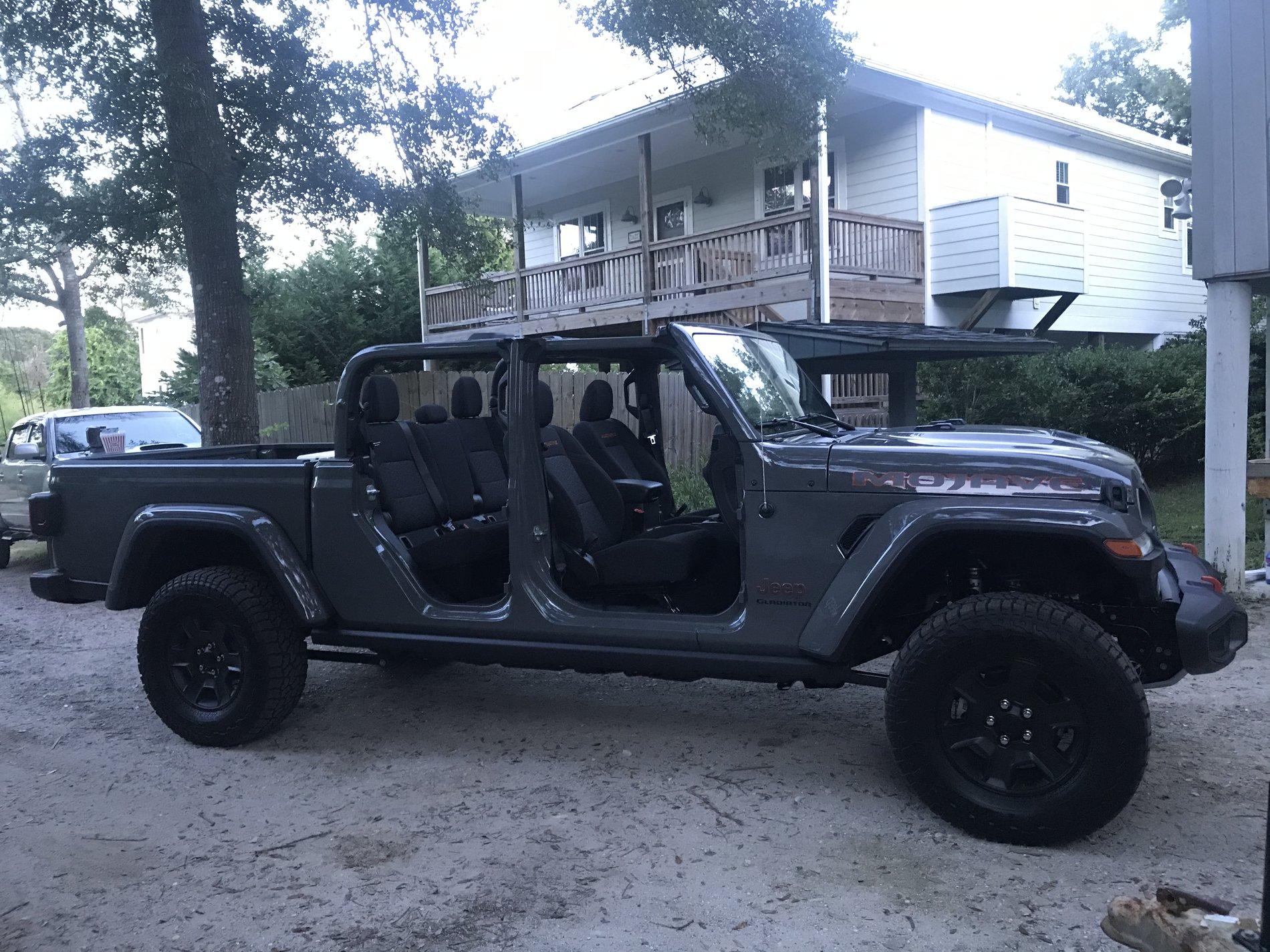

Was going to be my same question also how do you like the exhaust? And heres my mojave for good measure. No mods yet. Working with a fabrication company now on a custom bed cover/rack.

@Carrydaily @MSGEngineering Badass man, i haven't taken the doors off yet and that looks great! Yes, on the steering stabilizer @75mph+. Still not fully reconciled, but I can attest it is much better. Definitely worth the $100 mod and easy install. Love the exhaust, I was skeptical on how loud it would be for daily driving. It sounds like an F1 car when you get on it, and has minimal noise in the cabin when you are driving the jeep normal. Highly recommend the exhaust! My only discretion is that the pipes hang out the side, and could potentially be impacted from rock crawling. That's what insurance is for! :CWL:. Post a picture on the custom bed/rack when complete!

@OliverJT I have to powerwash underbody this weekend, I will see if I can find a part number, else its factory, so any dealership should be able to provide the SKU.

Thanks so much! Ya I asked a local dealer and they said it’s so new it’s not in the system.... hard to believe that!

Is that the Fox IFS or TS stabilizer? I'm trying to choose between the two.
Also, have you researched the relocation brackets to make sure they are compatible with the Mojave? From what it looks like, the TS might not need it? I've seen relocation brackets from Metal Cloak, Synergy and Clayton Off Road...

It’s the TS, and there hasn’t been much detail provided on compatibility. The TS sits just like stock and slightly vulnerable to any rock climbing. Metalcloak is relatively an easier install given that it uses prefabbed factory holes. I will end up selling it in the marketplace if it isn’t compatible. Haven’t received it yet though.

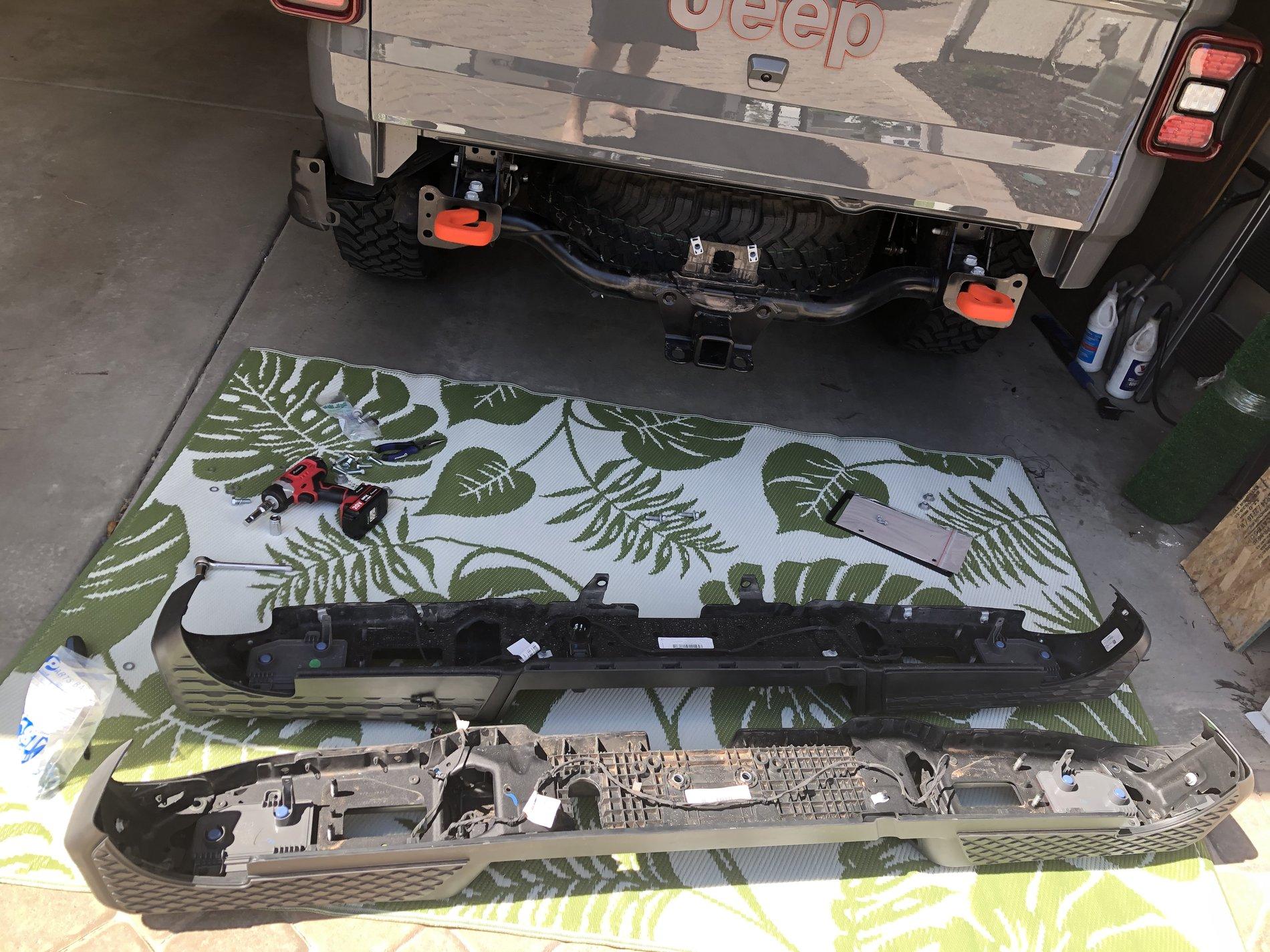

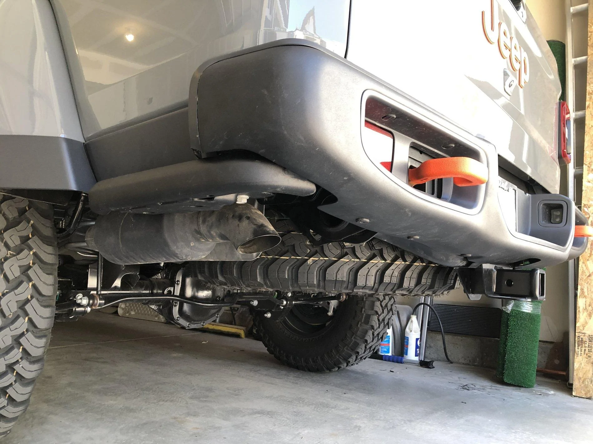

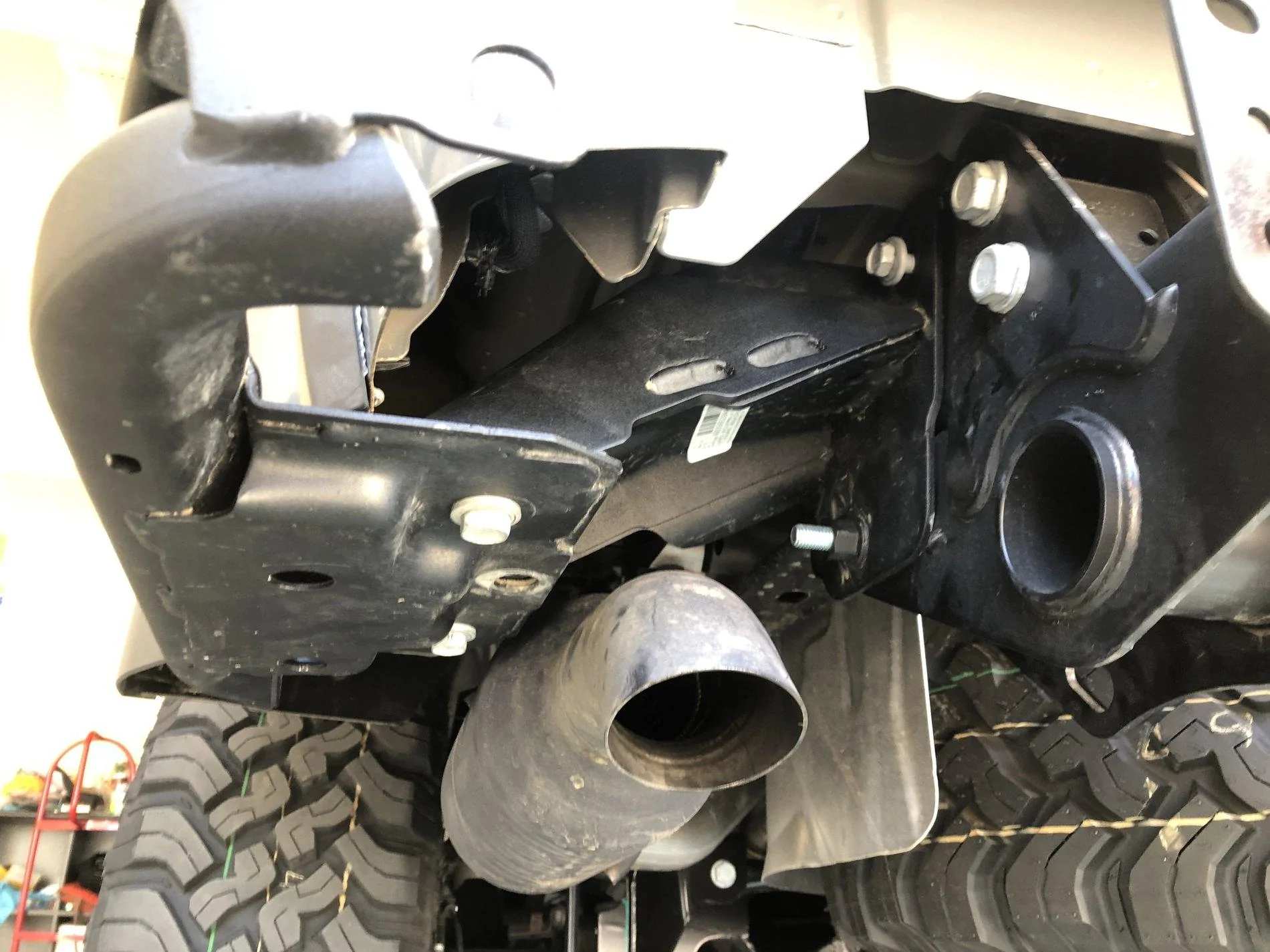

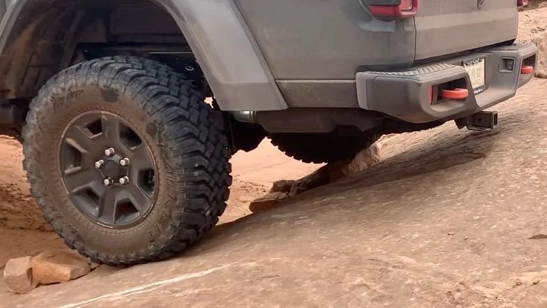

In the middle of having a blast, blasting over the desert, I confirmed my suspicions about departure angle.
Spent half an hour finding and stacking rocks to get through this wash. I had already started stacking in this picture. After I got a decent pile, I had my wife pull on top of them, then I would move the back ones to the front and continue till I got out without tearing up my hitch.

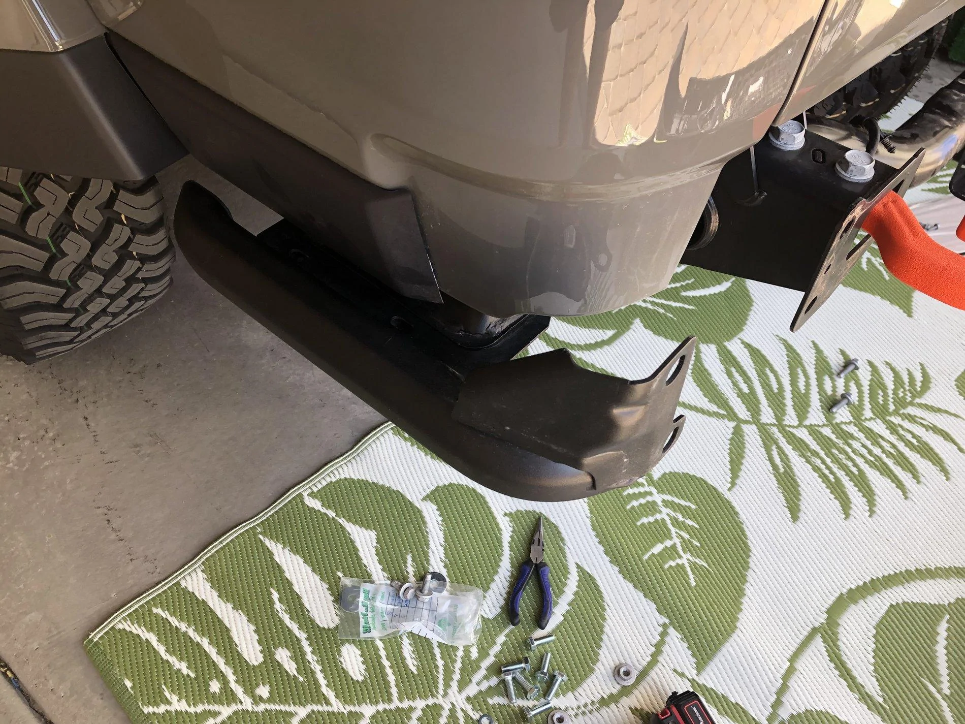

That lead me to look for some rear end protection. Picked up a Rubi takeoff bumper and installed it today.
I like that the side bits and the steel part of the bumper all tie together to make a solid mass. I also ordered a hitch skid that should protect that and become a good point to drag if needed in the future.
Oh, and for the record, DO NOT DO NOT WHAT I DID IN THE PICTURES.
Install the side brackets first. Get all those bolts in but leave them just loose enough that you can slide the bracket up and down. Then install the bumper and tighten it in place. Then install the side skids. I pushed the side brackets as high as they would go and tightened, then tightened the bumper end to skid tie-in bolts, then the bolts from the side skids to the brackets.

From MetalCloak:
Thank you for asking In order to move the stabilizer up the truck would need to be lifted with some additional bump stop in order to allow it to clear the frame. If you decide to go that route the JK application with 1 5/8” tie rod works best.
