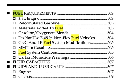

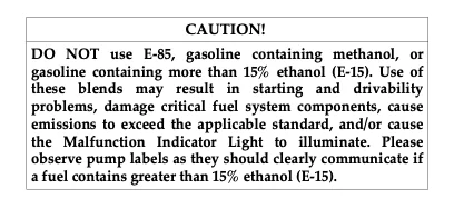

Here is the info form the Owner's manual. Seems like a pretty solid NO

So that mentions not greater than E-15, however the fuel I'm seeing available is E-15. Wording seems somewhat ambiguous. :movember:

It does appear that the manual allows for the use of E15, but nothing with greater concentration of ethanol, or any fuel with methanol.

Thanks for reaching out to us, arosen1997. Regarding what fuel is appropriate to use in your JT, I found this in the 2020 owners manual:
"DO NOT use E-85, gasoline containing
methanol, or gasoline containing more than
15% ethanol (E-15). Use of these blends may
result in starting and drivability problems,
damage critical fuel system components,
cause emissions to exceed the applicable
standard, and/or cause the Malfunction
Indicator Light to illuminate. Please observe
pump labels as they should clearly
communicate if a fuel contains greater than
15% ethanol (E-15)."
Hopefully this clarifies that E-15 is not recommended as a selected fuel. If you would like more information on this subject, you can find it here: https://msmownerassets.z13.web.core...Gladiator/P111104_20_JT_OM_EN_USC_DIGITAL.pdf

Perhaps my reading comprehension is lacking since I went to public schoolā€¦.buuuuttttā€¦..
it says to not use fuel GREATER than 15%.
correct me if Iā€™m wrong, but this implies you CAN use E-15.
