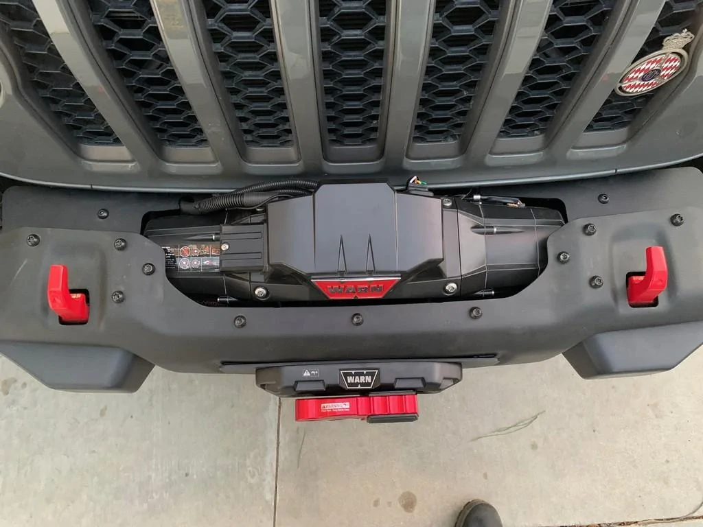

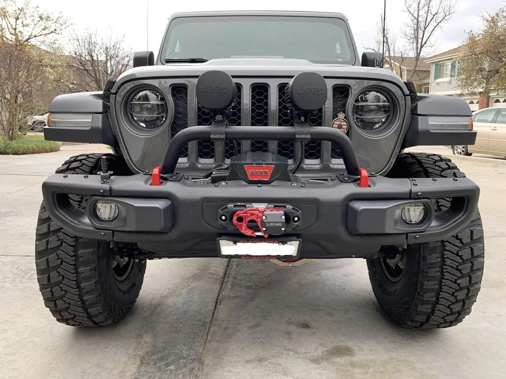

I have the warn zeon platinum 10s. I like the remote free spool and lock up and the extra speed of the Platinum. I also like that my ultrahook cannot be stolen since there is no free-spool release lever. However, the remote battery life is not good.
I also like the filler plates from Maximus-3 for all the Warn Zeons and the OEM bumper. They hide everything and give a little more protection to the winch.
Two ways to steal it with no free spool lever. Fastest way would be just razor blade your synthetic line at the Factor 55 pin, where the synthetic line is exposed.
I thought like you initially, but figured if someone wants it I don't want to replace both synthetic line and Factor 55 flatlink.
Plus if your out wheeling and your remote runs out of battery or gets damaged you have no more winch.
The regular Zeon you can use the wired remote if the wireless stops working.

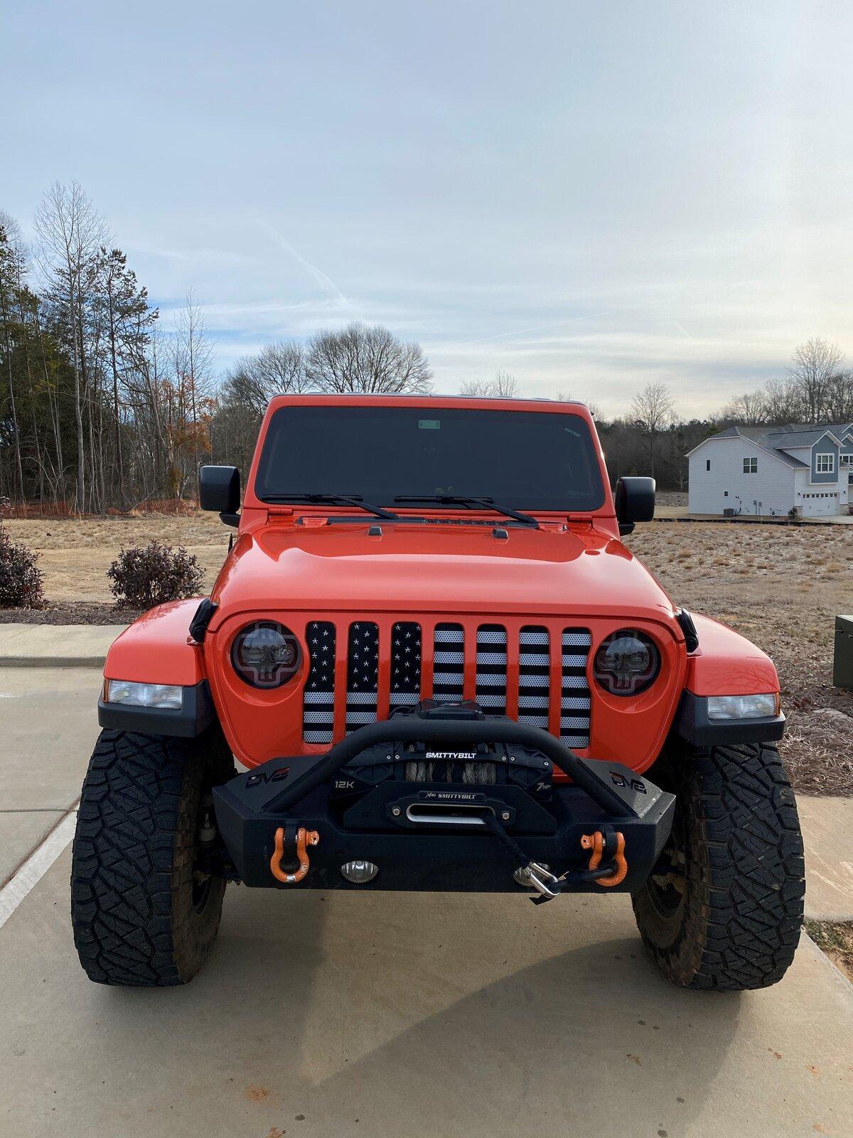

for the little cost difference from a 9.5k to 12k load, I did Smittybilt comp series with synthetic. Took under an hour to install. $700 from 4WP, if your in Charlotte,NC go to Keffer Jeep and see Norman the parts manager, I got mine for $600.
