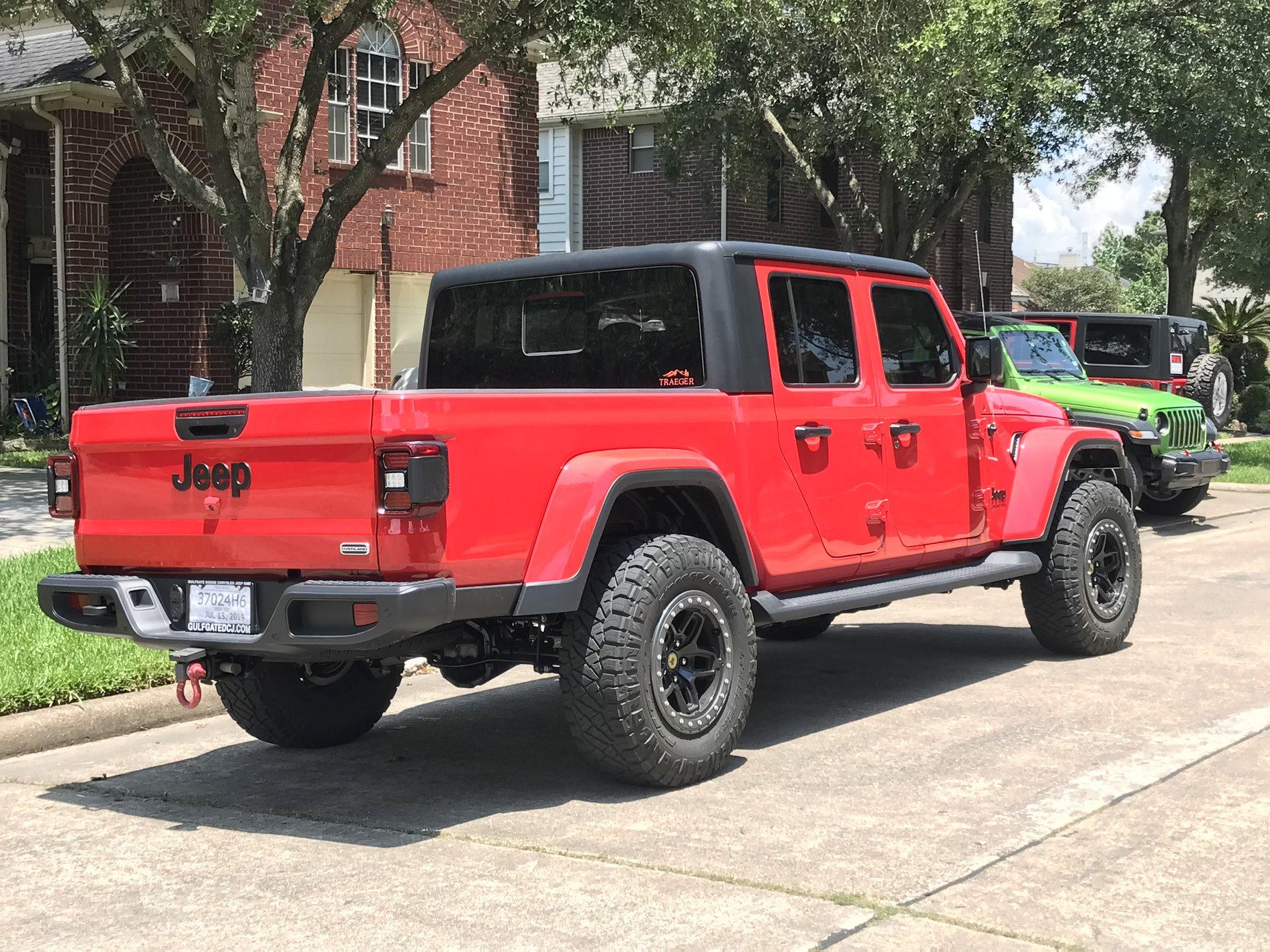

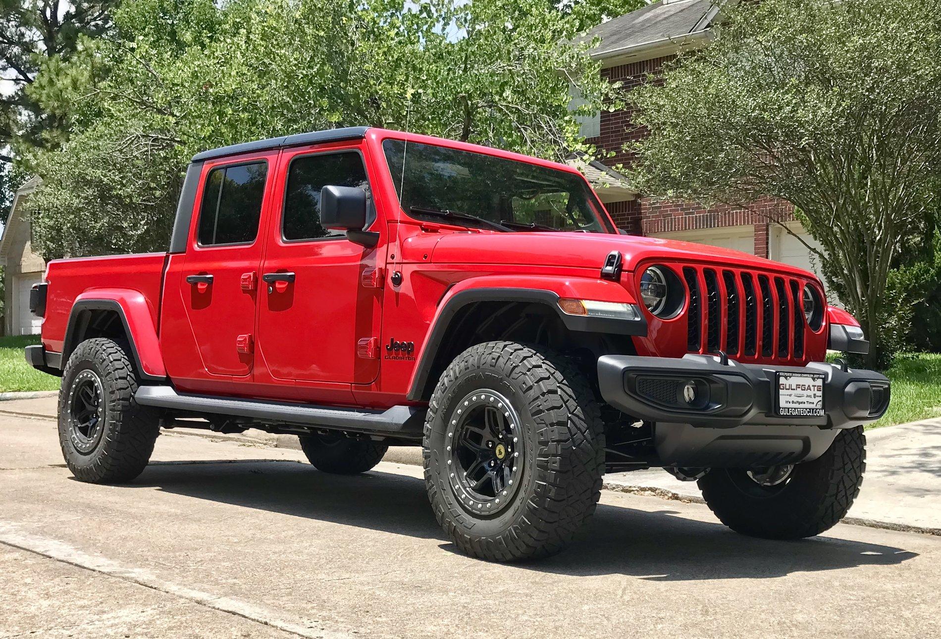

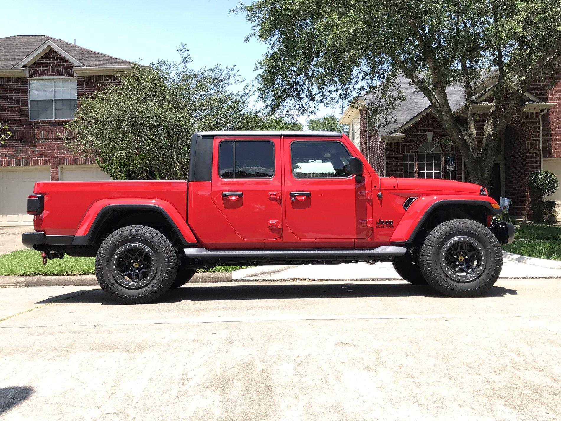

Ok i cannot stand a front end rake i know it serves a purpose but i don’t care , anyway i ordered the Alloy USA 1 1/2” front level kit it is very simple two 2” polyurethane like spacers & front shock extensions. It’s 2” because you remove your upper 1/2” spring pad & replace it with the spacers. Easy peasy. It sets exactly level.

That looks really good.Ive been looking at that Alloy kit and now I I think I will get one as well.

Perfect stance. Love your Gladiator. Hope that JK in the background finds a nice home.
Notice any difference in how it drives after the install and did you have to get an alignment done?

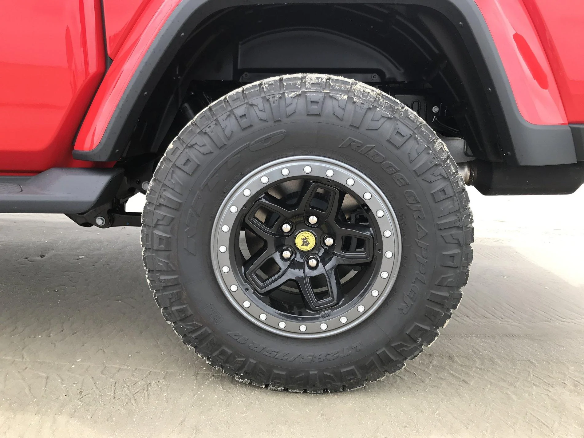

You have the 275/75/17 tires. No lift. Correct? I just ordered some for my sport s. With 17x9 wheels
no change in ride very good ride no alignment needed perfectly straight wheels

285/75R17 on 17 by 8.5” AEV Borah’s
