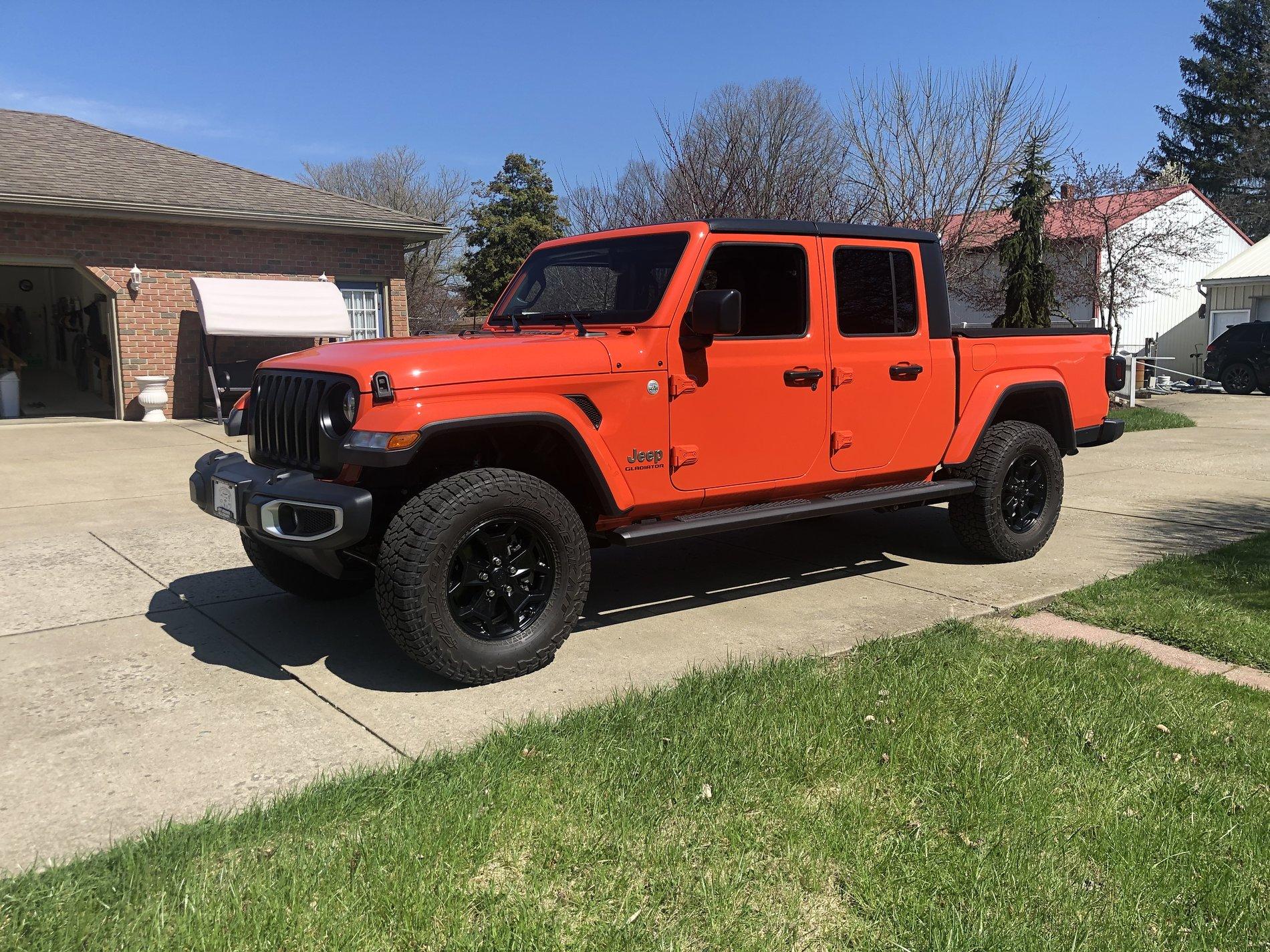

On my Sport S (with JL Rubi wheels/tires), a 1.5” was all I would want. A 2.5” would be nose high for sure.

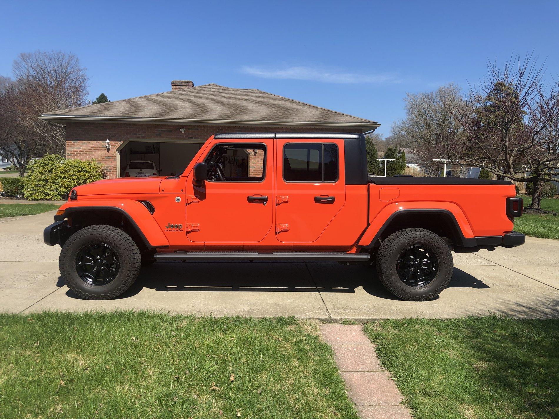

I did the Rough Country 2.5” leveling kit but for me it didn’t look right. I never really liked it (just my opinion). I’ve now installed a 1-1/2” leveling kit in the back and it looks almost perfectly aligned. So I would say the 1-1/2” front will get you as level as she will sit. I can’t believe this but I don’t have a side on view photo... this is the best I have that shows the alignment.

please tell me everything you installed for lift. thanks so much. yours looks amazing and i too have the sport s.
Thanks! I installed the USA Alloy 1.5” front lift. The back is not changed. The wheels and tires are off a JL Wrangler Rubicon.
