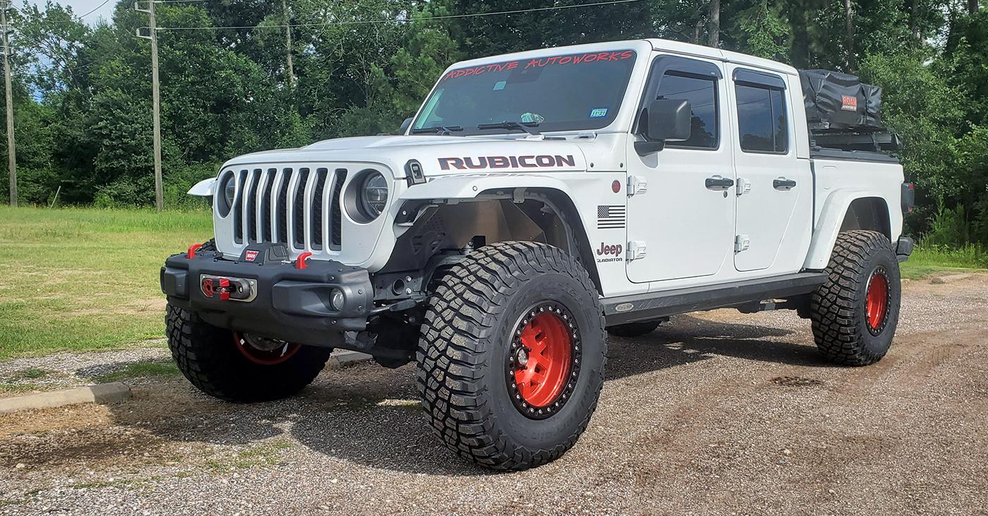

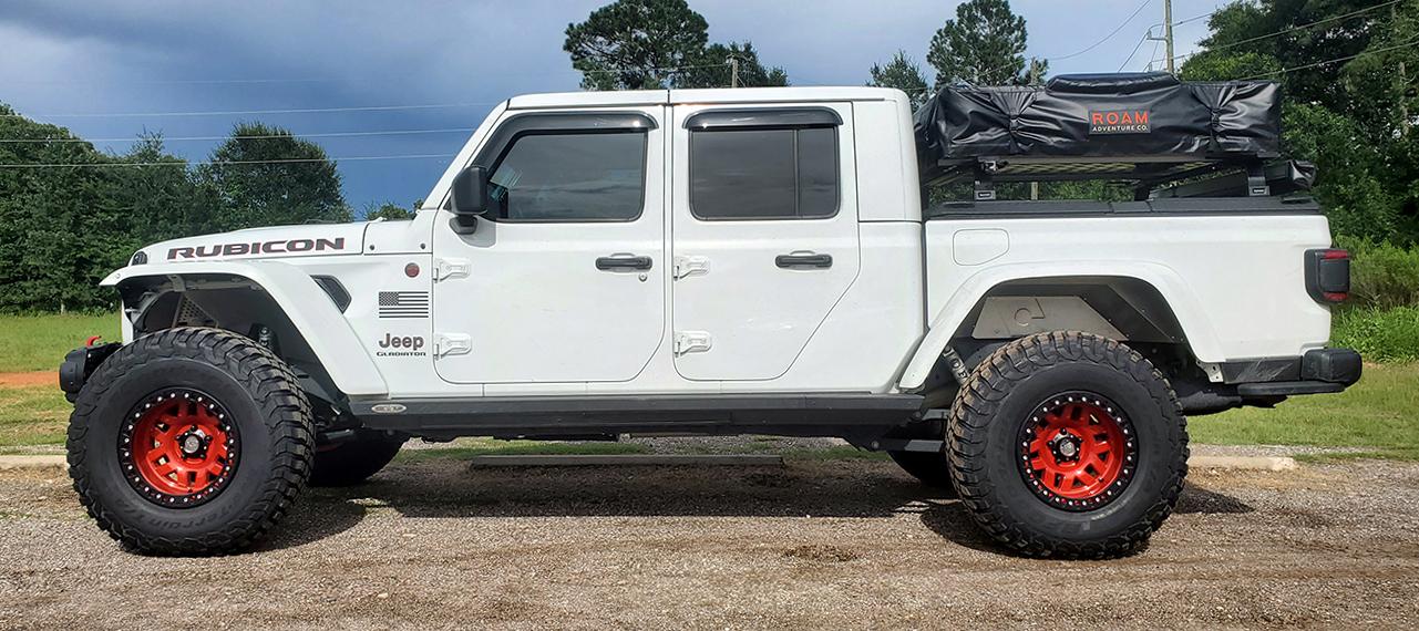

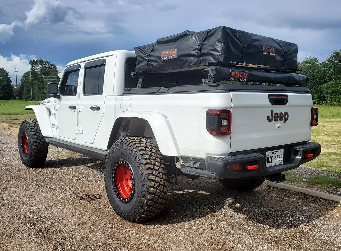

I think I've finally done enough to this thing to deserve a build thread... haha!
The thought process behind this thing is for it to be just an all-arounder. Little bit of overlander, little bit of serious wheeler and a lot of being a base camp for mountain-biking, kayaking, etc, etc.......
This is how it sat when I brought it home. The story I'm told is that the body shop manager traded it in on a diesel gladiator when they hit the lots. Got it in late 2020 with only ~4,600 miles on the clock.
Existing mod list:
Mopar 2" Lift
37x12.50-17 Falken Wildpeak A/Ts
Rock Slide Engineering Step Sliders
Diamondback SE Tonneau Cover
Jeep Gladiator Levi's JTR 'Do-Everything' Build 20201201_170805
I've mad a few changes to it since then.
Current mod list:
Mopar 2" Lift
Custom Powdercoated KMC Machete Beadlocks
37x12.50-17 BFGoodrich Mud-Terrain KM3s
Front Runner Outfitters Rack System for Diamondback
Roam Vagabond Roof Top Tent
Roam Roof Top Awning
Artec Winch Plate for Factory Steel Bumper
Warn VR EVO 10-S Winch
Factor 55 Flat Link
Factor 55 Fairlead
Artec Fender Chop Kit
Artec Front/Rear Fender Liners
Z-Automotive Tazer Mini
Voswitch JL200
SpiderWebShade
Oznium LED Bolts (to replace the lights I lost doing the fender chop)
Random parts and pieces to mount MTBs to the rack
Jeep Gladiator Levi's JTR 'Do-Everything' Build 20210714_172323
Jeep Gladiator Levi's JTR 'Do-Everything' Build 20210714_172341
Jeep Gladiator Levi's JTR 'Do-Everything' Build 20210714_172351
Jeep Gladiator Levi's JTR 'Do-Everything' Build 20210714_172409
I'd never say it's done... because it never will be. I will say that it's done for this phase of it's life... mostly... gonna be doing onboard air and some lighting in the very near future! HAHA!

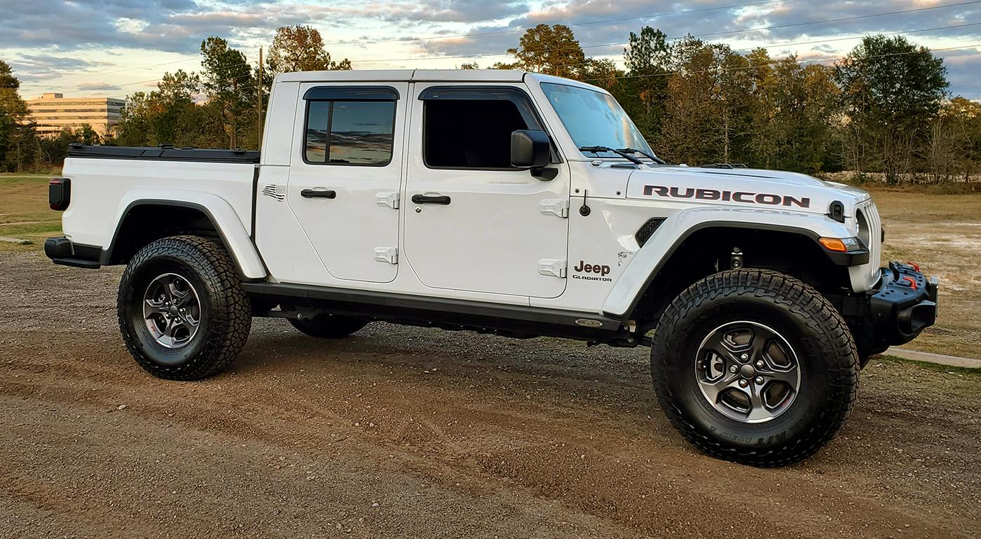

Added some pillar mounted KC Flex Era 4s with red bezels.
Jeep Gladiator Levi's JTR 'Do-Everything' Build 20210919_135951_resized
Jeep Gladiator Levi's JTR 'Do-Everything' Build 20210919_135957_resized
I've got to say, these things are WAY brighter than the 50" lightbar + pillar lights I had on my JKU. Which makes me super happy, I did not want to end up with lights all over the front of this thing. These things are more than enough extra light.

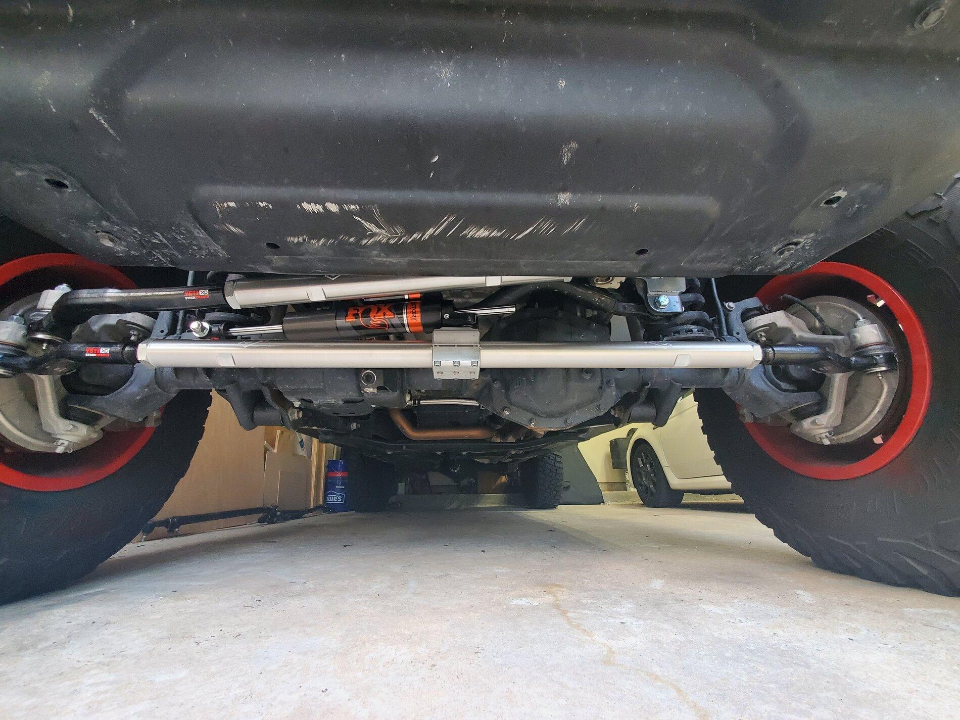

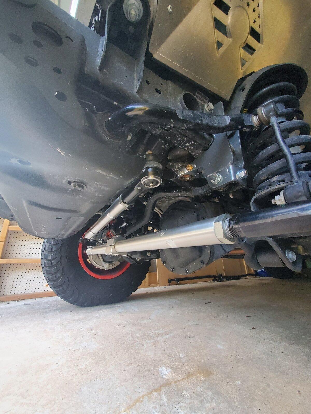

I got the Artec Steering, Synergy Track Bar/Sector Shaft Brace and the Fox ATS Steering Stabilizer installed before a road trip.
I can not express how incredible this stuff is. The steering is so dialed now and I can't imagine the level of damage it would take to destroy it.

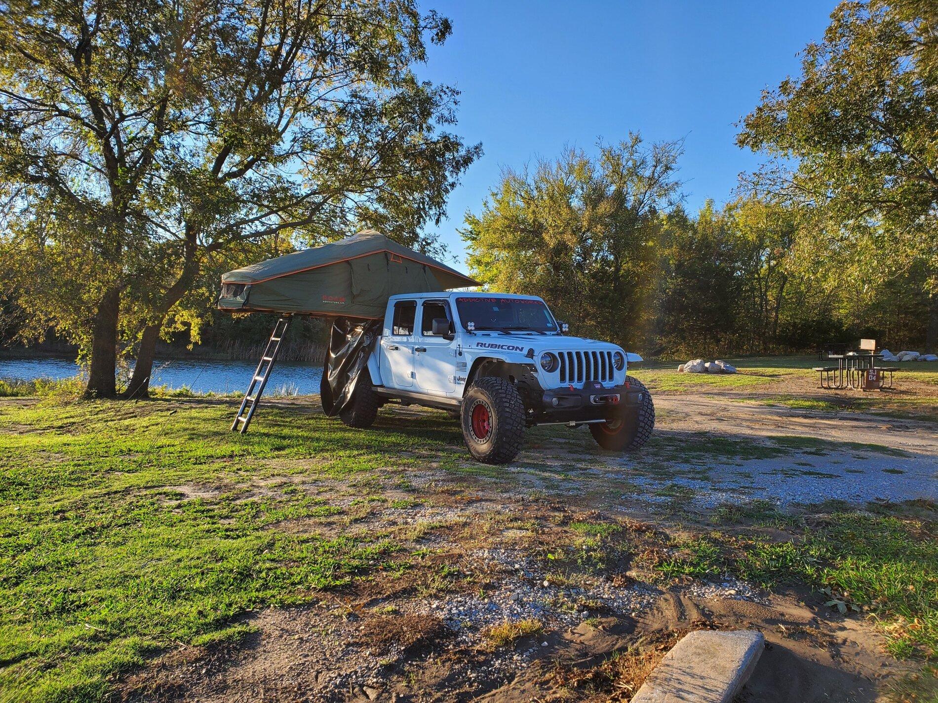

Bonus picture... spent a couple of nights in the Lake Murray State Park in Oklahoma. First night was incredibly stormy and the ROAM RTT did amazing. After it was confirmed that I wasn't going to wake up to a leaky tent, I slept like a baby!

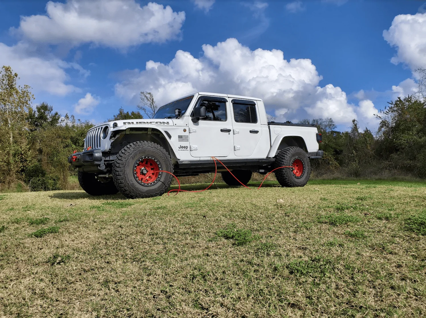

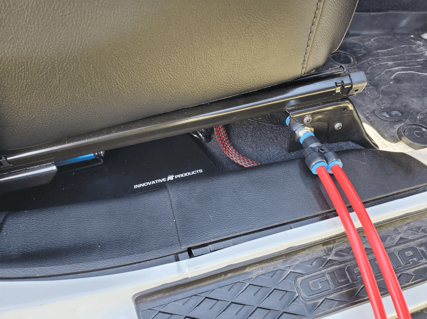

Finally figured out what onboard air system I wanted to go with and got it installed. Super impressed.
Went with the Innovative AT Products system for the dual ARB compressor.
https://innovativeatproducts.com/sh...ith-arb-twin-compressor-ckmta12-package-deal/
Hook up to all 4 tires. Get back into the driver's seat. Crack the valve under the seat. Relax in the AC while you watch the TPMS on the dash. Once they reach your desired target, close the valve. Go wrangle your hose back up and get after it! Same story for airing up!

10/10 would recommend!

That looks awesome. Question though; did you wire the ARB unit to your VOSwitch? I believe that switch panel is 30A per circuit. How did you wire the ARB compressor which can draw up to 50A I think?
David
Thanks, brother!
The switch panel is just tied into the trigger wire for the compressor. The actual power wires are tied directly to the battery.

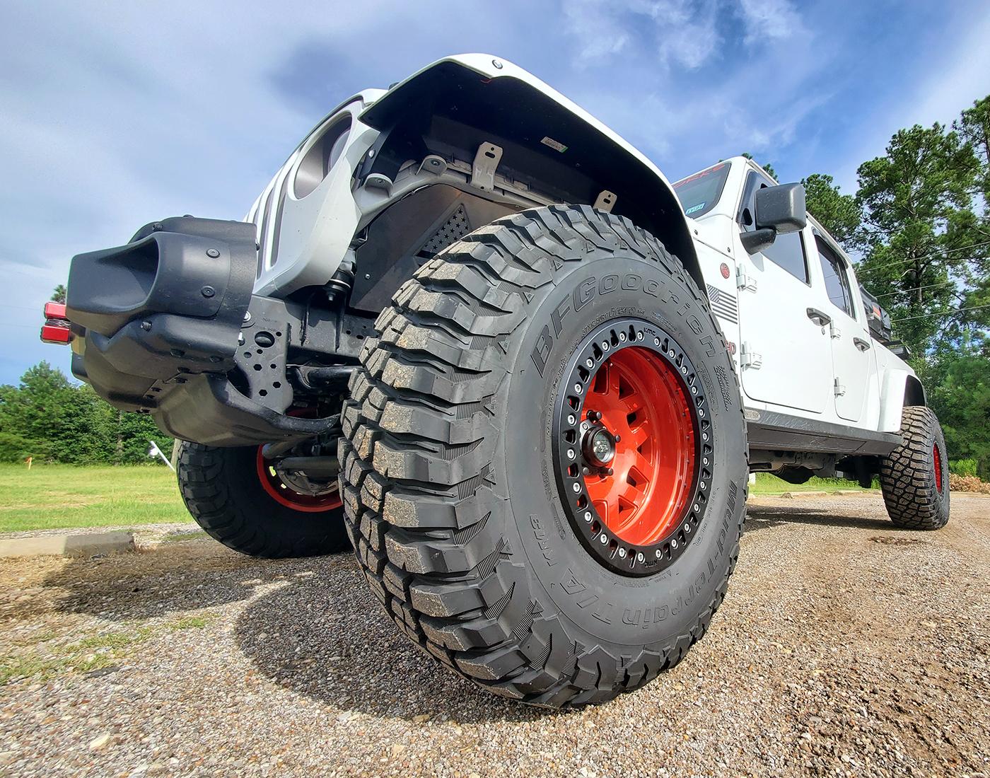

Am i tripping or do i see some camber in the front wheels ?
also sweet build man diggin the look of your truck dude :D
Thanks brother! We're really enjoying it. Still plenty more to come too!
I've noticed that in pictures too! It's got to be some distortion in the lens or something... because I've definitely gone and verified on more than one occasion after seeing it! HAHA!
