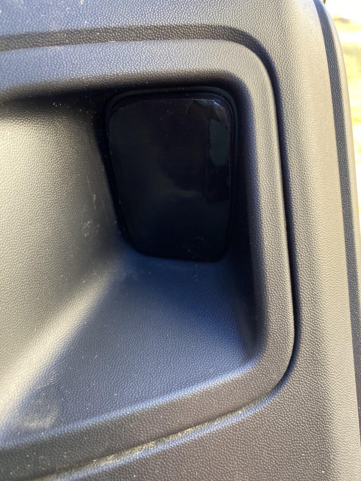

Tint license plate lights with LAMIN-X 148-C laminate film to cut the glare in the back up camera.
The smallest sheet you can buy from LAMIN-X is 4"x8" and cost $10. I used less than 2", want to keep 2" more in case I need to redo, and will sell the remaining 4"x4" (enough to do it 2x) for $5.

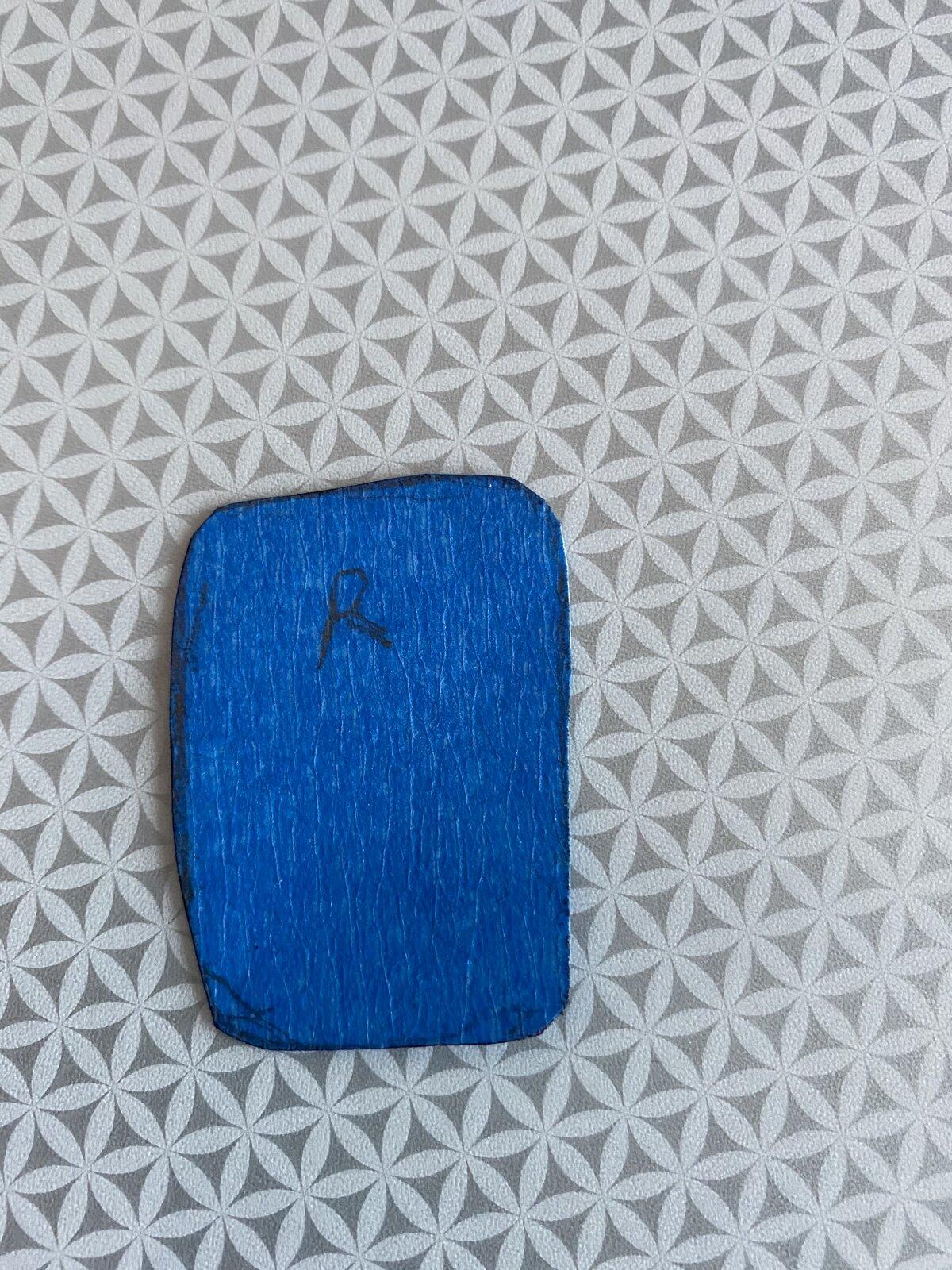

Install is easy. Place masking tape over the light. Trace the outline. Adhere masking tape to a magazine cover. Cut out shape. Trial fit and adjust if necessary. Transfer shape to laminate. Verify fit, cut and stick on.
