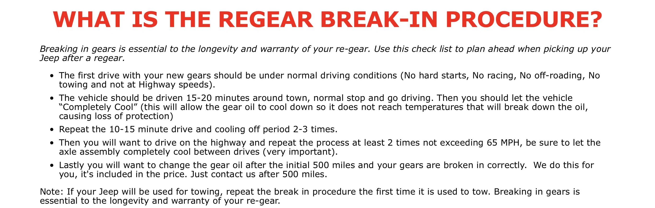

I’d say do your 15 minute break in drives in New Braunfels and then cruise home at 65 mph. They’ll do the first 35 mph drive for you so you only need two more at 35 and two at 65. I hung out at Buccees while I let my Jeep cool down in between drives.

Man the difference between your 4.10‘s and the new 5.13’s will blow your mind. So awesome having 7th & 8th gear back. The initial break in trips you have to do are a bit of a pain.
Be careful when you pull out of their shop onto the I35 access road when you leave. I got a lot of horns honked and a couple of middle fingers for cruising at 35 mph…people are fun.
What was the break in procedure you are following?

The guidelines that Exodus 4x4 gave me are straight from Revolution Gear's website and have to be followed for warranty work. How they would know I actually followed their break-in guidelines, I don't know, but I did anyway.
Had the 500 mile check up done, fluids changed, and now I'm driving it like I stole it. That MPG increase I got with them at first has definitely disappeared now that I can drive over 65!

I did take it out last night after I got the oil in and put back together (not programmed until today when I get off) did a no no and got up to 70 hit 7th turned around and slow cruised back to the shop just listening for any odd noise or howling. Very impressed with how quick the shifts were to 6th wasn’t expecting it to get up that much faster. It’ll get a good break in tonight and hopefully be ready for the Beach cleanup on South Padre this weekend.
