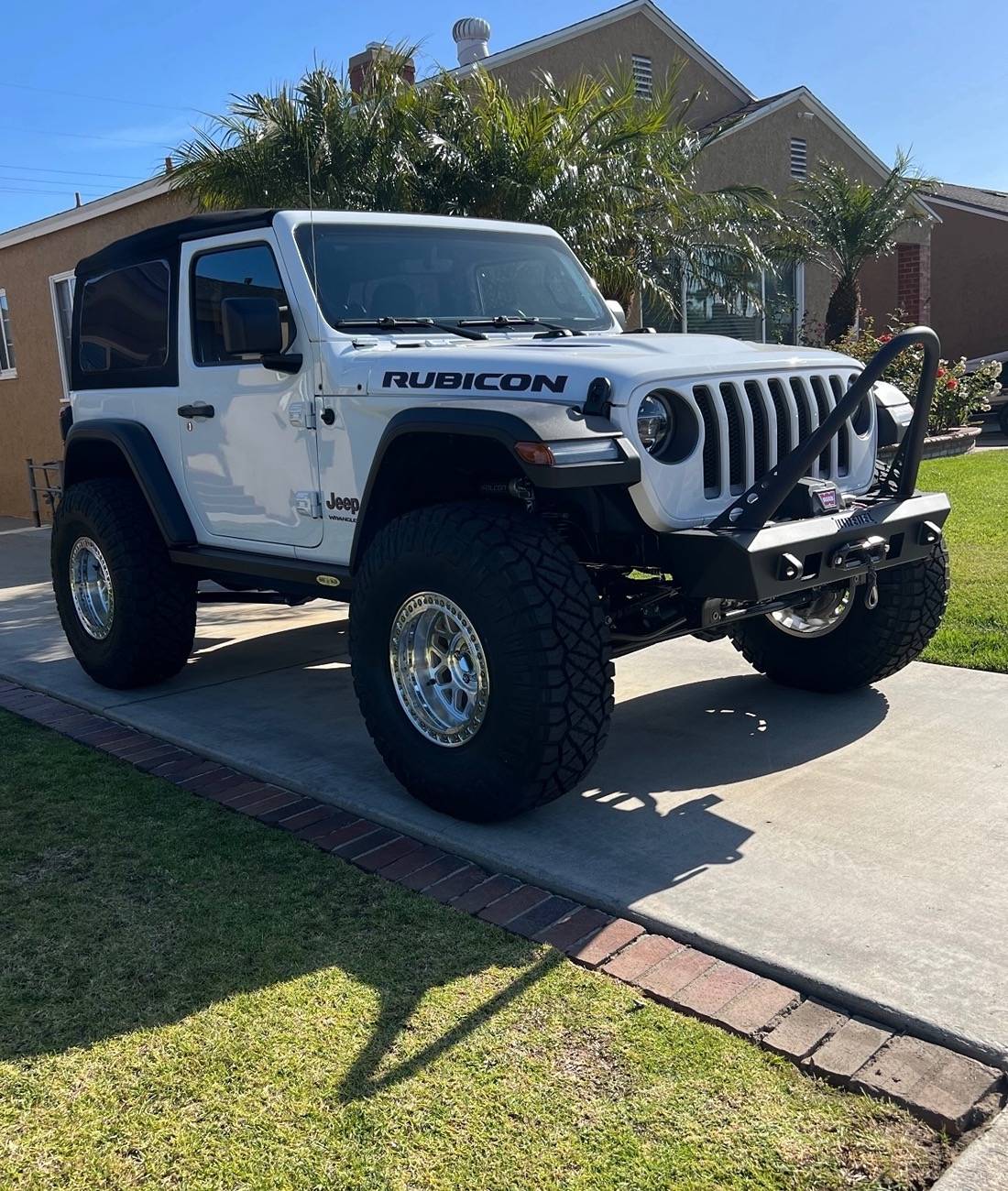

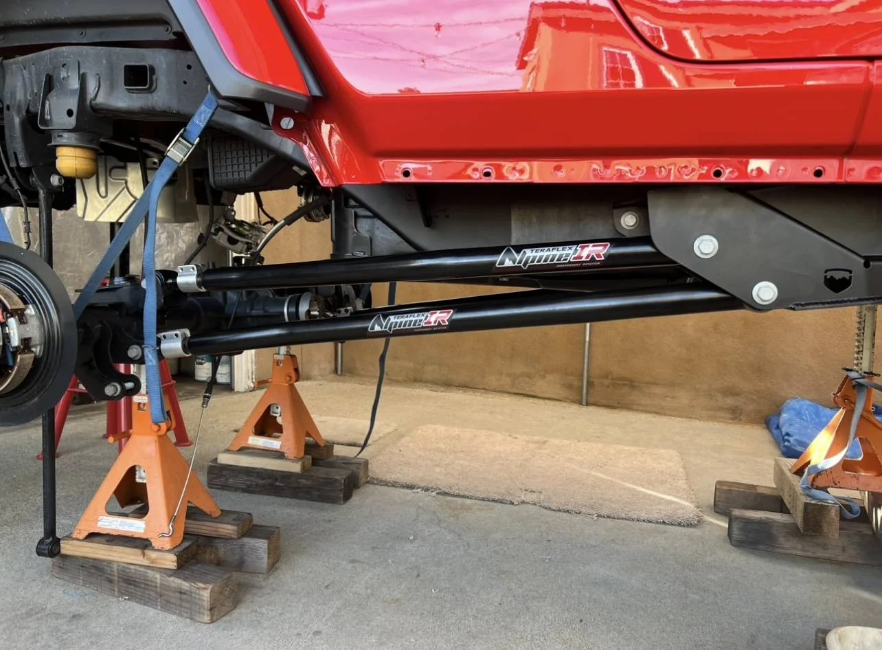

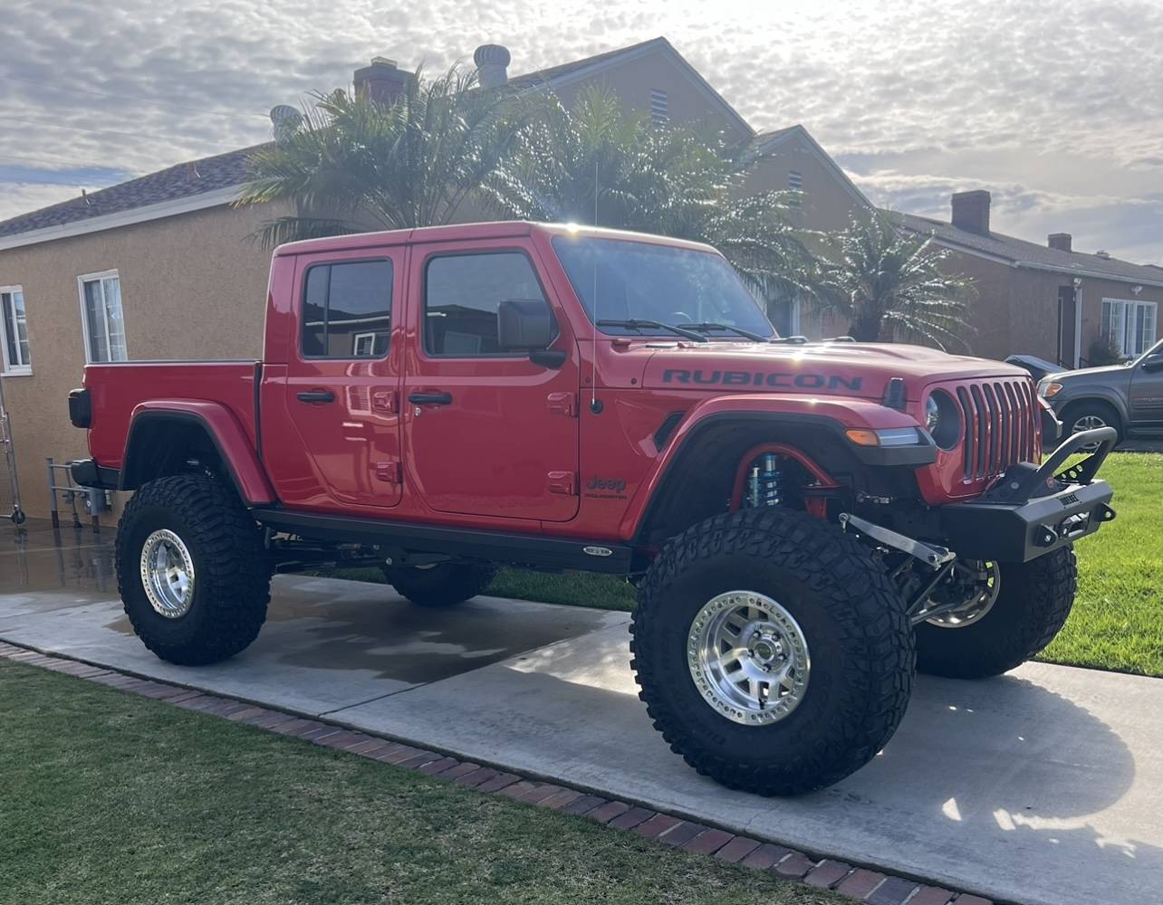

I really like Teraflex. I have TeraFlex long arm lifts on both of our jeeps right now. I have been using them for many years. I have tried three different brands in the last 15 years. Their customer service employees have been absolutely great to us.
