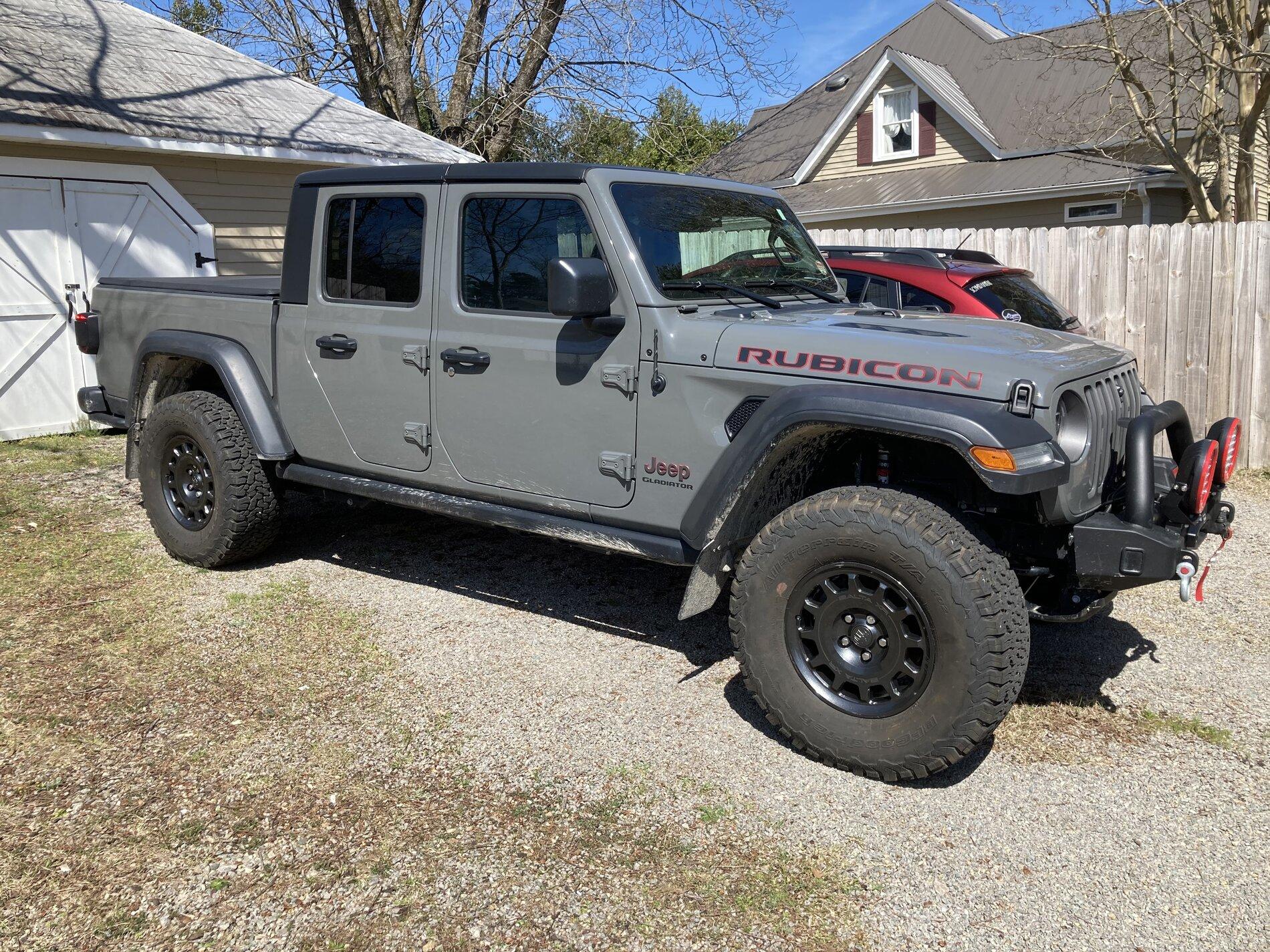

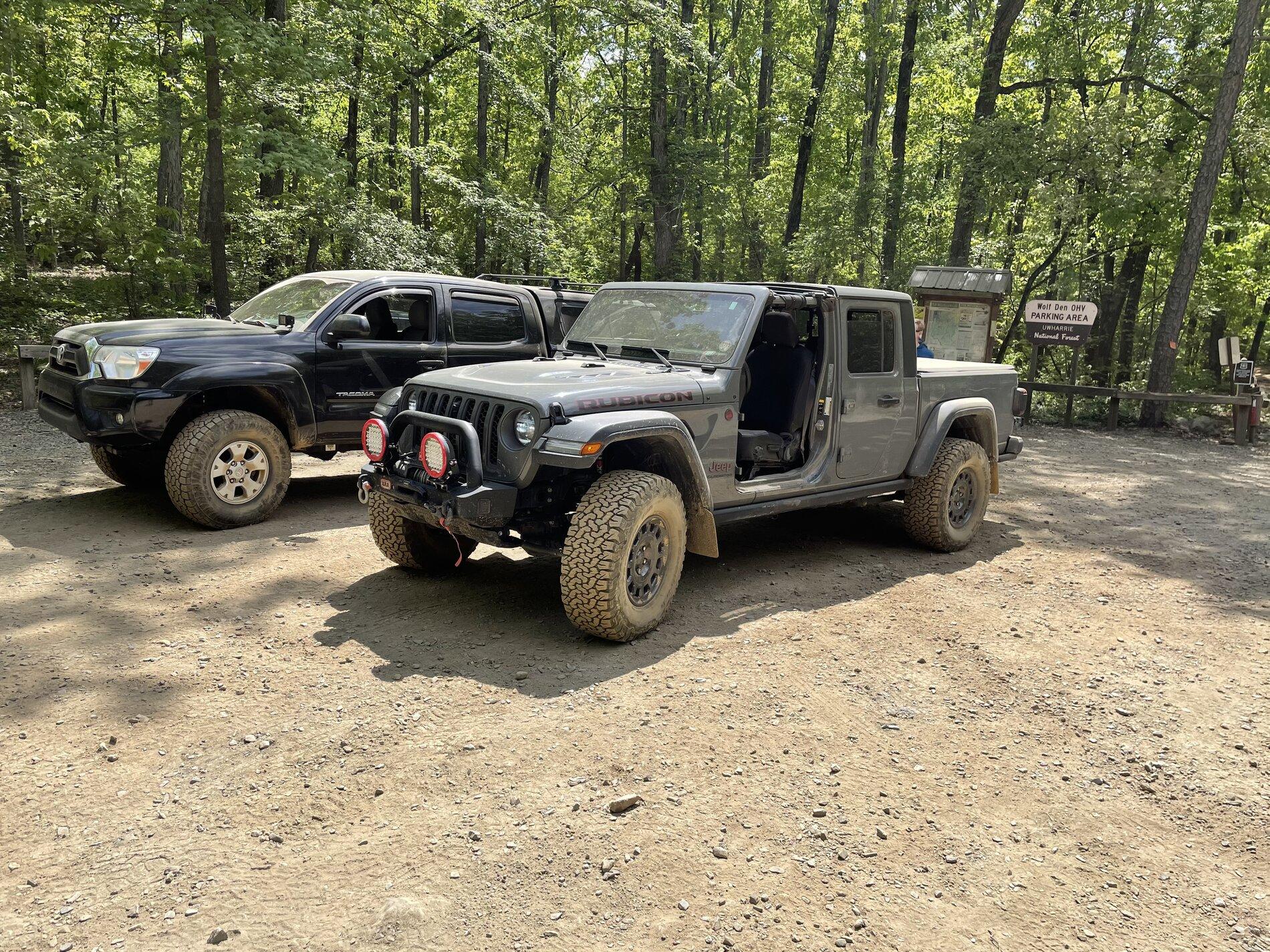

If you are looking to just clear 35s now and 37s down the road and not super worried about the payload, yeah the mopar wouldn’t be a bad option. The mopar kit and some rubicon fenders when you step up to 37s would fit the bill then.
Im running the teraflex spacer and the mopar lift control arms up front on mine and the 3/4” spacer in the rear. I don’t have any shock extensions either. That was a fairly inexpensive way to get some height while maintaining the factory ride, at least I think it rides well. I’m using the bfg ko2 in 315/70s also.

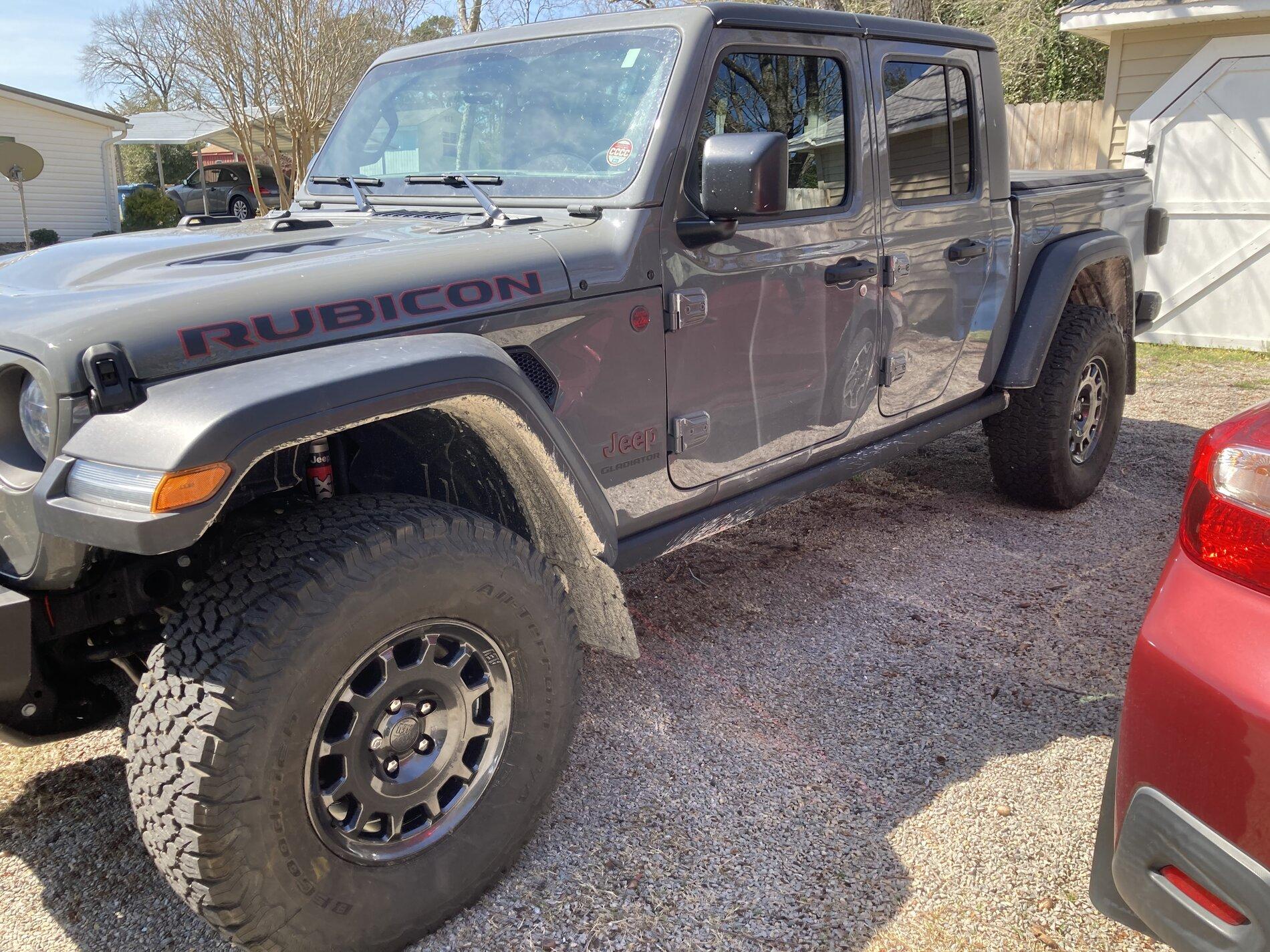

I got a 2.5" Readylift SST spacer lift and Rubicon take off front springs and I'm clearing 37's no problem. Mine is a Max Tow. I was tempted to put 39 12.5 17's on which would of cleared as well but I was concerned about the 90lb weight of the tires. A 2.5" lift is all you need to clear 37's and have room. The Rubicon take offs and 2.5 spacer lift gave me Over 3.5" of lift.
No regear and averaging over 17mpgs. Haven't towed anything yet but it doesn't feel like it's got any less power than when I had it on 35's.

Looks awesome. I wonder how much (if any) benefit in ride and flex the longer springs would be over the spacers.

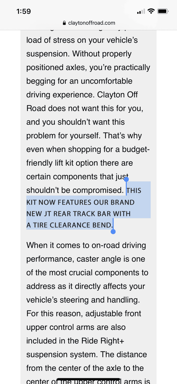

Actually, all their new lift do come with the curved rear track bar, both the ride right and their complete kits do.
The product page images show otherwise & the descriptions don't mention it either. Maybe @Clayton Off Road can clarify.
It actually does state that it comes with it. If you read beyond the photos in the description portion, it states in all caps that the kits come with the high clearance rear track bar.
I stand corrected. I was looking at the product features & its not mentioned on any of them. It makes sense for them to not keep producing 2 competing products.
