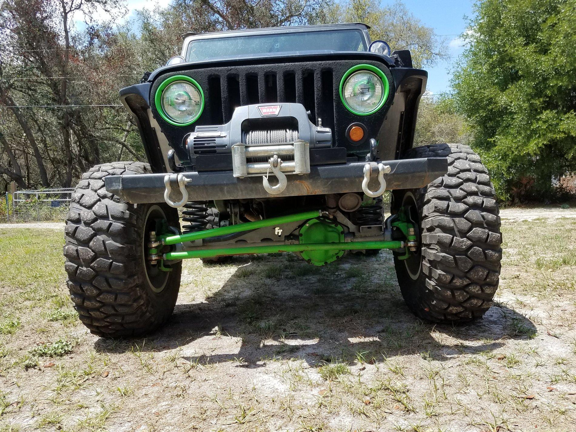

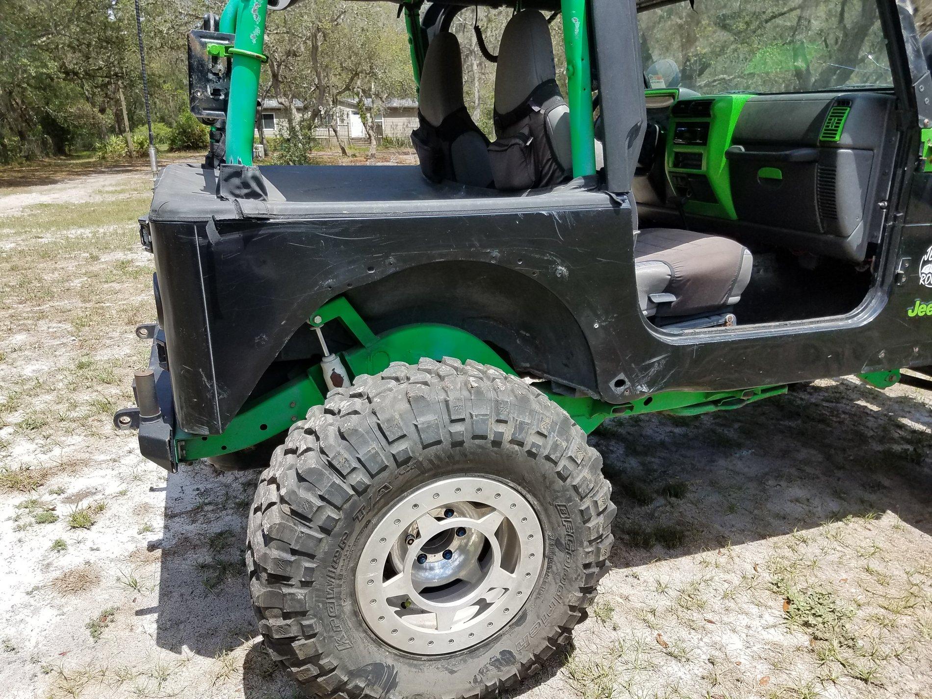

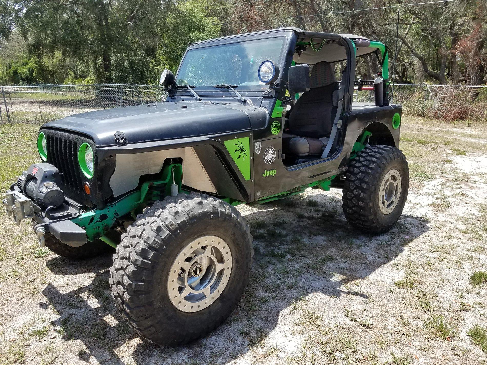

I sold it a couple years ago. It was a combination of not getting out with it and some personal reasons. I built it up from a pile of parts I bought from a guys back yard.

Gorgeous build, man. Looks ultra capable yet still has a little flash. I'll never forget riding around in my brother-in-law's TJ as a kid. I blame those moments for my adult obsession and empty wallet!
